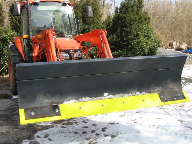

here is a picture of the polypropelene board attached to the snow plow to avoid scraping the pavement
   / SnowPlow test #1 #27
Skunkwerx
How thick of a piece did you go with? How did you cut the material? (with a circular saw???)
   / SnowPlow test #1 #29
bx24 said:
Skunkwerx
What works for me is sandwiching it between 2 scrap pieces of thin plywood , paneling or osb and sawing through the wood and material with a jig saw.
O saw should work 2.
