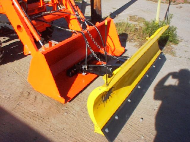

Has anyone mounted a snowplow from a pickup truck onto the loader bucket?I was thinking of mounting the receiver plate ( the part that the plow attatches to on the pickup) onto the back inside of the bucket and use the lift chain attatched to the top of the bucket to support the plow. Does this sound like it would work? Any thoughts, comments or ideas welcomed.

With a little yankee ingenuity you shouldn't have any problem. I ran a 7' plow on my FEL all winter. It worked great. I hooked my cutting edge just under the plow ears and up against a piece of angle iron that was already there, locked it all in to place with a strong chain and a chain binder.
This was merely a temporary setup to see if it would work. For next winter I will securely it properly. It was only manual angle and will probably stay that way, but I don't mind.
There are several members on this board that have set up plows in a similar fashion as you would like to do. Attached is a photo of a New Fisher plow installed in a Kubota bucket. This is how my local NH dealer sets them up for people and it is the way I will make mine for this next winter. He sells the bolt in bracket for $150 and I will do the instillation myself adding some reinforcing to the back of the bucket.
Two pins, the lift chain and hydrolics if you have them and the plow will install and remove just like would on a truck.

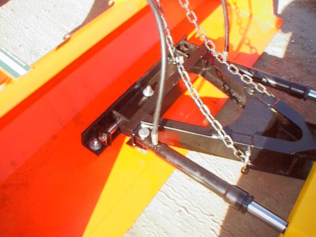

Here is a closer shot of the bracket. I think it is pretty slick and simple.

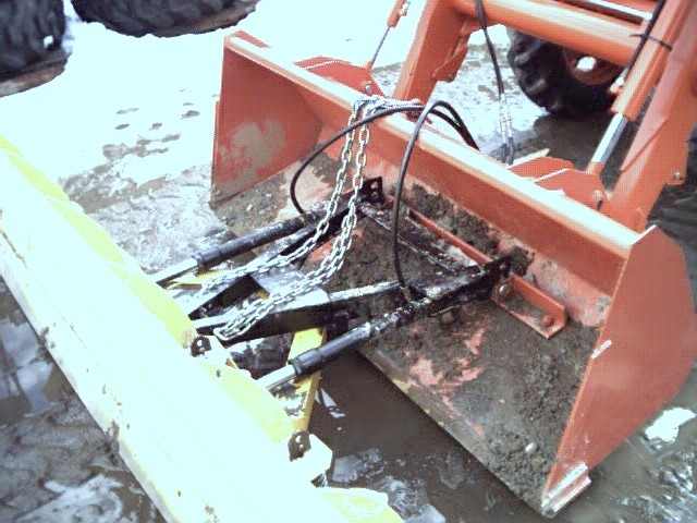

Does the dealer install new hydraulics for the plow or just use existing ones from the FEL?

Mike,
I would think and expect that if necessary, and if the machine owner wanted them,the dealer would install additional hydrolics.
On the machine I saw there last fall (not the one pictured earlier) they ran hoses back to the rear hydrolic fittings. I have attached a picture of that tractor.
It was also a Kubota (a big one w/ full cab) I believe that this one was theres and used to plow there yard. It doesn't show the hoses real well, but I remember them running down the side of the machine and into the rear connections.

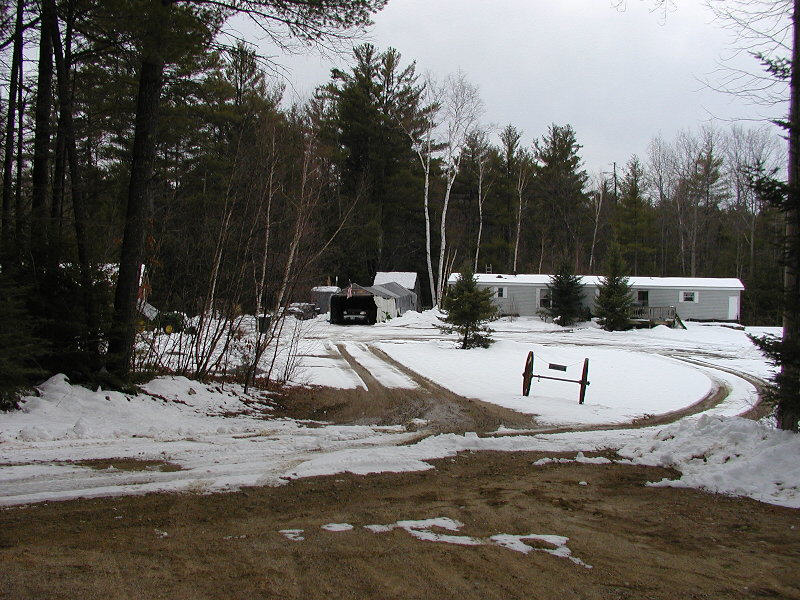

I have attached a picture of my yard taken from my neighbors driveway, unfortunatly there is no place where I can stand to get a picture of the Whole driveway and yard, but the pic will give you an idea of what I plow.
My driveway continues off to my left up to the main road, probably another 300', as you can see my driveway is actually a big tear drop with a good size parking area. I hate snow banks, So where possible I push the snow all the way to the tree line.
With the front blade, it probably takes me 2 hours to plow and clean up the way I like it. 1- I am in no hurry (seat time), 2- I am a fussy SOB. A friend once told me that they could use my yard for Super Bowl overflow parking.
