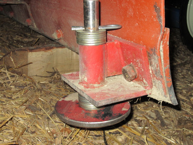

I made brackets that will hold plow shoes and they really help when you don't want to dig stuff up. They work if the plow is forwards or backwards and work in grass or gravel. When really soft, they will leave grooves but it is still better than without. Most times I try to pack the first snow down for a base so I don't have to put the shoes on and I do run the plow backwards on the gravel.
