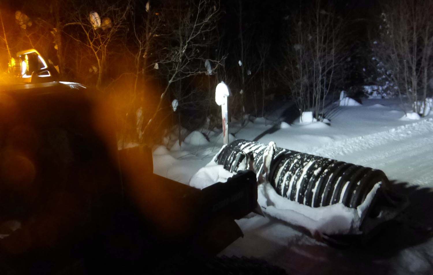

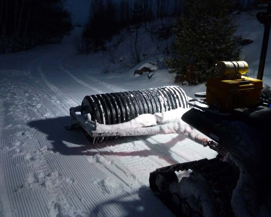

When I add a couple of LED lights, I will not install a relay just for that low draw application. We do add relays but on a different circuit. Same as ishiboo, we've found many switches to be of such poor quality, to be not worth installing them. We found Pollak brand to be well made and last a very long time.
Attached is a couple of photos taken during night operations. The 2nd one is yellowed from the strobe firing.
If you use crap switches, sure. A quality 10A switch will be rated to at least tens of thousands of cycles. Contura switches come in a lot of different visual styles, but they are all well-sealed and reliable switches and work great in tractor applications switching loads.
There are many reasons to use relays though.
