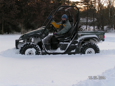

Mostly just puttering around, preferrably as stealthly as possible. It should be good in the snow, if possible. As far as work, i don't know what I'll do with it. Carry firewood, sporting equipment, tools, etc...
Easy starting, reliability and durability would be key criteria.
   / So how come nobody mentions the JD gators? #18
Snow? See attached...it wasn't stuck here either. /forums/images/graemlins/grin.gif
