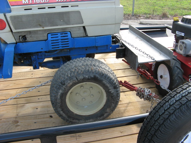

Aug 11, 2014 / So how do you fasten down #14 C Capricious Platinum Member Joined Jul 2, 2014 Messages 692 Location Eastern Missouri Tractor Mitsubishi MT160D (5) or (6) chains, with lever-type "over-center" load binders: This is for a 1,400 lb tractor. By the way, I have noted that some government agencies prohibit the use of "lever type" load binders on their own vehicles.
