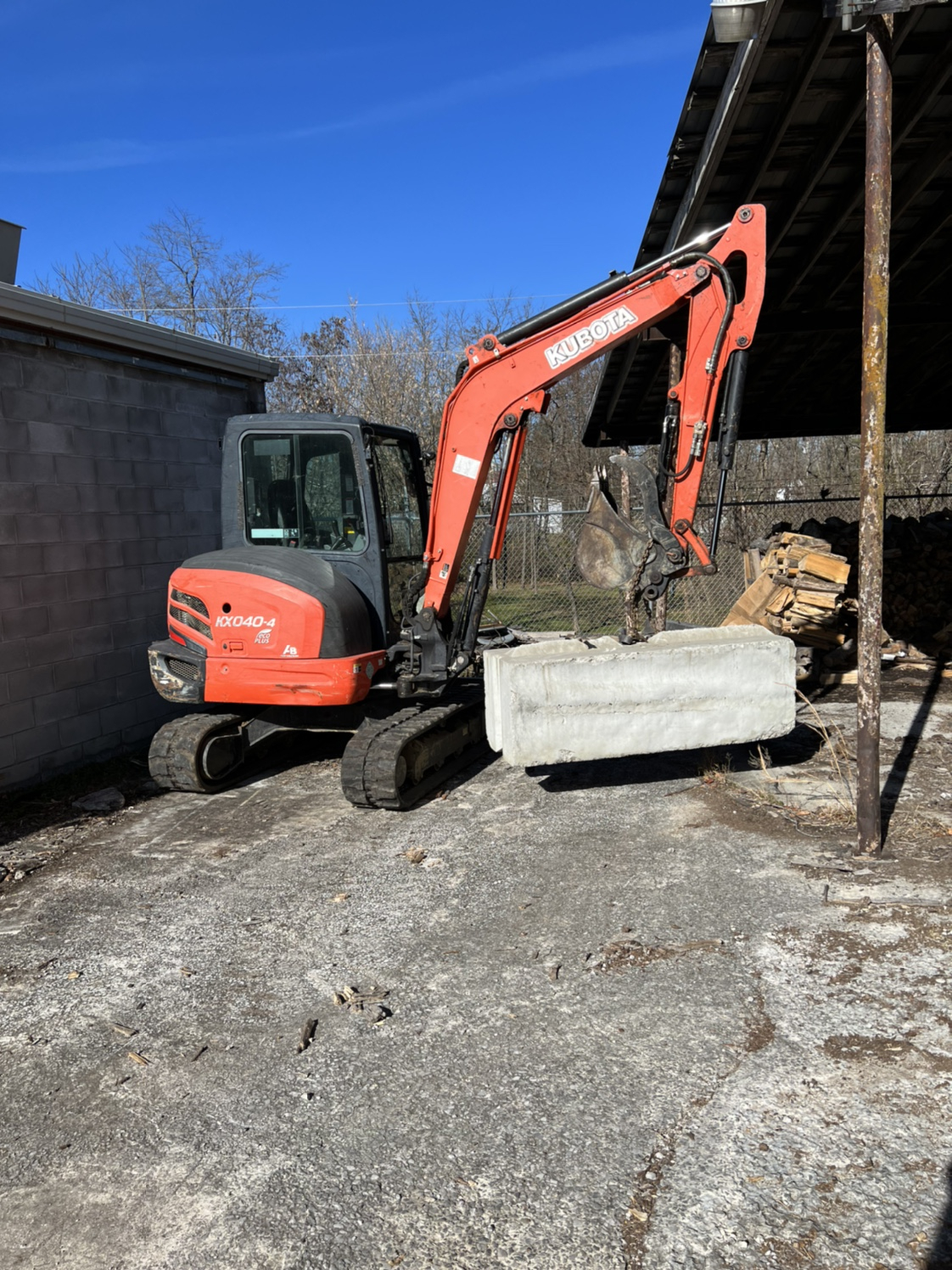

I have a KX040. It’s a great machine but it’s a little small for moving 3 foot rocks. It’s not my idea of good for clearing either although it will get the job done. It’s WAY better than a tractor backhoe if that’s the baseline for comparison. Overall I think you’d be happier with a bigger excavator.
   / So I am in the market for a compact excavator, maybe #7
I did this little clearing job with my KX040.

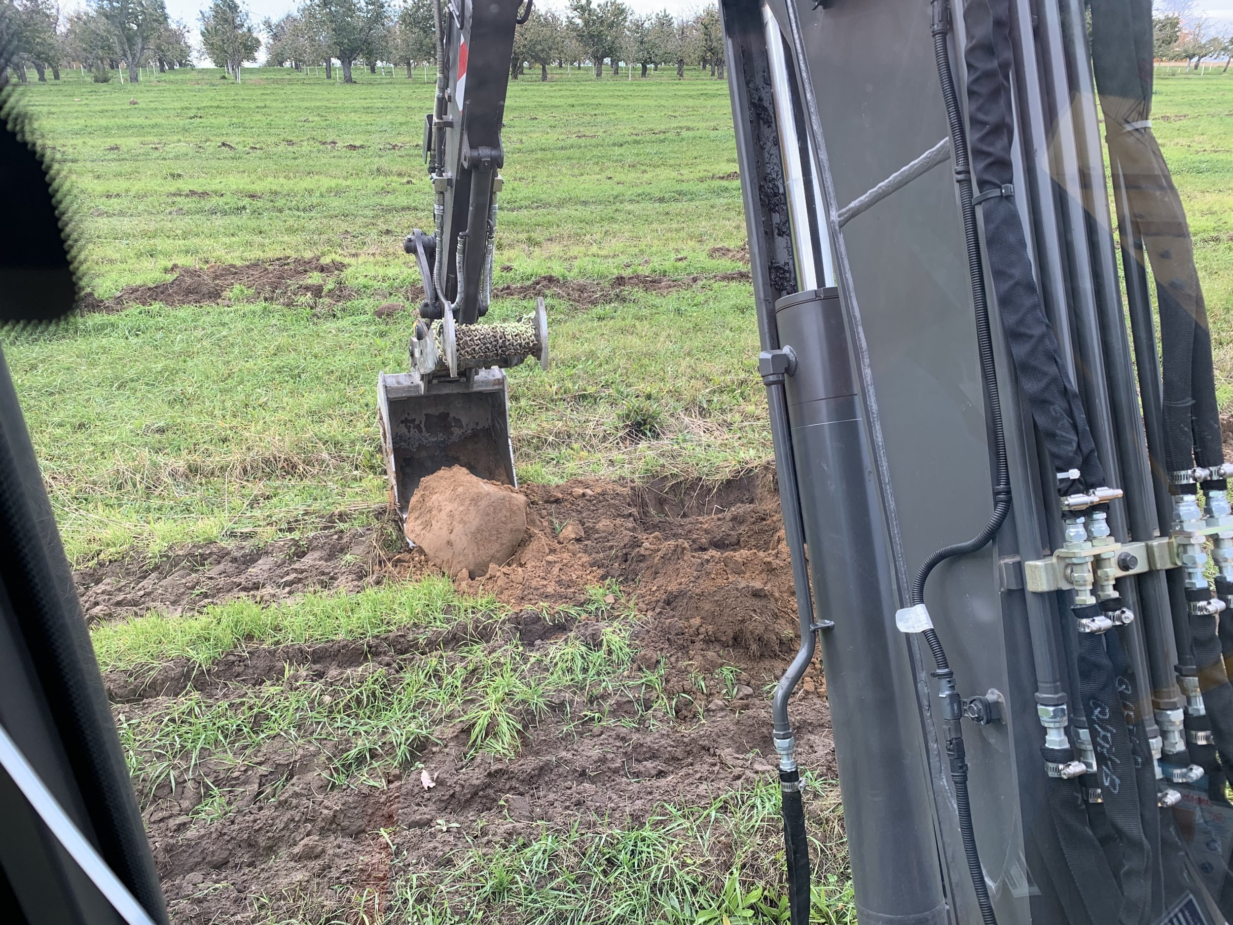

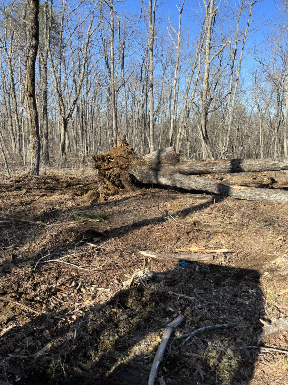

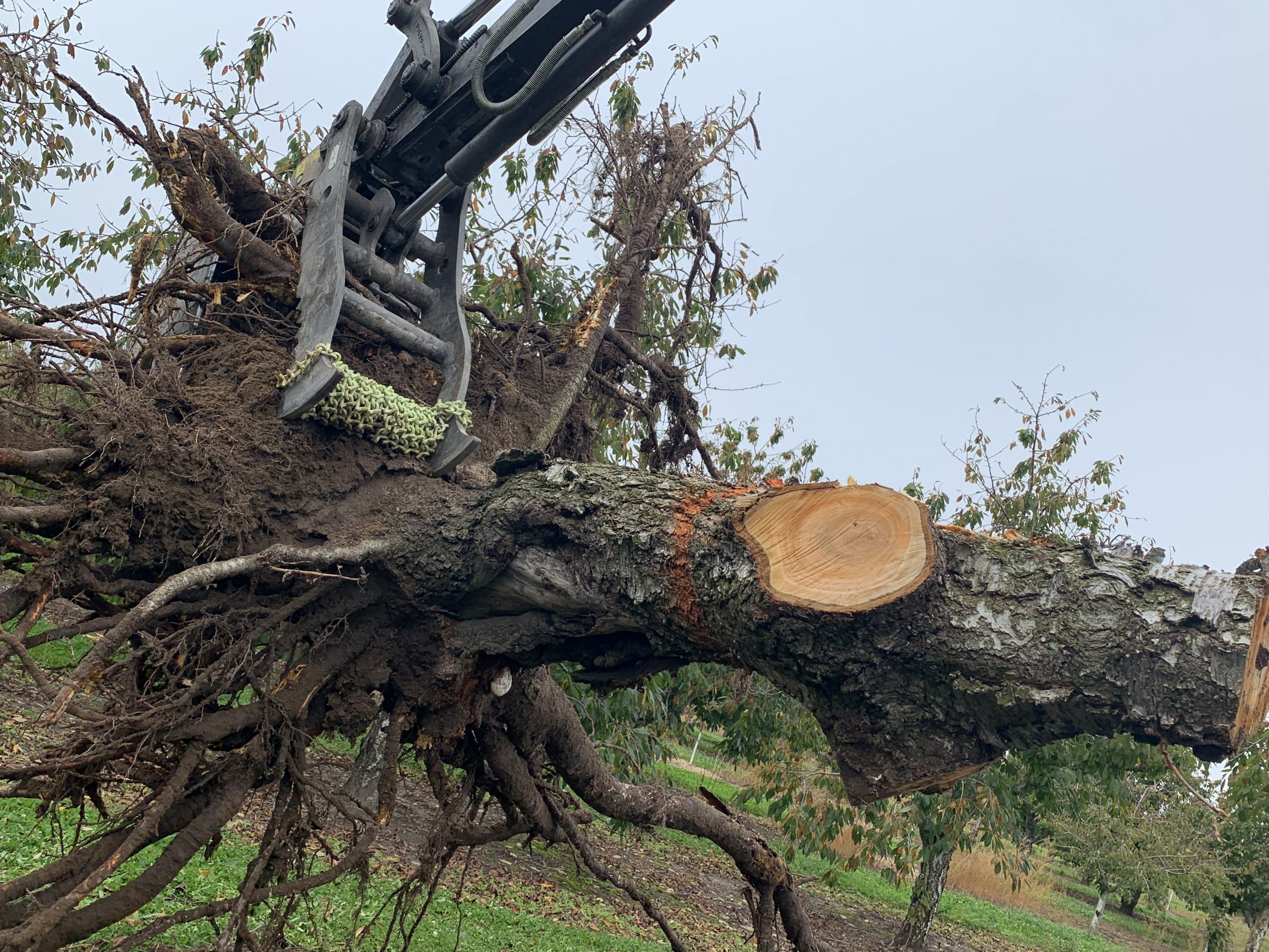

Few photos

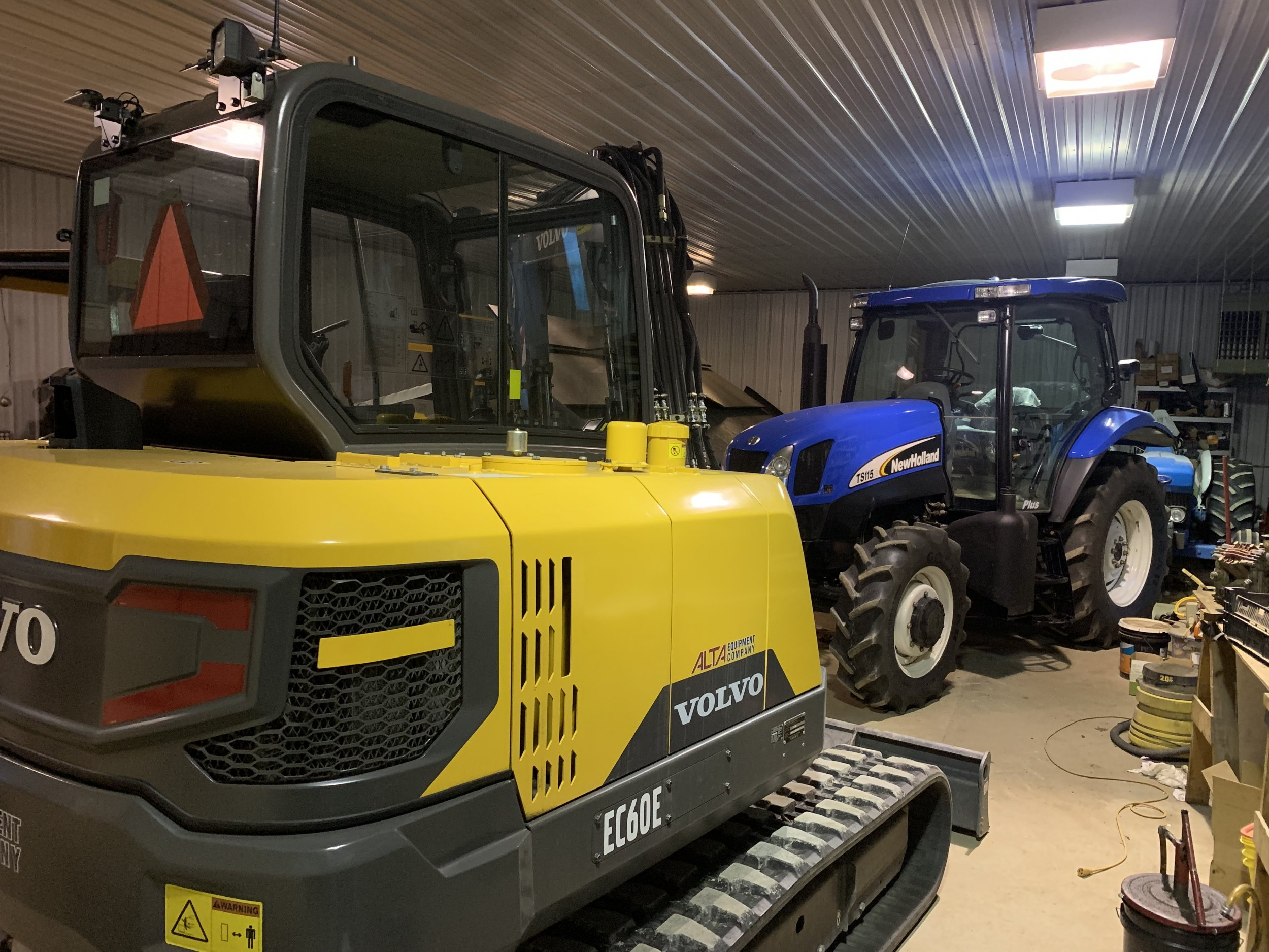

With the amount of work you’ve got planned I’d say you’d be wise to buy your own. Like 4570 I think a little bigger machine for the jobs you’ve described would be much better, 5-6 ton class. Realistically though in today’s prices for new you’d have to add about another 20k to your 60k. I bought my 6t Volvo new end of 2017 knowing I had a lot of work to do . Now have little over 1200hrs on it , no regrets. Pretty sure I could get as much or more than I paid 5years ago. Have you got a building of some sort to keep it stored inside?
Here’s what I bought for my a little bit bigger machine. I have a little over 50 cents a pound in those pieces so the value to work done ratio is good there.
