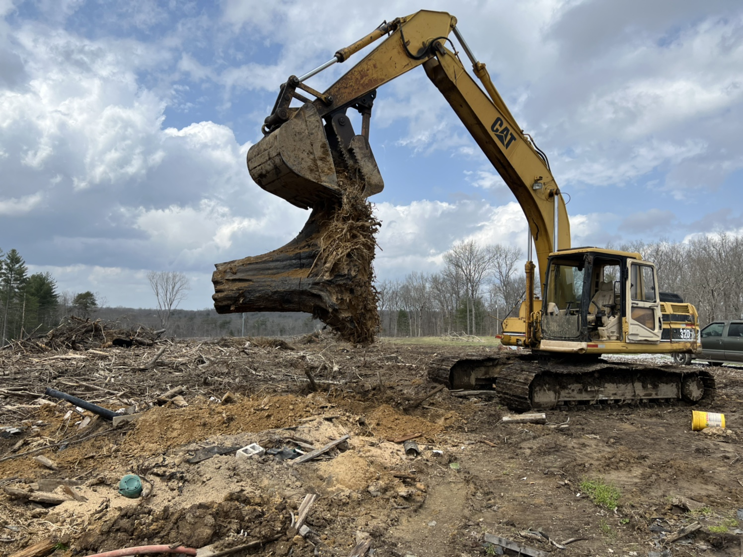

I don’t exactly like the haul bill but here’s how I scratched the itch for something bigger than my 40. View attachment 741258
