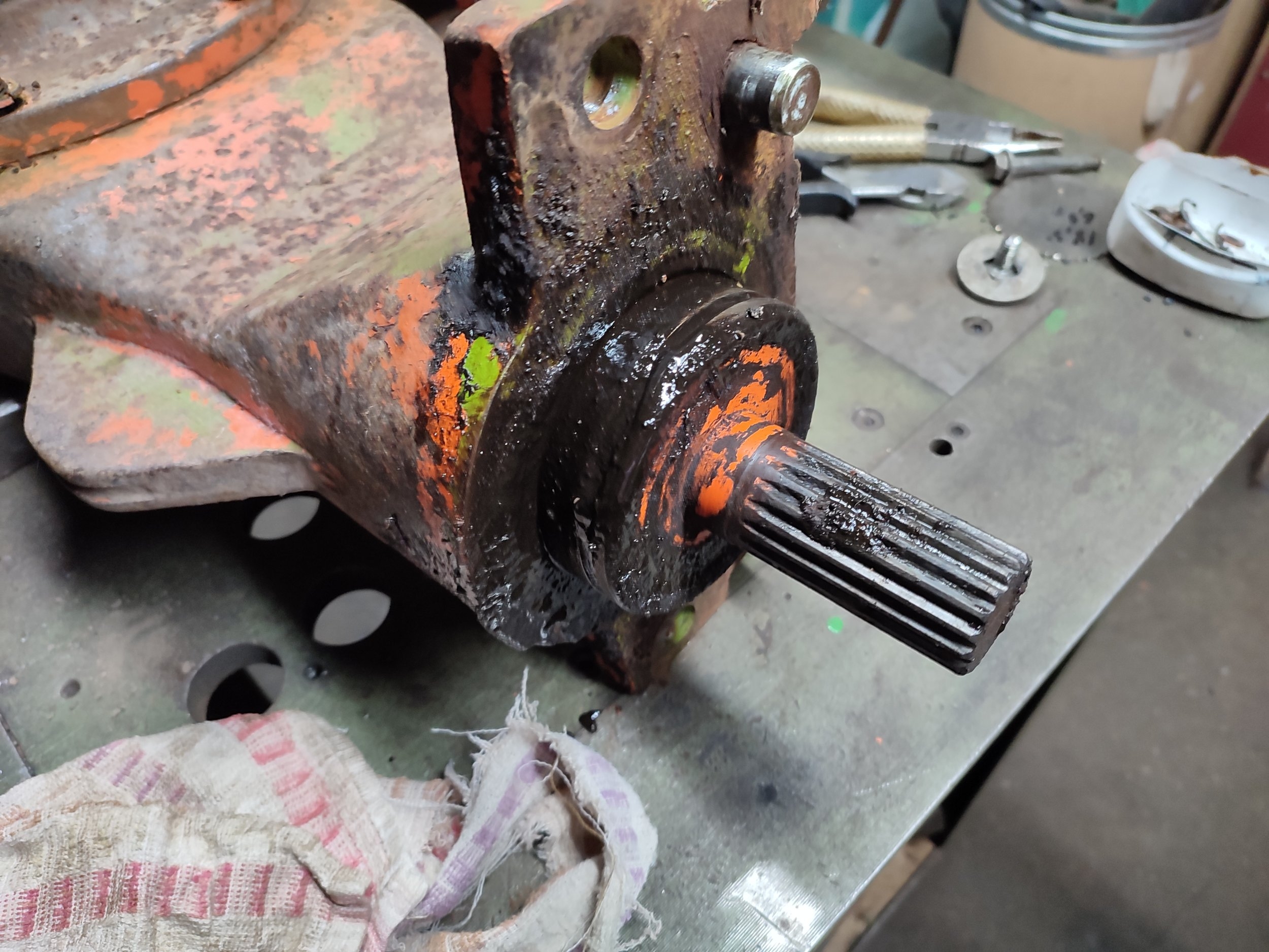

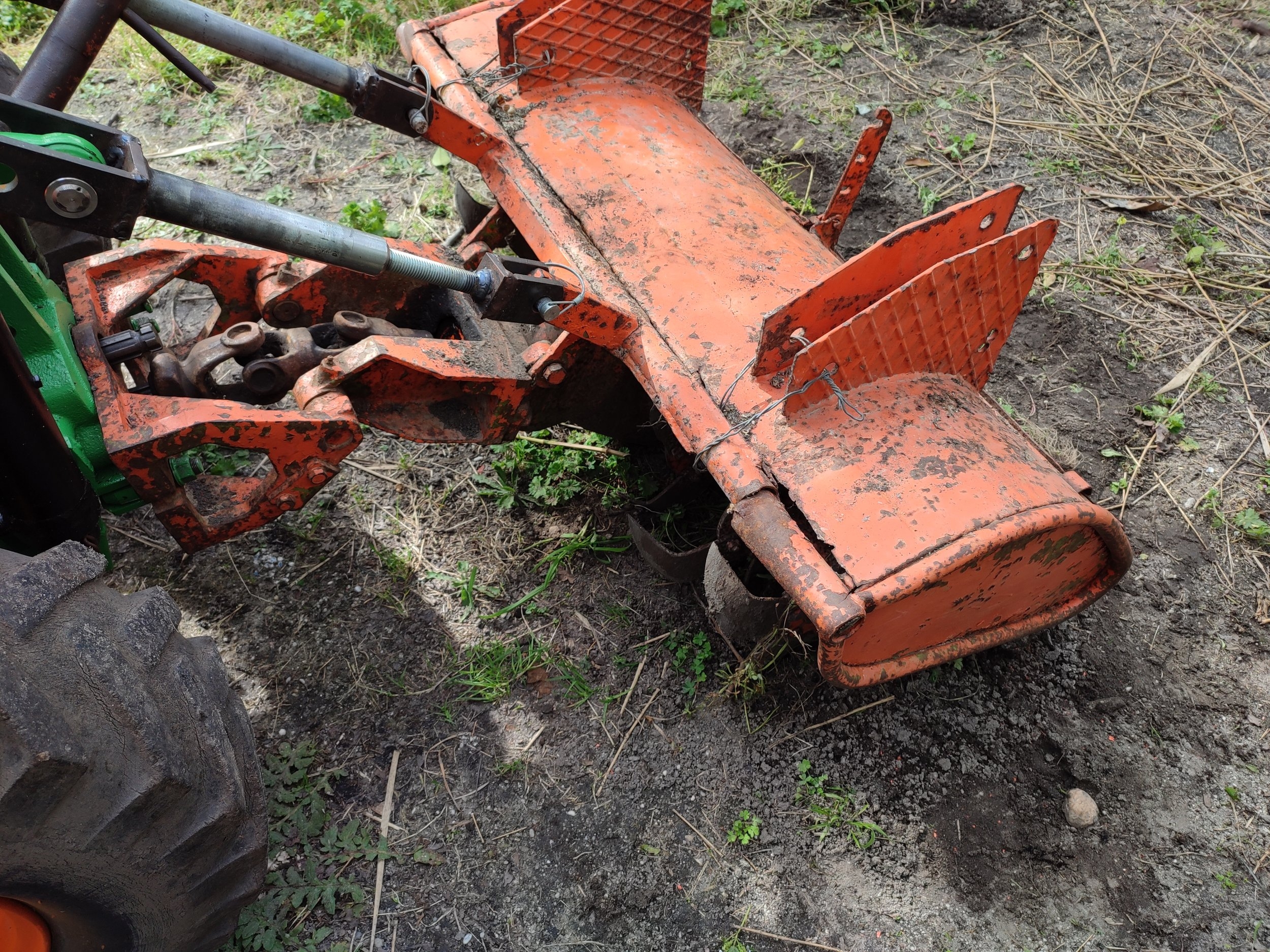

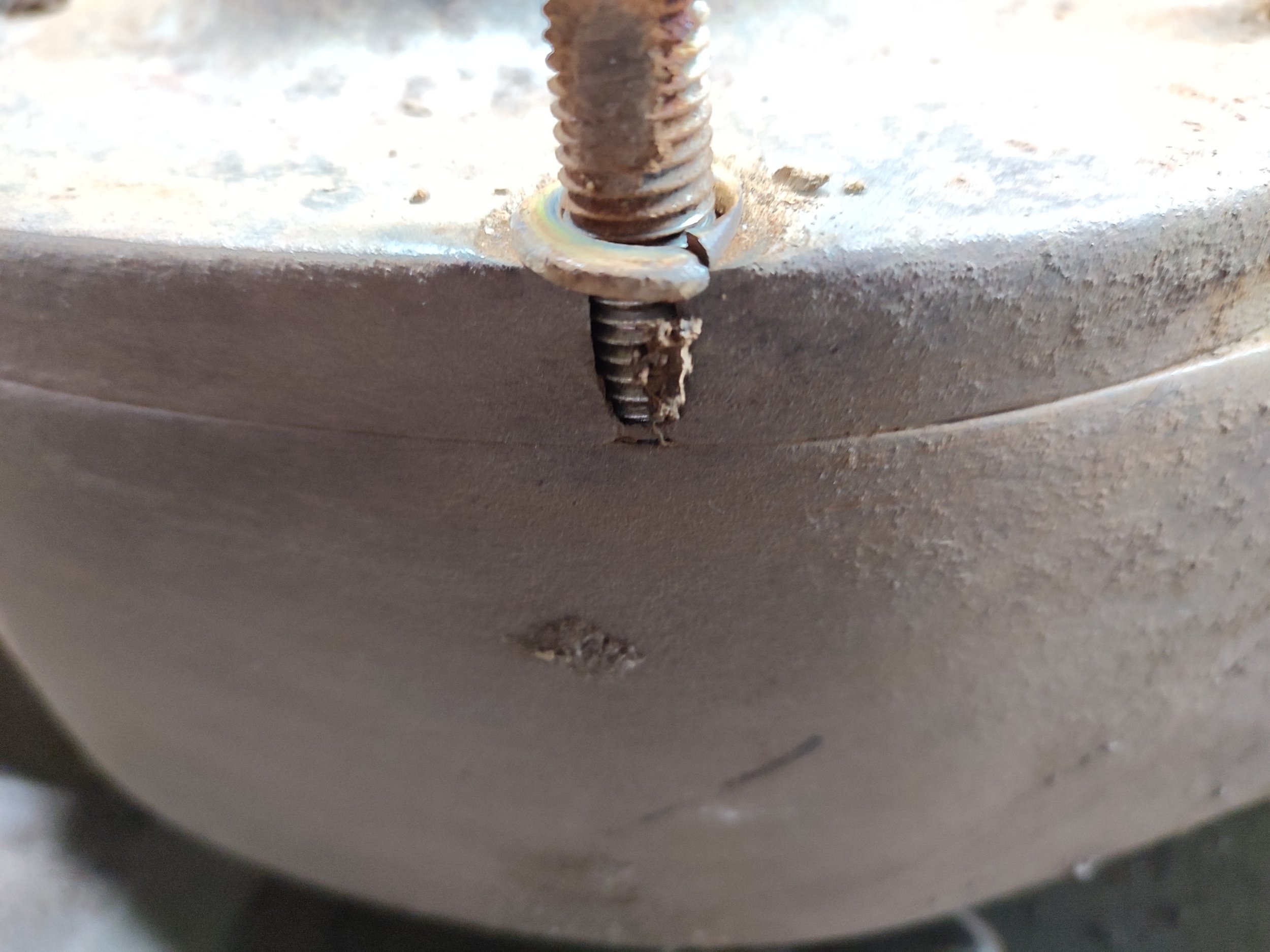

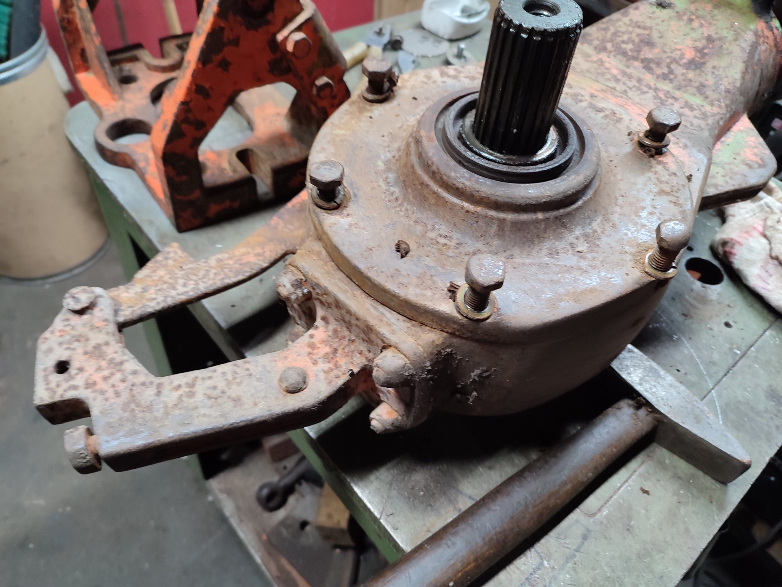

Some more pictures on the tiller. Mainly the gearbox.

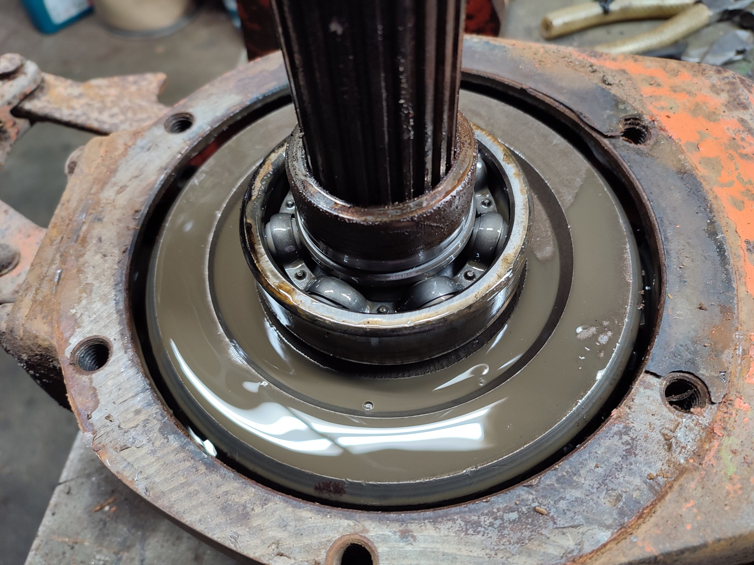

All the shafts on this tiller use a labyrinth style seal, for the lack better word. Not an actual seal, but create the same effect since the flanges have this lips sticking out. The seals are behind that labyrinth and are just standard rubber seals.
Input shaft. As you can see, not leaky at all. It dumped all the oil on my trailer during the entire time I was working on the tractor.🤦‍♂️

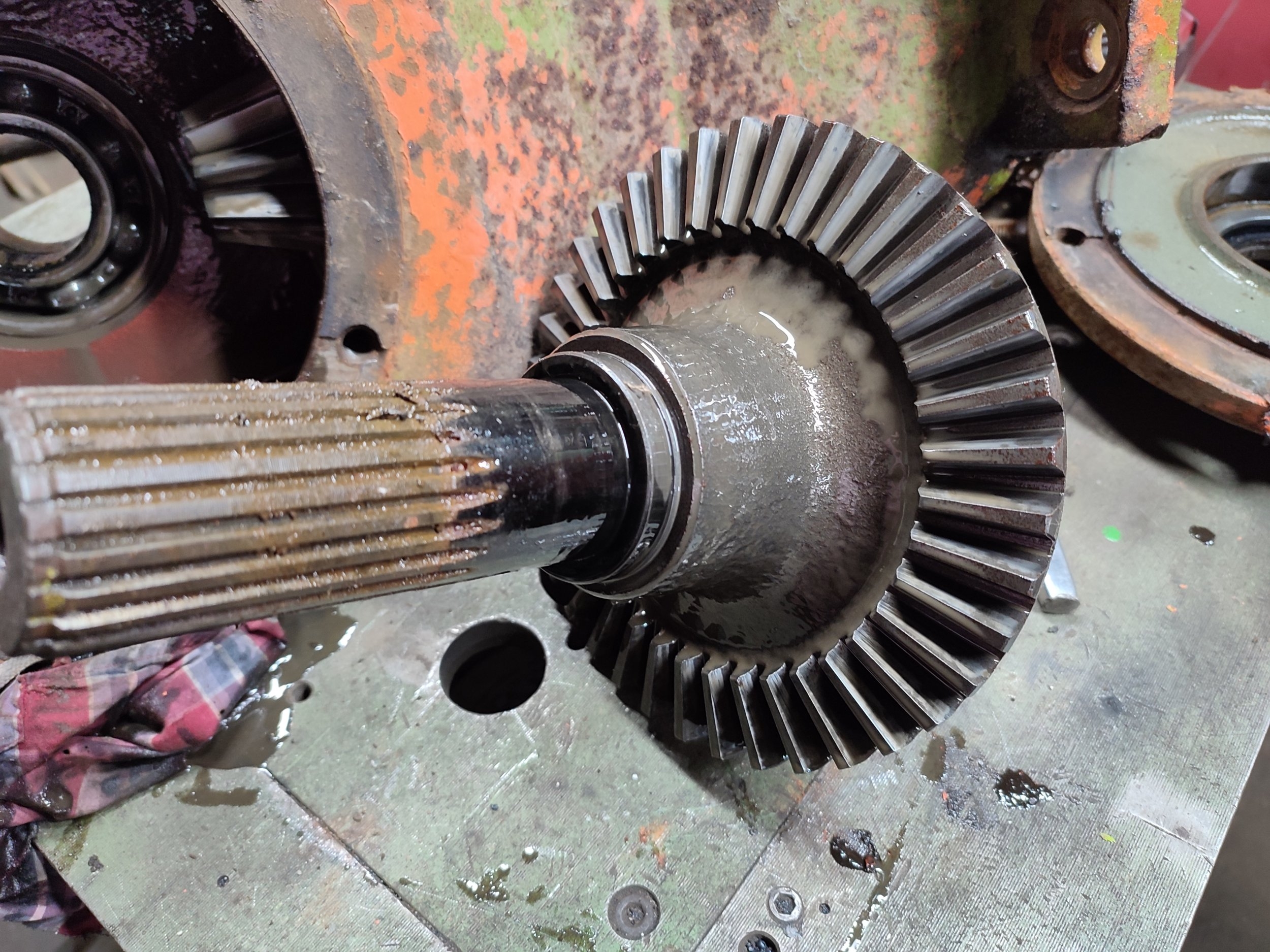

The other end of the gearbox. Note the wear on the bolt heads and actual gearbox from dragging on the ground for who knows how many hours. The bottom bolt wore half way through the head and even exposed the hose on the big flange. I will add some material using flat bar.

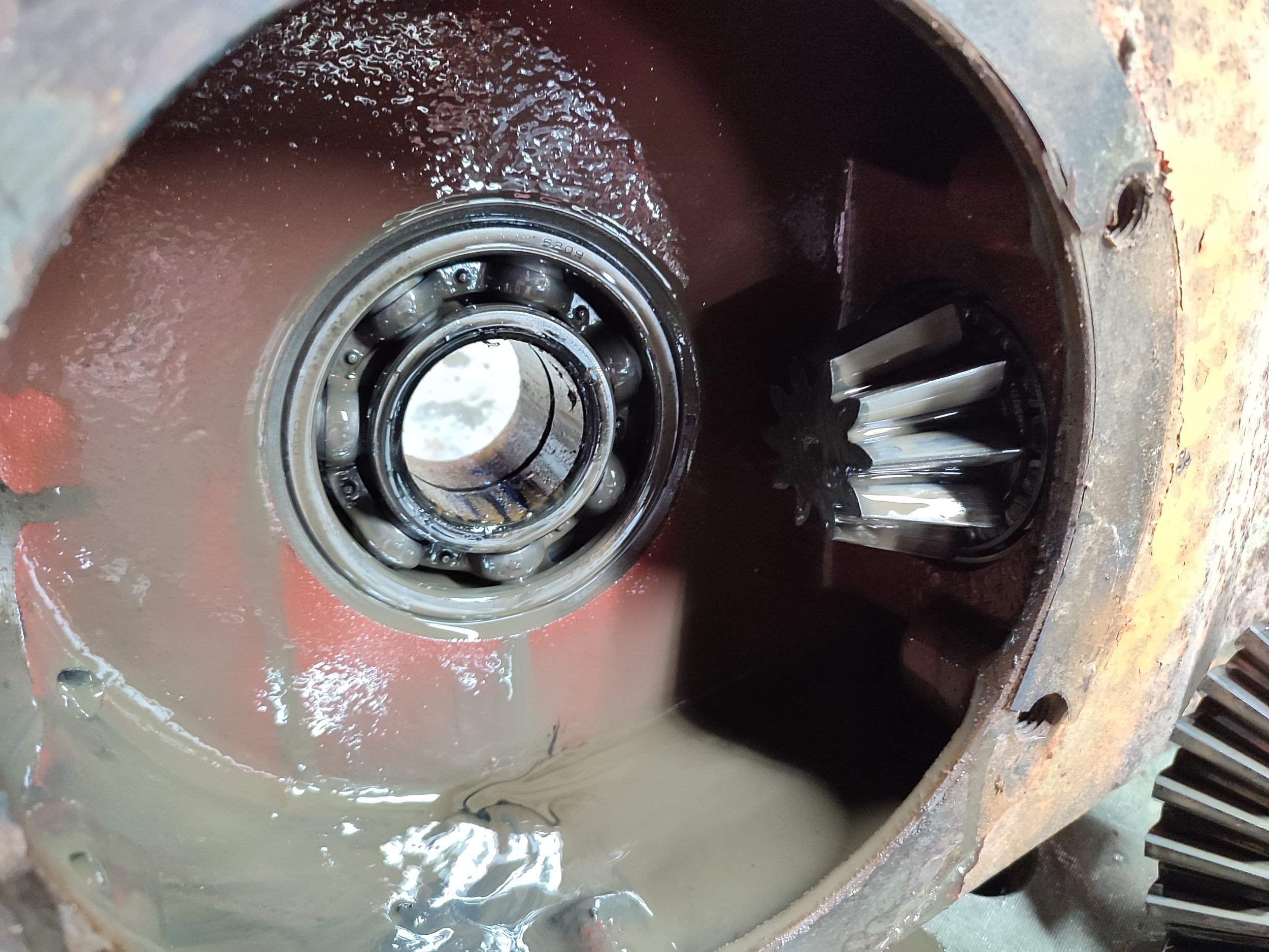

The internals of the gearbox. Really in fantastic shape. Gears and bearings are perfect. It actually uses bigger bearings than my big tiller.
Today I got all the seals, a new U joint for the super short PTO shaft this uses and some more kerosene to use on the parts washer so I can wash all these parts.
Not an huge fan of these tillers with the gearbox in the center but with this tractor, that actually works well. Since the tines are "open" in the sides, it lets it steer with the tiller still on the ground very easily.

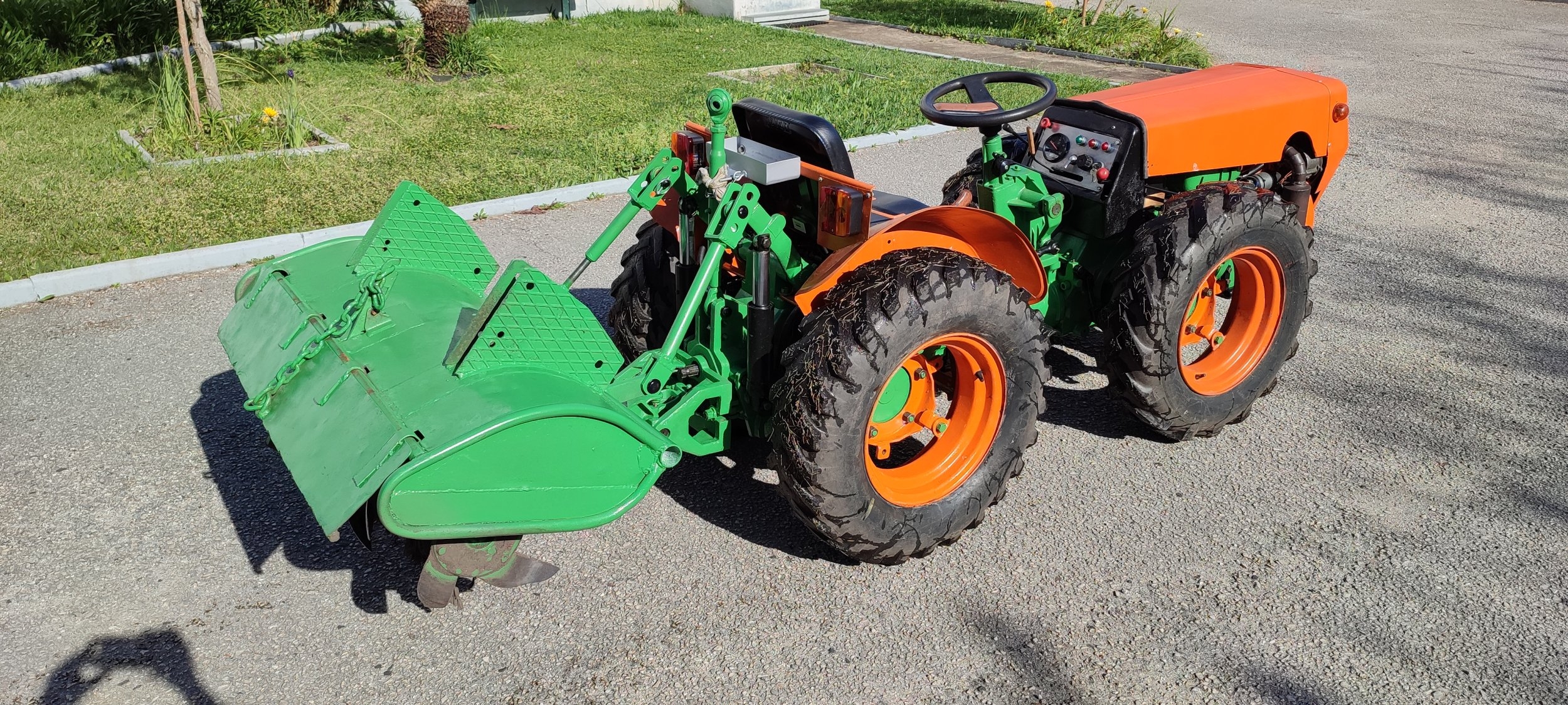

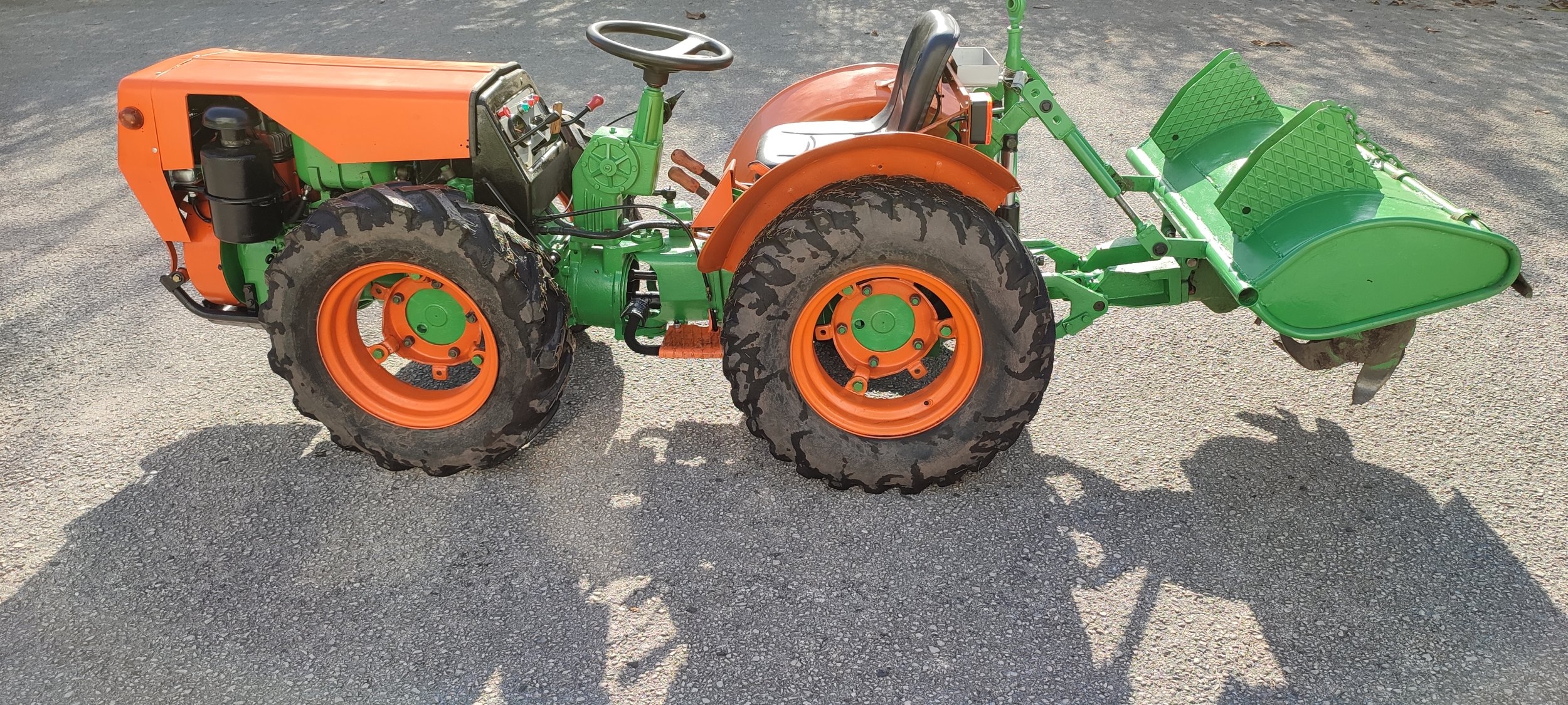

I realize I kinda neglected this thread, however, I did finished the tiller and got going again, which makes the project pretty much completed.
So far I've put about 6 hours on it. A couple of adjustments needed here and there, perfectly normal. Mainly brakes, without split brakes, it's a bit tricky getting both wheels braking equally, so I need to go up to speed and brake gently to see which wheel locks up first, then proceed to adjust.
I can say, this thing without power steering, it's an handful for sure, specially dragging an implement on the ground like the tiller. It probably doesn't help that I replaced the old cracked and bent steering wheel with one that fairly smaller in diameter.
It does have a different gear pattern but once you get used to it, it's actually nice and kinda makes sense being that way. All the controls work very nice and smooth, I'm super happy with how it feels.
The low profile is great. I can fit this tractor in places I thought I would never put a tractor in there.

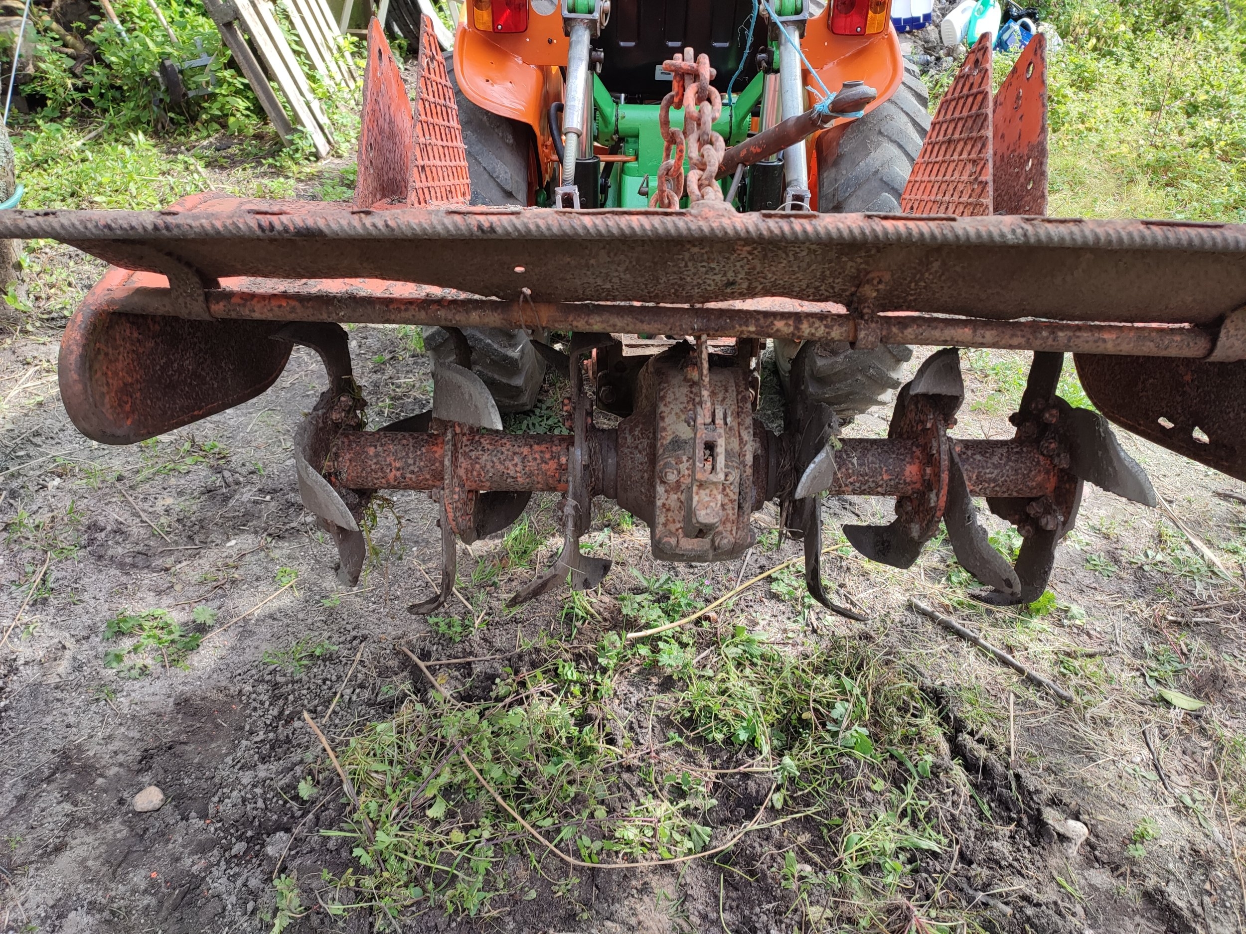

The tiller was disappointing, even though the tines are wore out, I would've expected better performance from it. It barely scratches the surface and I have to do multiple passes to even get an half decent job out of it.
I think I figured out why it's not working very well. I believe someone put shorter tines for some weird reason. I still have to go and measure the tines to confirm this theory though. That's another €120 for 24 new tines.

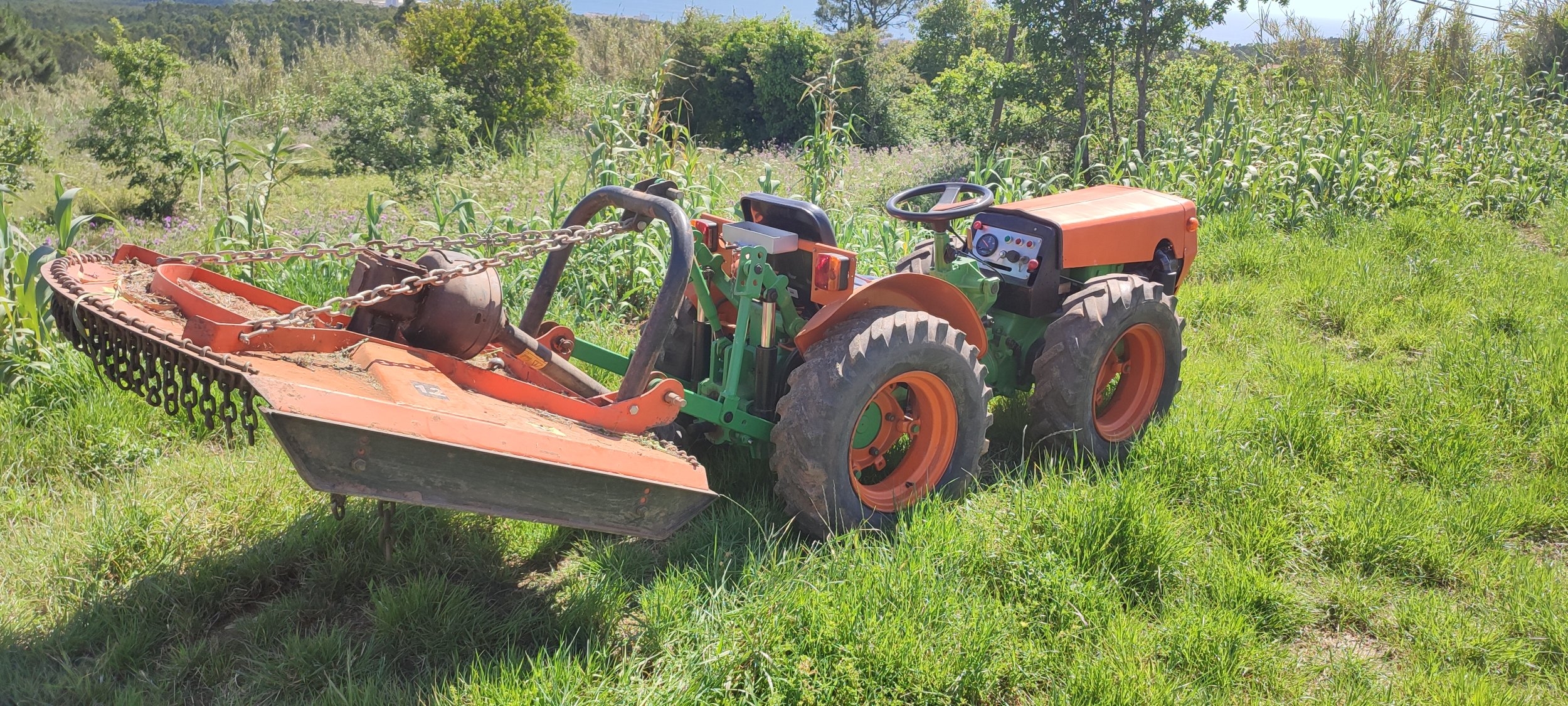

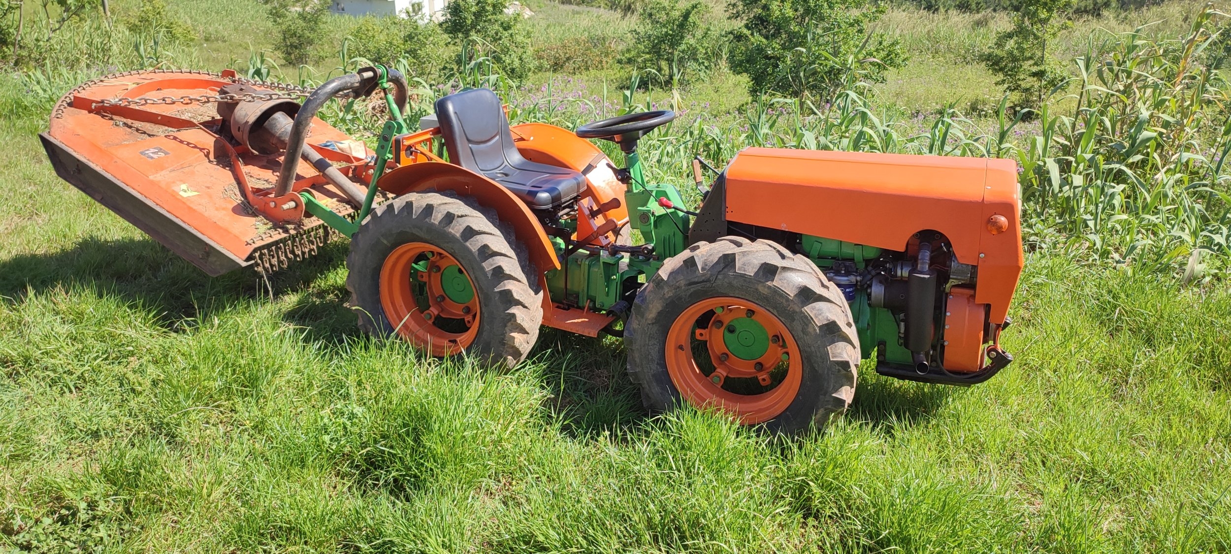

A couple days I ago, I test fitted the brush cutter on the little Agria. It's too big for and a little bit on the heavy side but still managed to lift it. Ideal cutter for this tractor would be at 1 meter width. This is one is 1.3 meters and being that it uses chains, it makes for a lot more load on the tractor.
I didn't get to run it because it would require me to cut the PTO shaft about 150 mm. While it would still leave plenty of overlap for the Branson, I still rather cut if I really need to use this cutter on the Agria, so I'm holding off on that.
   / So I did a thing... Agria 8900D #170
View attachment 870268 View attachment 870271
It looks angry with it on the back though. Like it is ready to get serious. :ROFLMAO:
