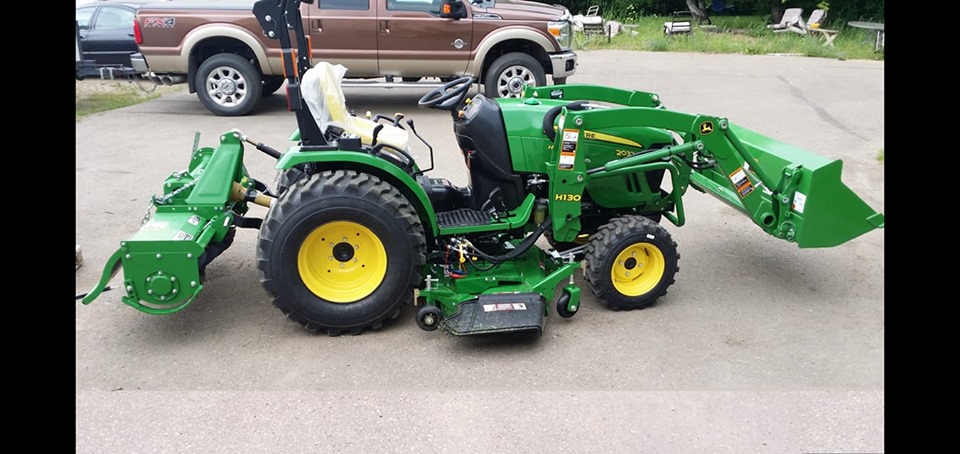

I had a wonderful little Massey GC2400 with a snowblower and cab, used it all winter and just loved it.
Trouble is I also have a very low hour 2014 JD 2032r, with front end loader, 655 tiller, 65" MM mower, wood chipper and weight box.
The massey is really a single use unit.
I tried for a few months to sell one or the other, and the Massey went first.

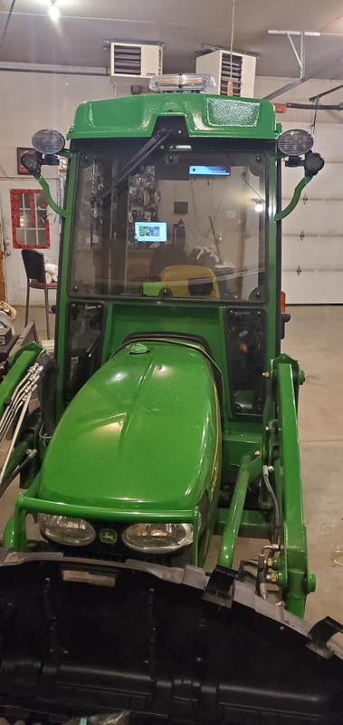

I bought a nearly showroom mint 54" blower today, and should have the cab in a month. I am seriously looking forward to the install.
I ordered it bare as possible, opted for the JD green paint on the roof, and heater. The only other thing it comes with is a windshield washer.
I will add working lights, backup and interior lights, amber strobe and clearance lights.

It's a Tektite Cab as noted in the thread title, and it seems their cab is an ROPS cab.
Nice set up, if you have not removed snow in a heated cab with a front mounted snowblower with in the cab chute rotation/deflector controls, then you will be in for a real treat this winter.

THe cab is just bolted on, heater hose and electrical are just laying on the hood until I get them hooked up.
ROPS comes off, the cab is rated for it.

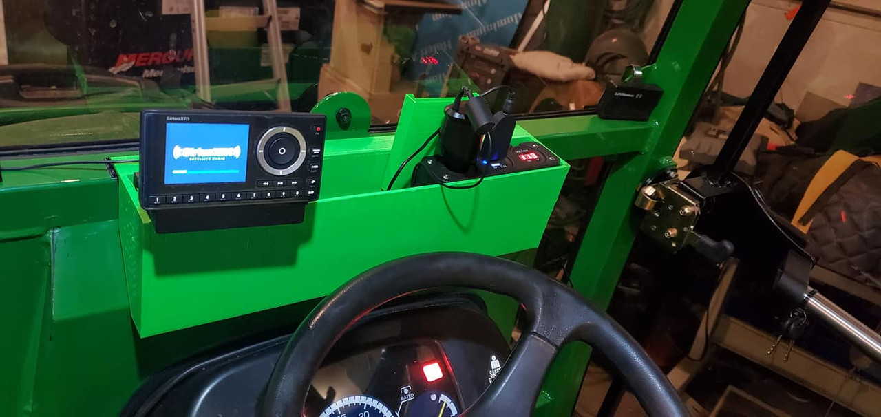

All done. Even added a bunch of lights, 3d printed a compartment to hold the sirius, aux lighter and my phone. Turned out very well.
