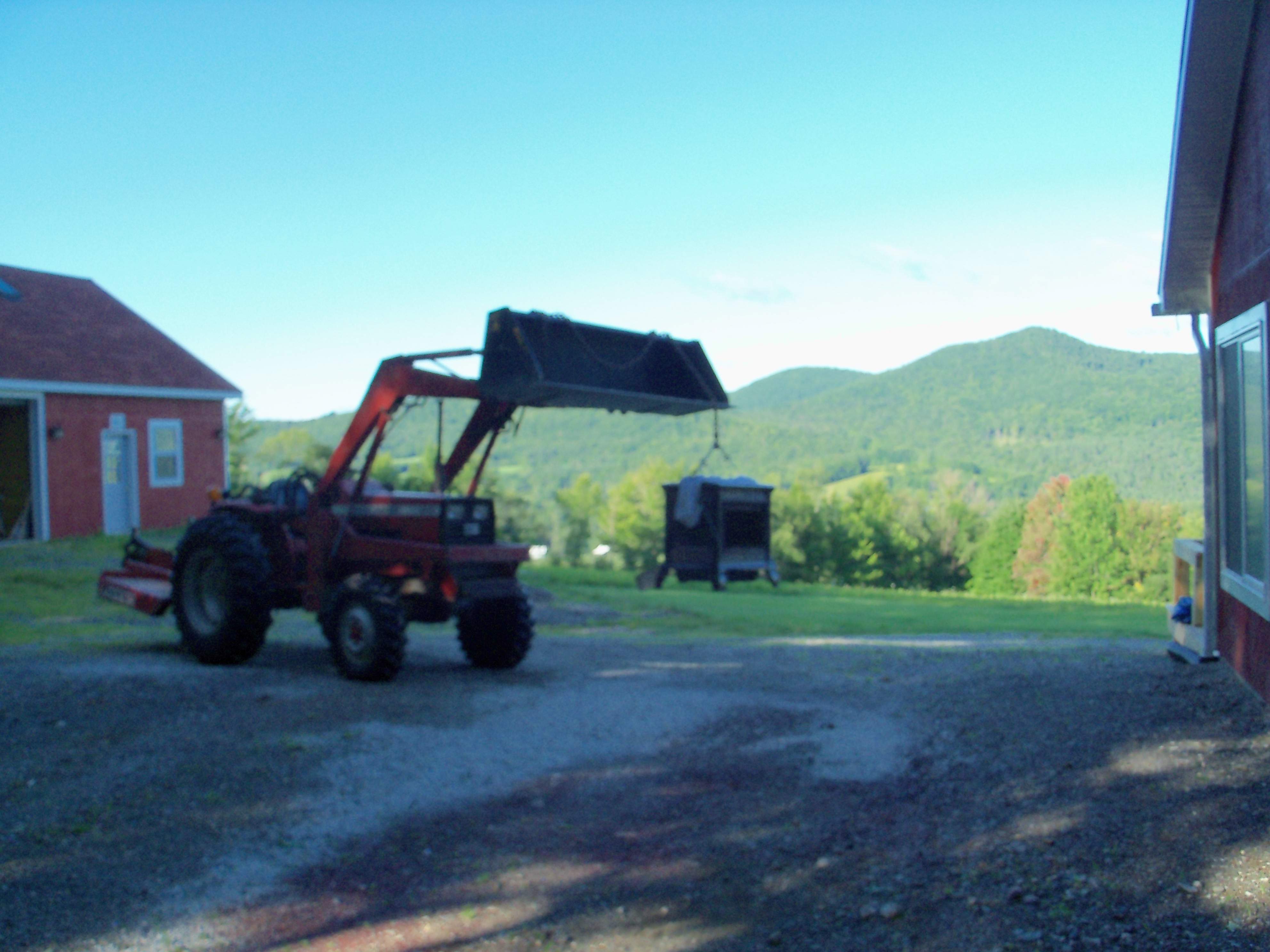

Good Evening Son of Man,
Thats a great little tractor, I have the big brother to your machine the MF 1040 for the past 10 years, and it has been a very dependable machine !
Most any good grade transmission hydraulic oil will work fine, I believe I used Hytran when I changed mine.
