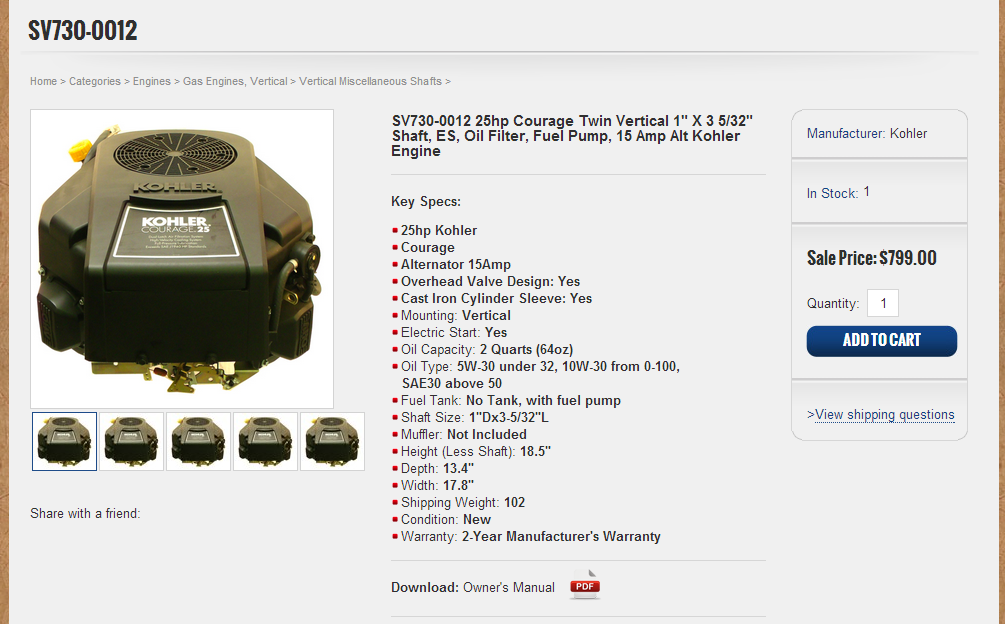

It is too bad that Power Trac didn't set up their engine compartments to accept vertical v-twin engines. The vertical engines seem to sell for about $500 less then horizontal versions, possibly because of economy of scale. It seems that just about every lawn tractor or zero turn mower out there uses vertical engines. Some of those mowers are cheaper then just a horizontal engine.
I am thinking vertical engine with a clutch/pulley attached, and a vee belt or poly belt connecting to a vertical stack-up of hydraulic pumps. I think it would fit better, give better access in the engine compartment, and give you a clutch to make engine starting easier.
JJ, can the hydraulic pumps be oriented vertically?
Of course, trying to retrofit such an arrangement would require replacing all of the hydraulic hoses and fittings, since their existing lengths would be wrong.
Yes.
Most vertical engines are way less expensive.

One thought on a vertical arrangement: you will probably raise your center of gravity. If you are on the flats, it may not make much difference, but any slope usage will be impacted.
