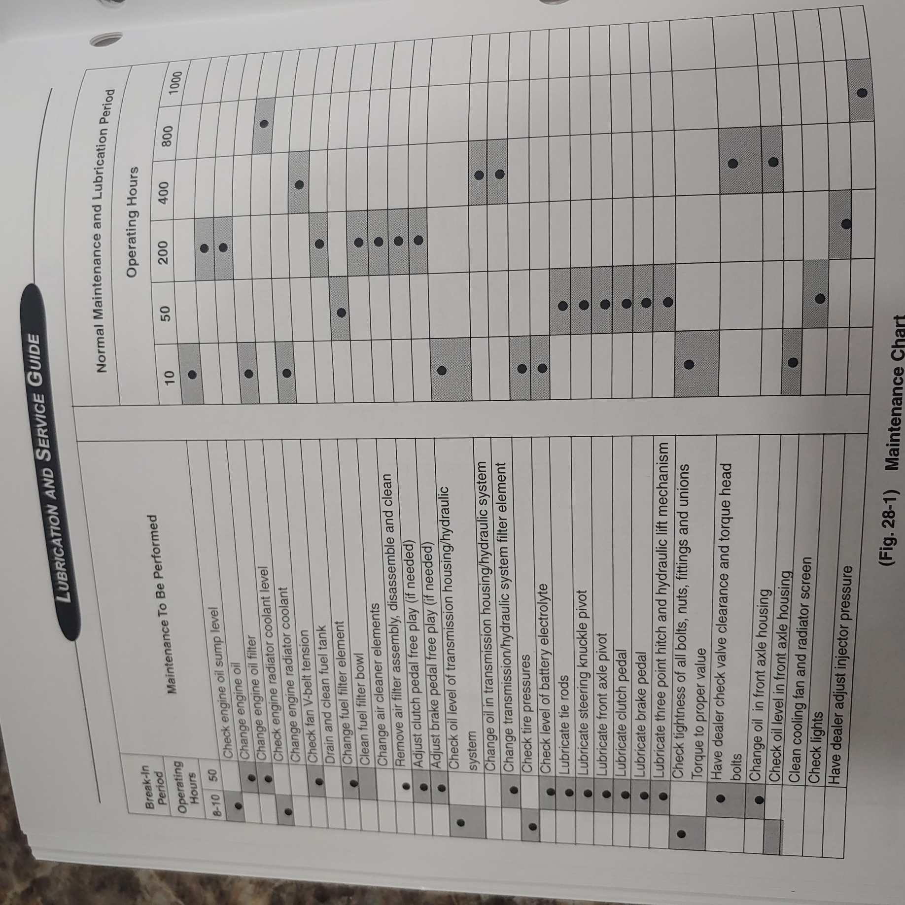

Maintenance and service intervals

Done the 400 hr trans fluid change today. The spec is purtty close on 9gal. I used TSC premium trans/hyd fluid and a wix 51536 filter.
