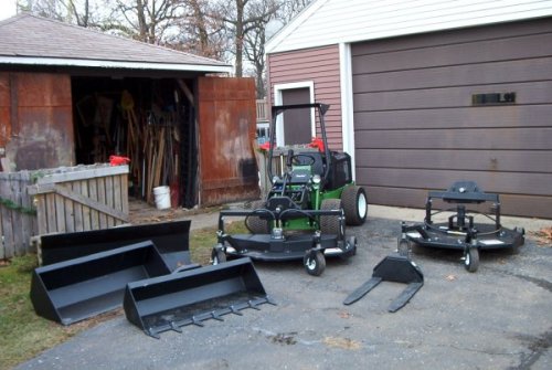

Since you mentioned Swiss Army Knife... here goes.
Personally, my goal was to eliminate as many machines to maintain as possible. So I got one that did every task I need to do, and it does them all very well. Not perfect, but very well. I finish mow my lawn, rough cut my trails, clear brush, plow snow, move material, excavate holes, clear downed/felled trees, gather firewood, etc.... all with one machine. We maintain our one acre home site and about 20 acres of remote property with about 3 acres of fields, 400' of road and 2+ miles of trails. I also used it to maintain our Little League park with mowing and diamond rehab/maintenance, as well as the diamond at my wife's church, and various church ground cleanup/maintenance, etc...
It's articulated, has what most would consider low ground clearance, but never gets stuck due to the articulation and oscillation. It's not a pulling machine, so ground plowing and stump pulling isn't its thing. But it will run circles around conventional tractors of the same size in the tasks I've mentioned.
Since budget isn't your concern, several machines might be OK for you. ZTRs are hard to beat for mowing, but for about 1/3 of the cost of a ZTR I can get a towable self-powered wing mower to tow offset behind my machine and have a 108" cut.
Anyhow, good luck with your search... there's so much out there.
