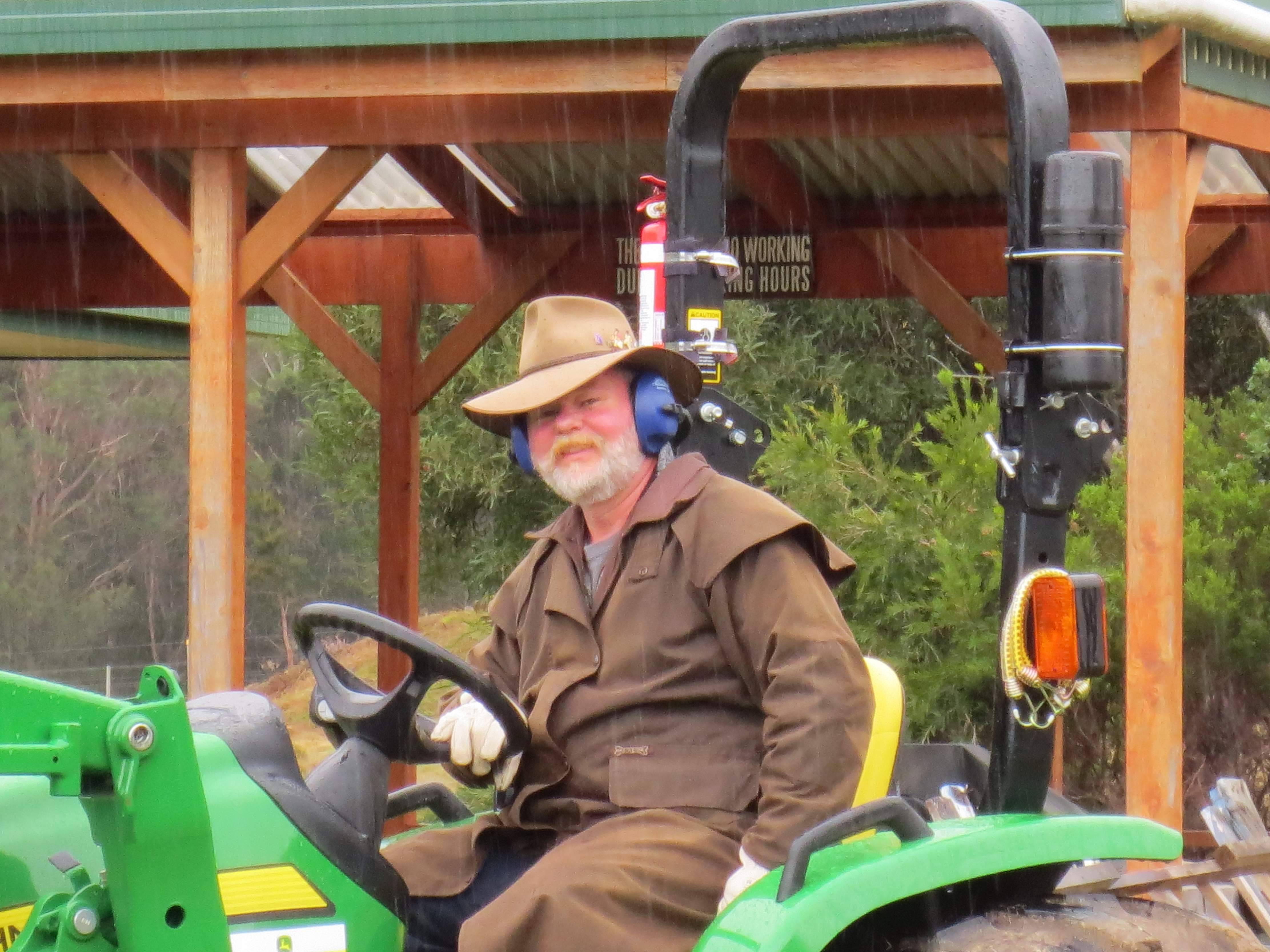

Definitely mount a fire extinguisher on your tractor. I did within days of getting mine, but then I'm a pedantic retired Navy bloke... got two in the house, one in the ute and two in the workshop. I recommend mounting it using a cut-up foam neoprene stubbie-holder (I think you call them a koosie?) as an anti-vibration gasket. You can see mine behind me on my ROPS.
Incidentally, I've put a first aid kit in the 'document canister'... just in case.
You said that you twisted the wires together... did you then wrap the 'splice' with electrical tape?
