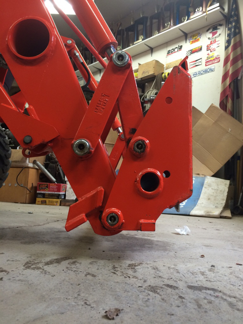

Not a very enlightening photo but it did happen. It doesn't show the misguided way I mounted the loader brackets too low- again my first time and I didn't realize that most lower pins are level With the pin latch.

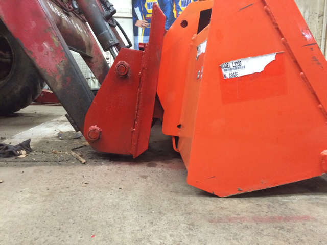

This is my kubota bucket that I put on after the conversion to make sure the Titan adapter did work. It needed a little grinding in the corners but fit well

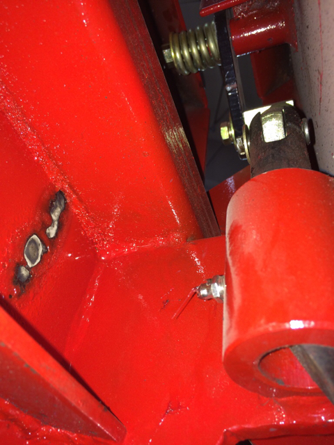

The second photo shows lack of thought on Titans part- straight fittings with no possible access. Luckily they were finger tight and I could replace with 90s
I'm trying to follow this but I don't quite understand the issues you came up against.
What are the 90s that you used for replacement?
   / So you think converting a Pin-On to QA is Easy! #75
Oh, we're you talking about the grease zert?
I still don't get the alignment problem on the plate and/or quick attach adapter.
   / So you think converting a Pin-On to QA is Easy! #76
Sorry - yes the zeros are up in a pocket boxed in and unuseable as shipped. As the old saying goes ".. A picture is worth a thousand words". I will post tomorrow. For now-
The "weld on assy" from Titan has huge plates for welding on brackets that hang down at lower than necessary. I just welded on the brackets level with the bottom of the plates since I didn't want it hanging down and digging in. Afterwards I noticed that most loaders have the pivot (lower) pin level with the area where the lock pins engage the attachment plate.

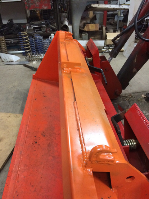

ImageUploadedByTapatalk1455126371.644232.jpgImageUploadedByTapatalk1455126387.842913.jpgImageUploadedByTapatalk1455126403.577791.jpg
First picture shows the weld on plate assy and loader pin with bucket. If the bucket was curled back it would drag ground. It is barely passable but I didn't want to grind off all the welds so i'll live with it for now. As long as it doesn't drag the only downside is less down travel of the attachment- no digging big holes.
The second photo shows without the bucket. It is approx 6" from where the bottom of the SSQA plate to the bottom of the Titan frame work.
The 3rd is the kubota- only 3 " height difference.
Still not sure why Titan makes the weld on assy plate hang down so far past the SSQA plate. Hope this helps someone else.
