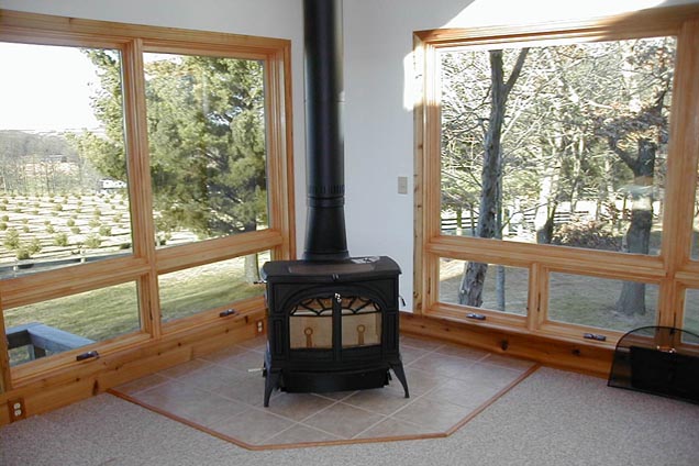

I just installed a vermont castings Defiant wood stove, and it is heating a new 720 sq ft room with ease, and outside temps from 0 at night to 15 in the day. It is very easy on wood, as it has a catalytic burner that burns the combustion gases. Its been operating for about 5 straight days now. Stove cost is $1.8k.
Pic attached
