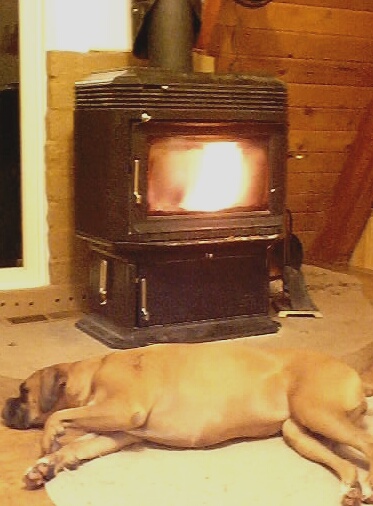

The nice thing about having a digital camera is that instead of typing up what I like about it, I can just walk over and snap a picture. Picture attached is what my dog thinks of our Jotul...
BoonDox; I do agree with you on the Jotuls catalyst clogging up though...even burning a few envelopes with the clear plastic window can clog the catayst. We only start fires with newspaper now.

I can see my one dog doing that. As it is we have a old house with steam heat and the big cast radaitors, and he will lay down right next to it. He wil be tuching it. Of course he has the least fur of the 3 so he must be cold.

Nice looking dog! BullMastiff?
