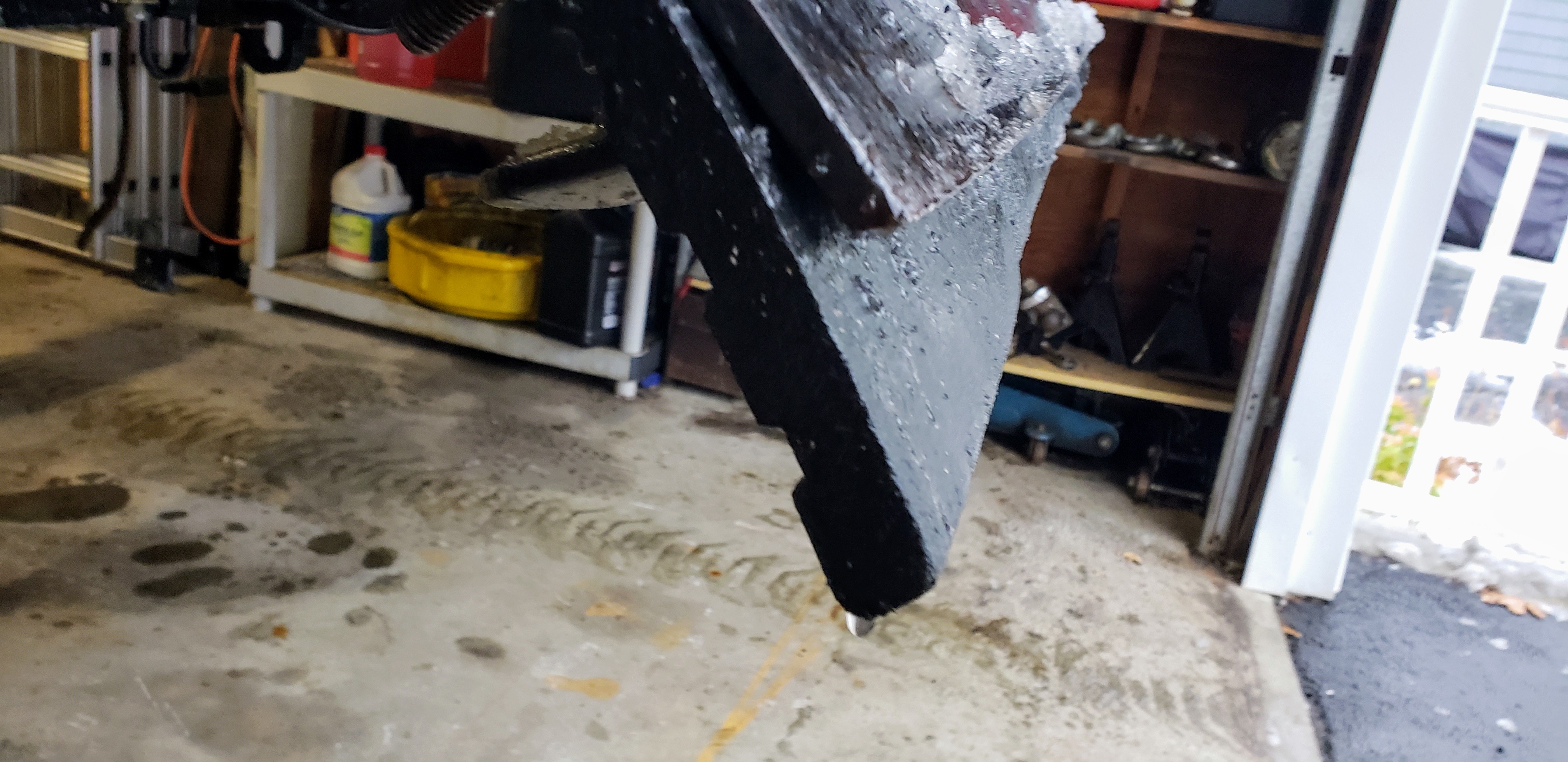

Roy, what is the rubber strip? How dense is the material &where did you get it. I’m not convinced the stall mat others have suggested is quite the right material.
It was an option to replace the steel cutting edge...so, it came with the blade. The blade also has skid shoes.
It's quite dense, but I've no idea of the durometer reading

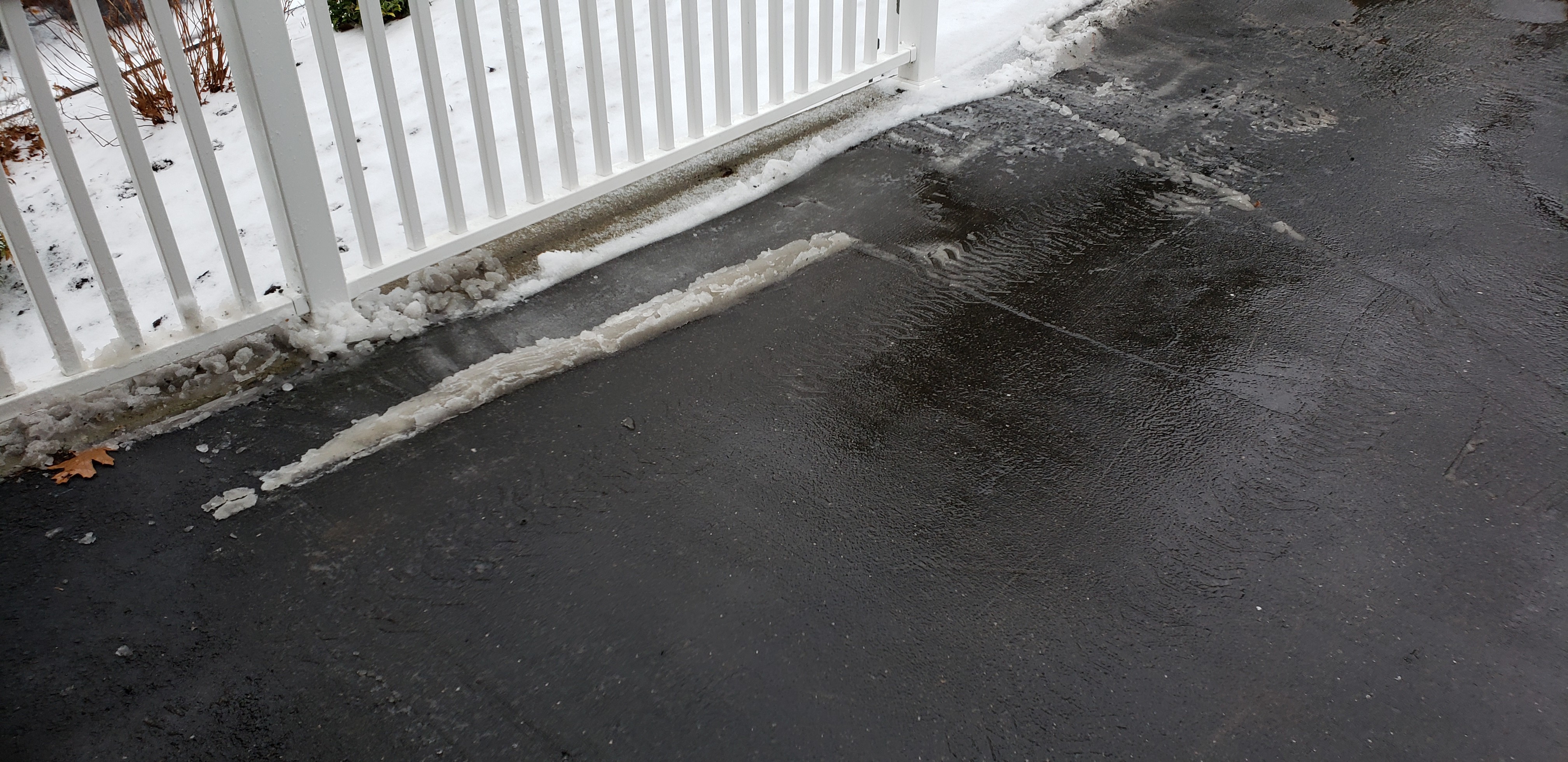

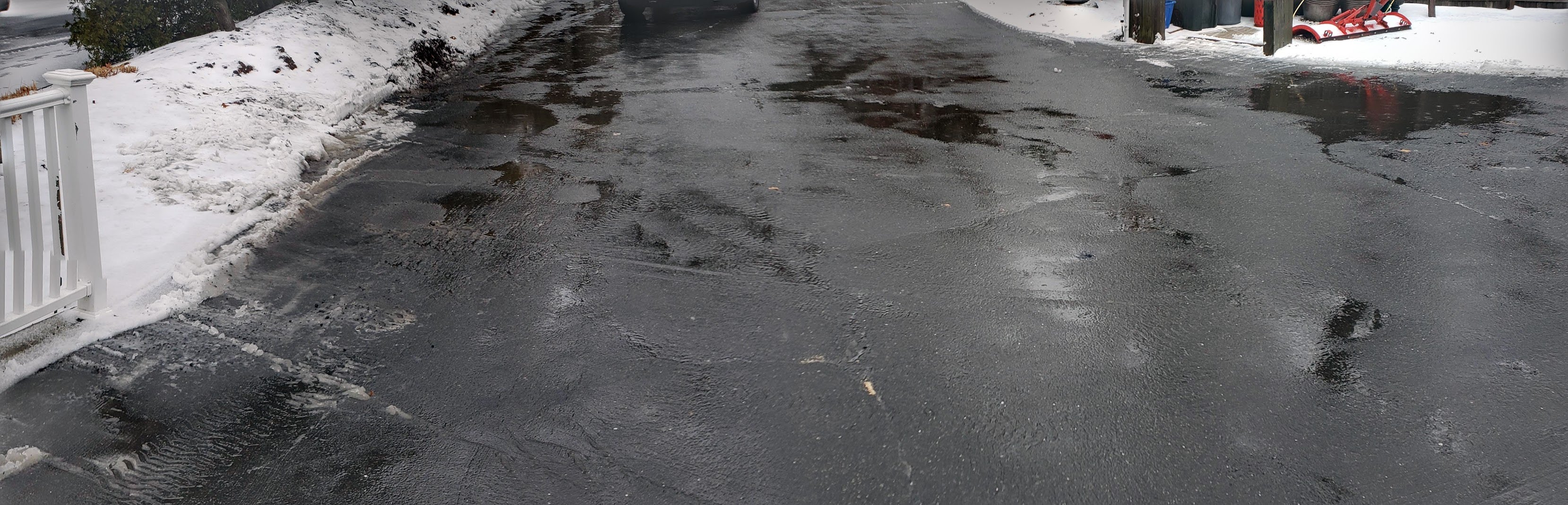

Update... I finally got a chance to use the plow with the rubber stall mat attached to the blade. It worked really well like a giant squeegee here are a few pics 20190120_101805-PANO.jpg
