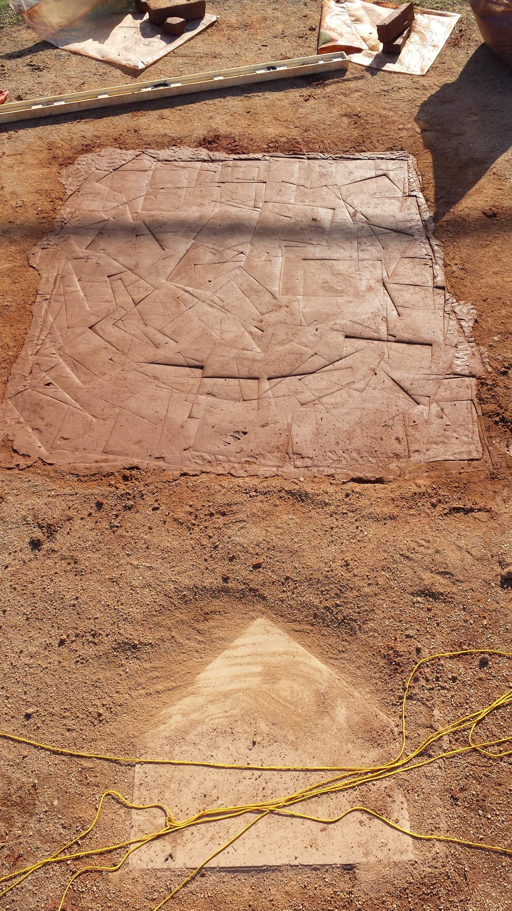

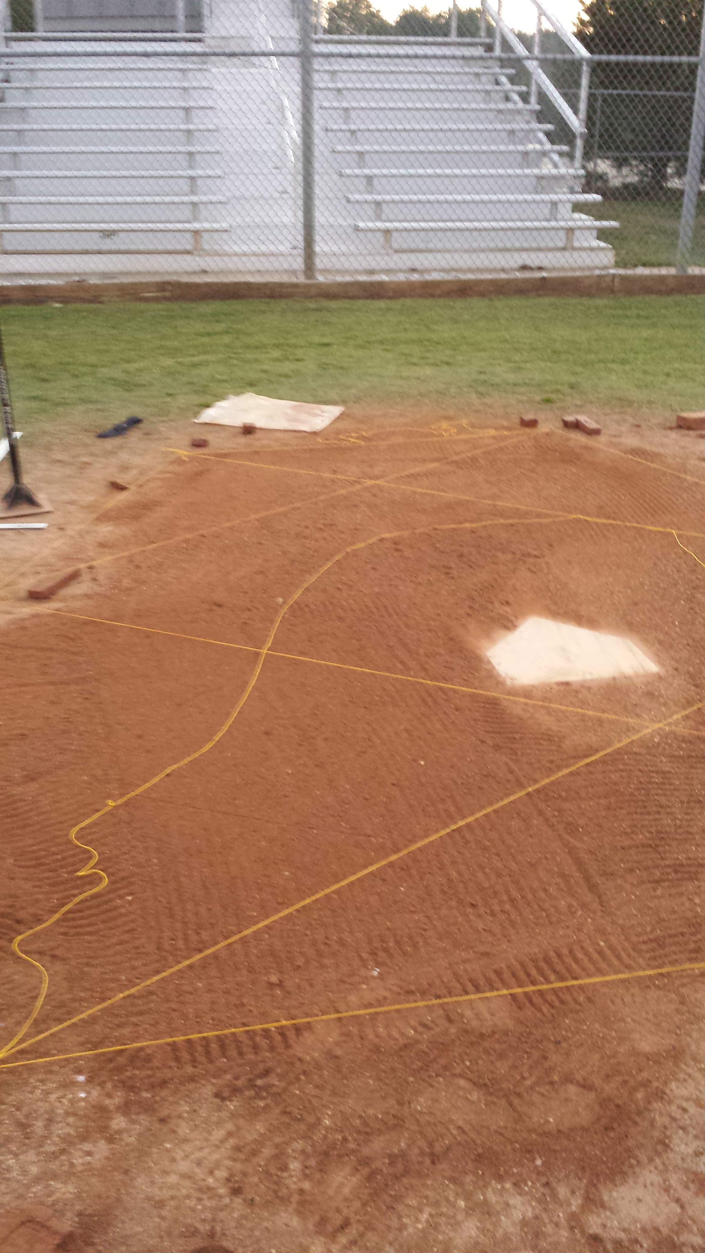

Since it rained Saturday after doing the righty box. I took a half day of vacation Monday to try to wrap up. Was actually good that it rained so much because digging and getting down to good clay and peeling layers of it became much easier on Monday, even if each bucket full to carry off and dump was much heavier.
Started first on catcher's box.

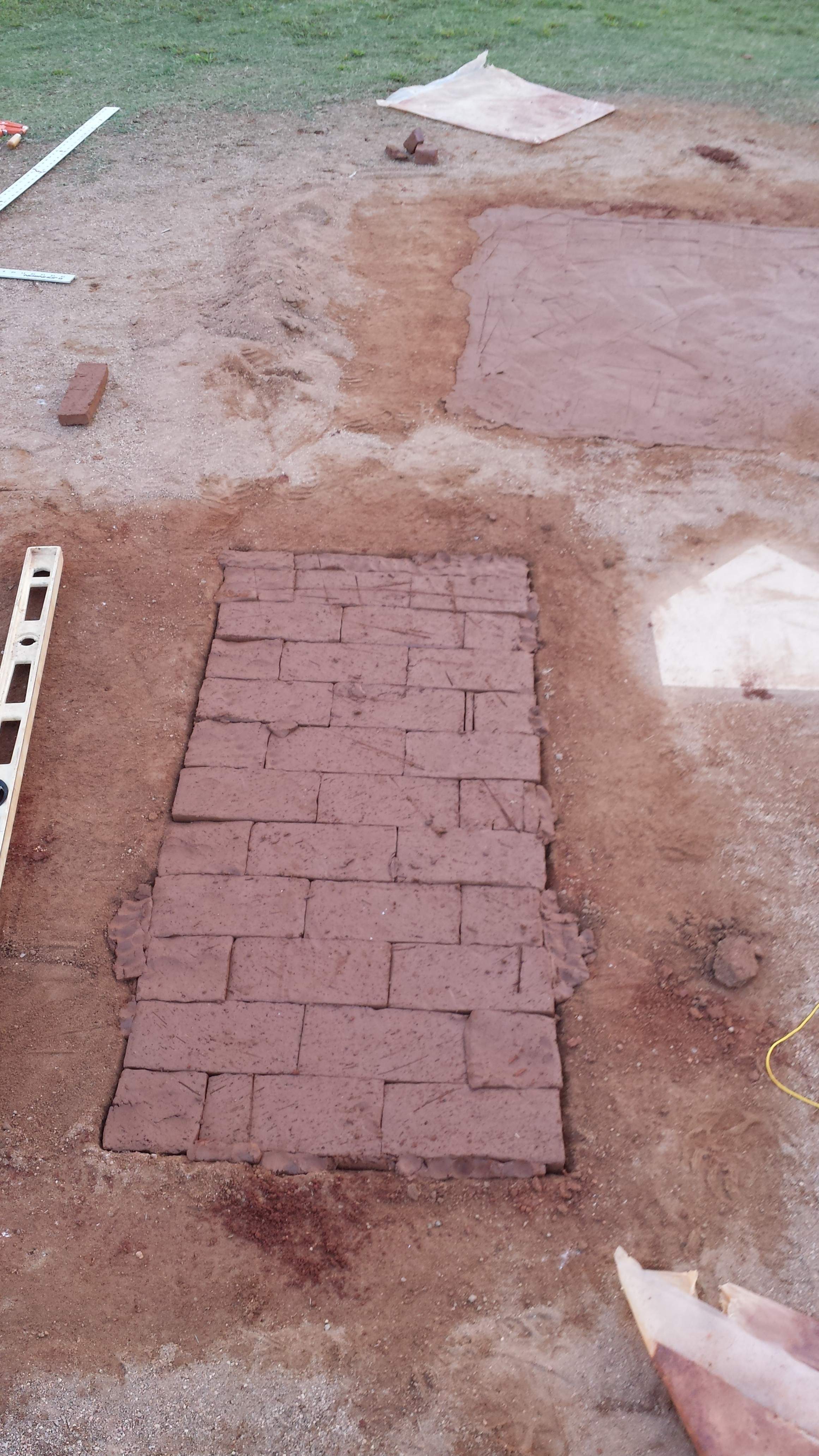

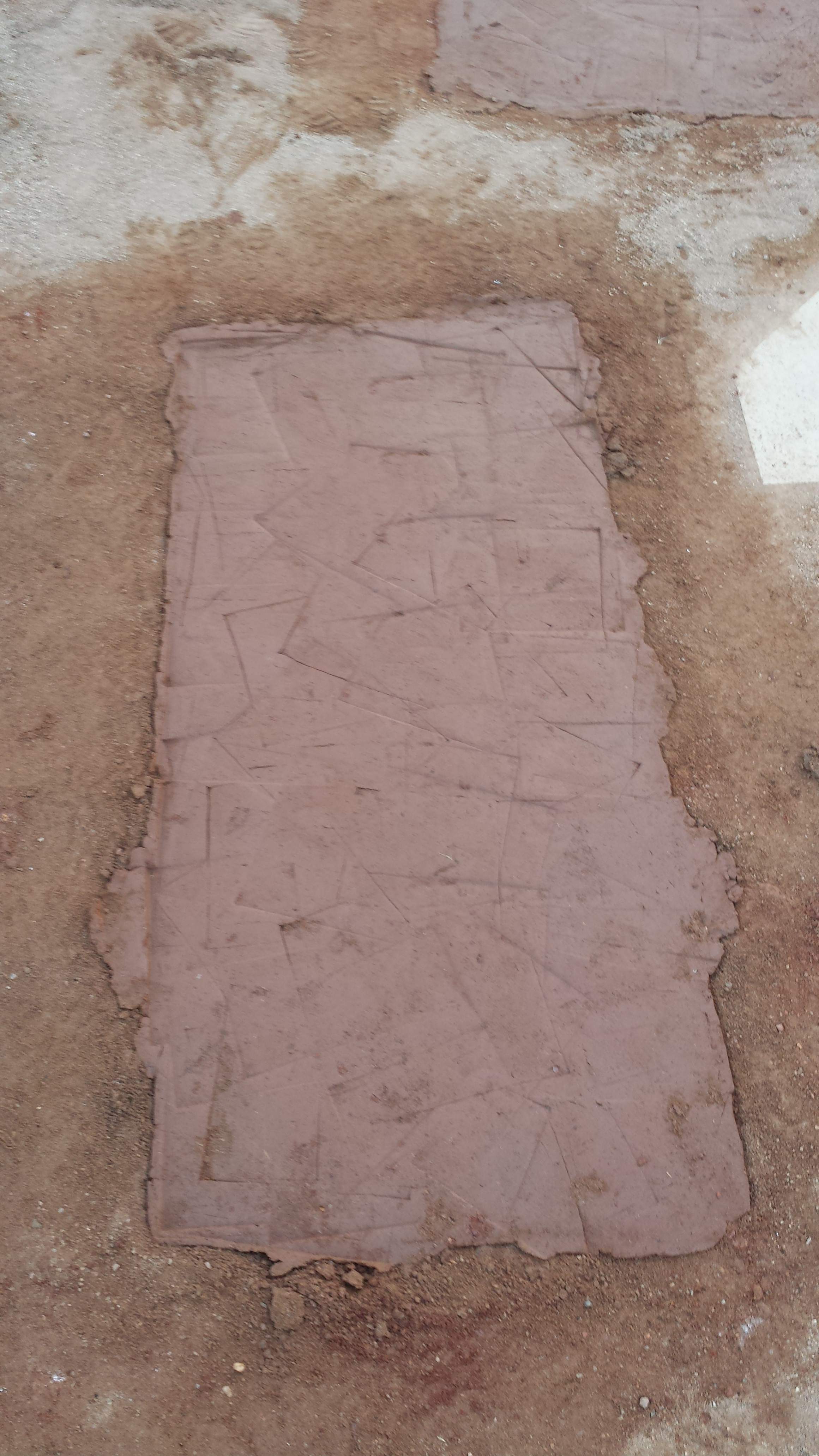

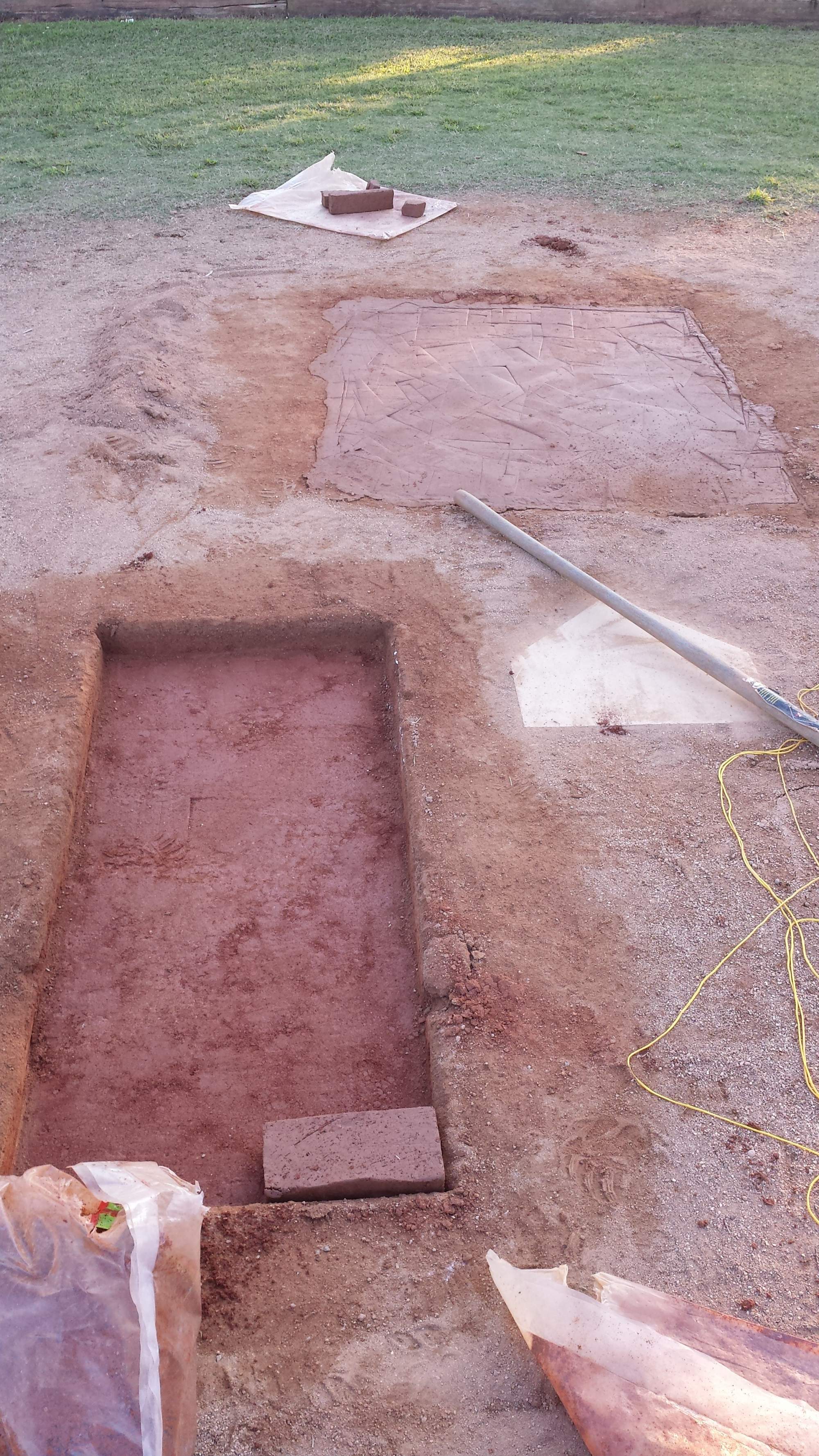

Finished up with lefty batter's box. Was not too bad at all and really didn't need it, but we had the materials, so at that point why not?

Finally finished. Now need to wait a week or so while it cures and see what the results are. I had left some of the wet bricks out even one from Friday and by Monday it was rock hard so as the other stuff cures slower under the soil, it should hold up way way way better than just the soil that it was built from originally.
Next step: Play Ball!!!
