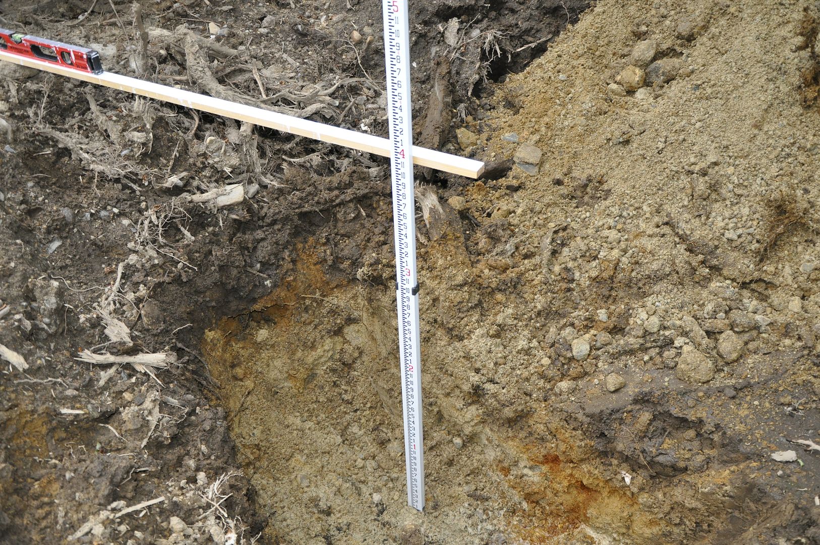

I dug a hole down to see how far I had to go to get to glacial till - what you see is a bit deceptive here because I had piled the diggings on top of the original topsoil - so there is some soil depth added on top of what the original natural grade is - but it's not that much, 6in to a foot at most where this test hole was dug
Here's another view where I put a survey stick down into the hole to give an idea of the depth I have to go down to get to glacial till. I've dug a few inches into the till in this pic - so the four feet is made up of a few inches into the till, probably a good foot or so of subsoil (it's the rusty colored brown soil) - a good foot or more of topsoil (full of roots I had just dug a rather large stump out from this area) - and then maybe 6 inches to a foot of soil I had piled on top of the topsoil from digging out the barn foundation a few years back.

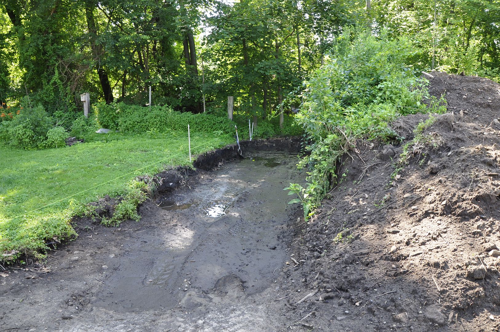

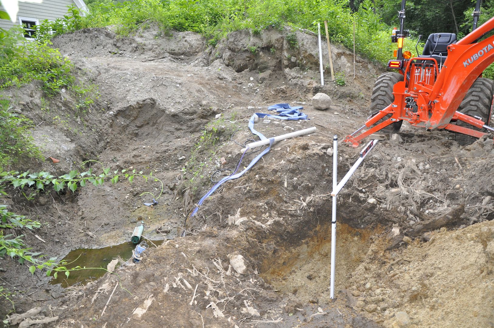

Here's the corner where I'm working on prepping to put in the lawn. The lot slopes - and I have a large pile of dirt I need to do something with - as well as a lot of topsoil I carefully stripped off when I put in my barn and a driveway a few years back. So basically what is happening here - is that I've stripped off the topsoil - I'm going to put in a retaining wall right along the property line - then I'm going to bring the grade up using the soil I dug out from the barn foundation excavation - and then pile topsoil back on top of that. Sounds like a lot of work but the way I figured it was if I leave the original topsoil and just pile dirt on top of that : I'll end up with glacial till / subsoil / deep layer of topsoil / probably at least a foot of dug up fill on top of that / then another layer of topsoil - probably at least a foot thick. I'd end up having to truck in topsoil at some point in time. I've carefully saved the topsoil in areas I've excavated because there are other areas on my lot where I need to build it up - like the front yard - where the grass grows lousy and I know a good part of the reason is because the topsoil layer is like 4 inches thick - and there's a layer of sand underneath that as fill the contractor put in many years ago when the house was built.

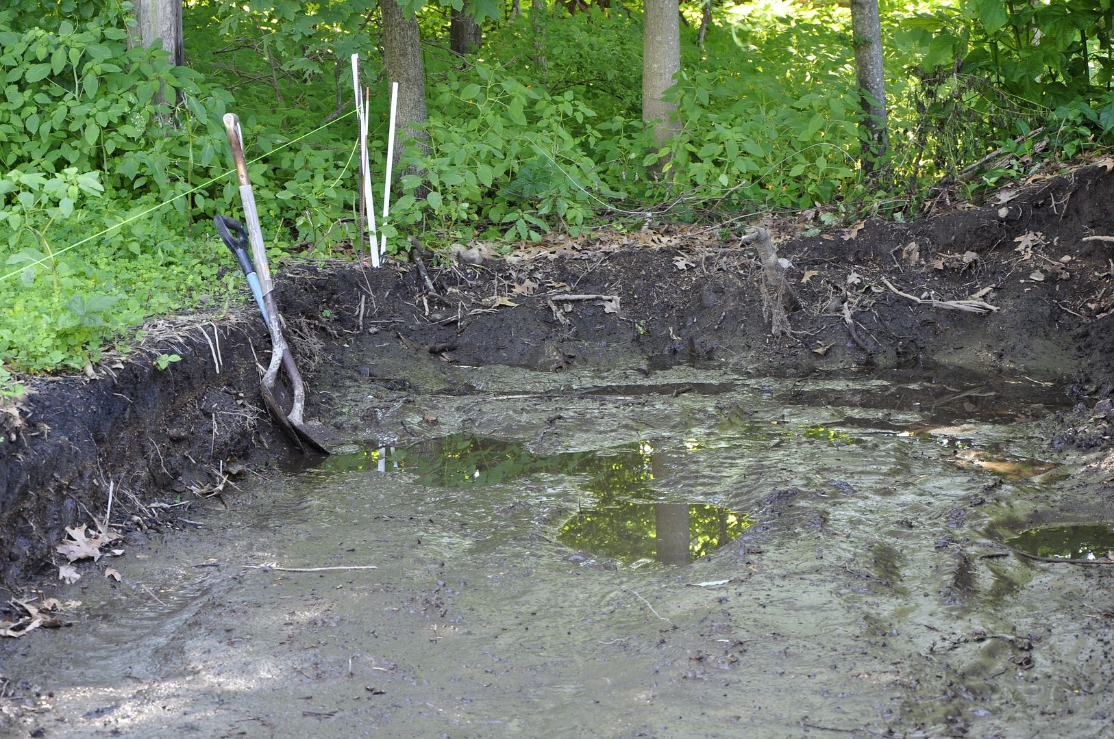

So what you see in this pic is where I've stripped off the topsoil layer to get down to the subsoil. The pic is somewhat deceptive because this entire hole was flooded pretty much right up to the top edge a couple of days ago from the big thunderstorms that came thru here. That dissolved some of the small piles of topsoil I hadn't cleared out yet - and left a layer of topsoil mud across the whole excavation - the subsoil is just an inch or two below that layer of mud. The big pile right next to excavation is all the topsoil I've stripped off from other areas of the lot.
I'm starting with this area because I need to build the retaining wall - and then fill in and bring up to grade behind it.
Here's a closer in view to give some idea of how deep the topsoil is:

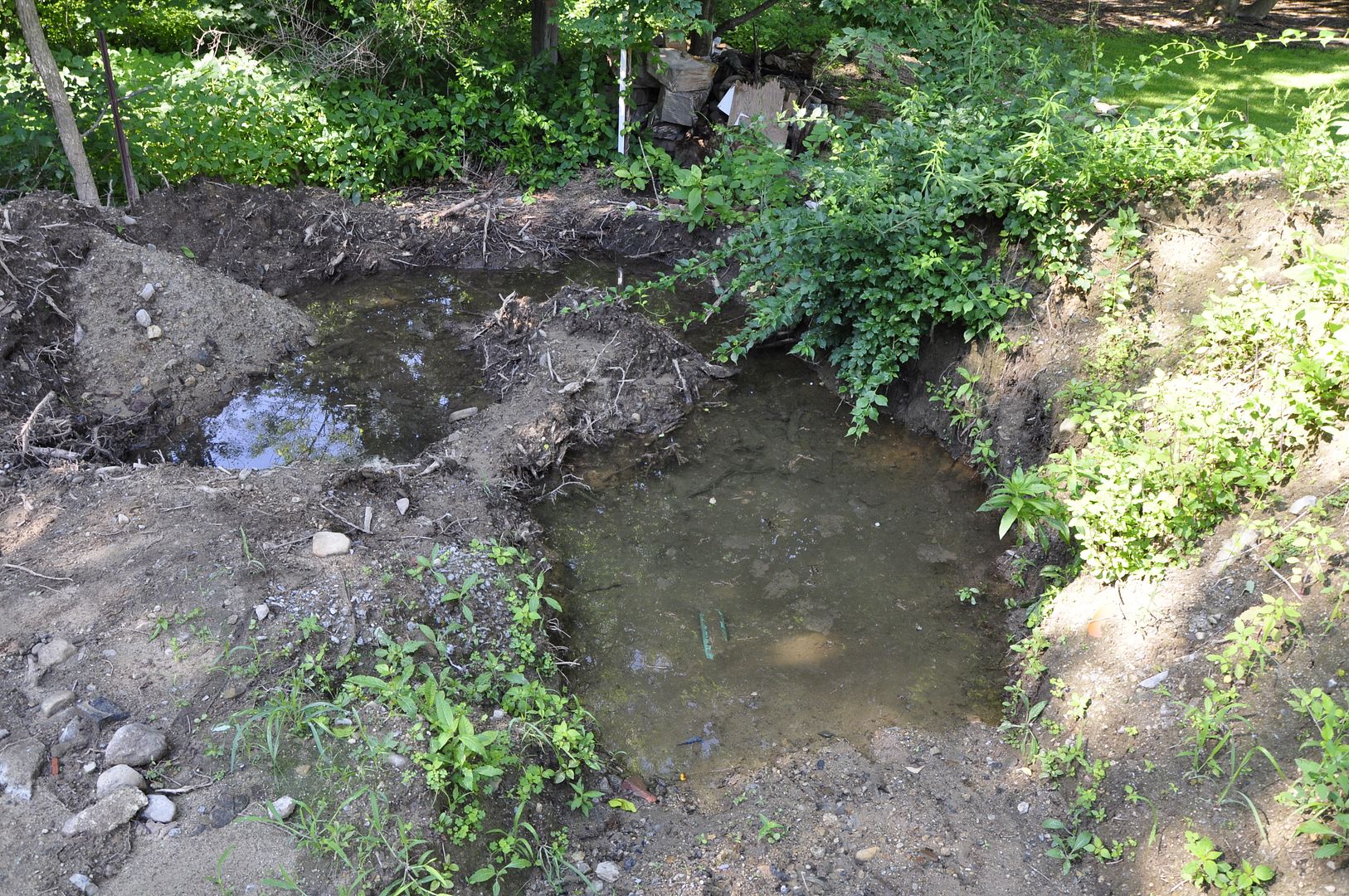

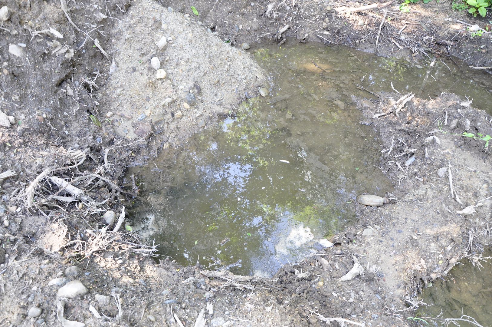

The rain this season hasn't been helping - we've been getting a lot. It floods this area out and I have to keep pumping it out and then waiting for things to dry out before I can make progress.
Here's another pic of that same area where I showed the soil depth measurement - taken this morning - we haven't gotten any rain in a good couple of days - and it's still flooded.
Here's the hole I dug to measure out the soil depth:

I would love to have 1/8 that amount of topsoil! 2-3" then its rock (many boulders too) and tannish till like you have.
From the looks of things, you must be near the river - Merrimac? in a slight valley? The reason I mention this is on out place, the black gray clay type soil is in an area of poor draining soils.
Have you thought about having a dozer in for a day or two and create several large piles then do your walls etc, then back fill and then add sand?
I agree you need drainage and by the looks of things a quite a lot of stone too - do you have an area to drain towards or into? maybe a network of pipes and a layer of 2-3" stone and sand then put down the topsoil, then till in the sand.
By the look of your soil you don't need compost, just some sand mixed in.

Actually - if anything I'm very near the peak of what is a very gradual hill. The Merrimac is a few miles from me. My understanding is that this whole area used to be a farm - in fact the remains of the old farm fence are right along my rear property line (must have been electrified because I've found some of the porcelain insulators). I have noticed that the soil in that area I showed in the pic that is filled with water - when it gets wet - actually still has sort of stink of manure, to my nose anyway. And my house has been here since the mid 1950's , so it's been at least that long since the place was a farm.
I actually think what happens here is that the water does not percolate down thru the lower level of glacial till - so when we get wet weather it saturates the soil - and basically the only way it "drains" is when the soil in the entire area "drains" out to whatever low lying area there might be. I know there are a couple of streams close to my house - so I think the water caught in the soil slowly percolates out and runs off. If we have had a dry spell for even a few weeks - then I can dig a good six feet down and it's dry. If we get wet weather - like we've been having recently - the water table is basically at ground level on the lower part of my lot where the grade evens out a little. That's why the hole I showed in those pics is filled right up to the top.
If I pump the water out of that hole - and we get a few 90 + degree days - the combination of water runoff and the heat baking all the moisture out of the ground will dry that all right out.
