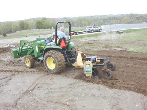

For a single 3pt tool (assumming you have the FEL with bucket) I would vote for the Harley rake (or powered rake). The attachment shows a lawn roughed by the builder, and the only attachment used was the Harley rake. After the rake, seed was broadcast and lightly hand-raked in to cover. Then watered. This was an area that had experienced hard rains and some erosion. The first pass with the Harley rake was when the soil was pretty wet, but the air dried it quickly after the first pass. Later, a second pass left a suitable bed for seeding. There are more tools that can be used, as already mentioned. But if I only had one tool, it would be the Harley rake, no question.
