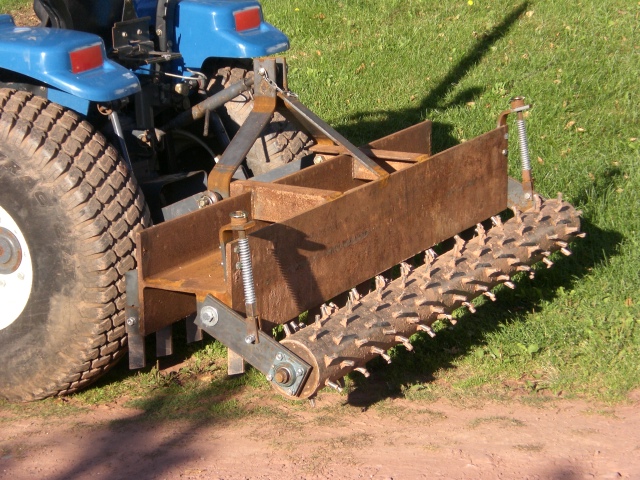

I also built my own 6' pulverisor a little while ago and have to say that I am very impressed on how well it prepares a seed bed. It only has one roller but still does a fine job of breaking up the clumps and loosening the soil after the dozer has graded the yard. I would love to have a harley rake but it's hard to justify 9000$ CAN on one of thouse when my 300$ pulverisor can do just as good of job (taking a little longer mind you). I am now also in the process of attaching a seed box to my pulverisor making it a 2 in 1 pulverisor / seeder, saving me time and money on the jobsites.

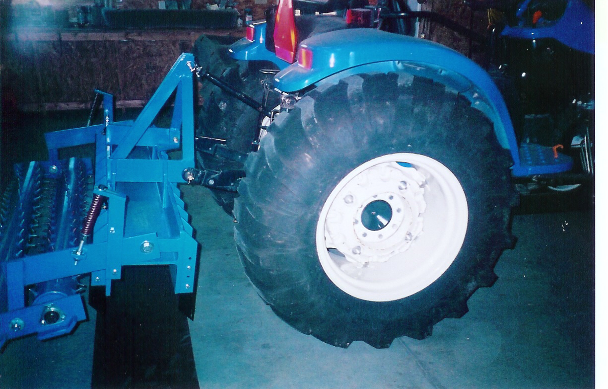

This is a picture of the pulversor that my son and I built 3 years ago.
   / Soil Pulverisor #15
One more time to attach picture. I'm knew at this so bear with me.

That's a great looking piece of machinery
Interested in buidling one for sale ? That thing looks AWESOME !
Very nice!
Just curious - did you have to buy the rollers the way they are, or did you fabricate them somehow?
