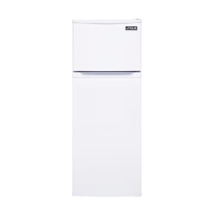

The fridge is a 3.1 cu ft. mini and advertises .87A draw. As you mentioned it's iffy considering that I use LED lights and a 12V water pump for a 15 minute shower every night. Due to frozen pipes I winterize and leave every Dec 10th or so and would unplug the fridge.

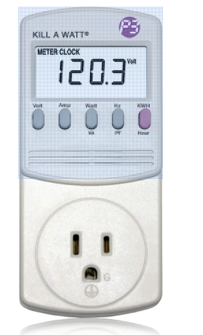

To be honest you will not know till you try. There is a loss when going through the AC to DC inverter. You will need to factor in that loss.
I would also invest in this thing called a Killawatt
This will tell you just what your appliance is actually pulling in the real world. They are pretty inexpensive.
