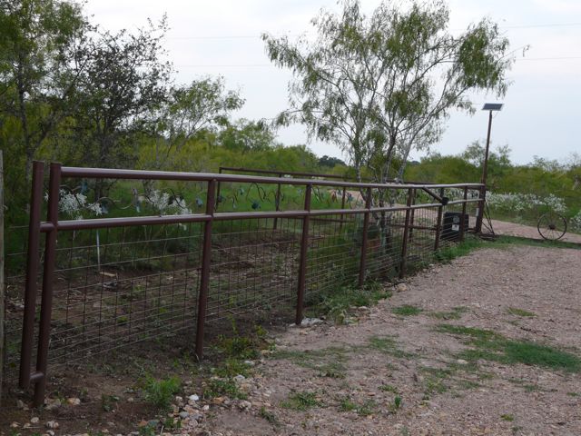

I have a solar charged battery operated Patriot gate opener. No problems for 3 years so far - same battery! We have had a week of no sun in the winter and this summer we are now on our 41st day of triple digits.

Thanks TXDon, are you using a marine battery or the little battery?

We used a heavy plastic storage container for a battery box, we had two deep cycle batteries if I remember right. You can find them with metal latches. A hole drilled a few inches from the bottom and sealed to keep moisture and critters out for the cable to run. If you wanted to you could screw it down to some 4x4's to raise it up off the ground even.
If you can fabricate some brackets you could mount it to a pole if you wanted. I am wondering if a tool box or something similar would hold your battery?
That's what I have been thinking for the "farm" gate. The other 2 gates are at the ends of driveways that need to look nicer. I'm going to need something that looks good until we can get the area landscaped to soften the area around the battery box.
Universal Battery UB12750 (12V, 75AH) Battery
Harvey brought it when we installed the gate.
Notice the keypad on the the top fence rail and the solar panel install on an extended last post.
