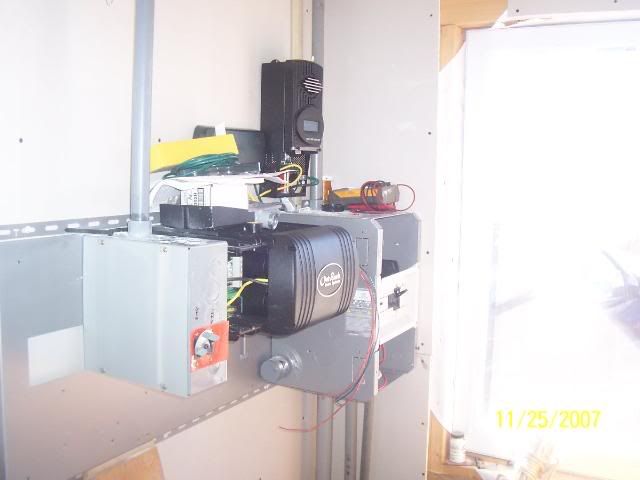

I was waiting for rob to post on his thread so here is little bit I got done.
I got the inventor, manual bypass, and braker panel in.
The meters are in too to monitor battery and charge controller and inverter
We wanted to test it last night we watched tv and had it on for about 7 hrs my wife vacuumed for about an hour and battery s were at a little over 80%.
