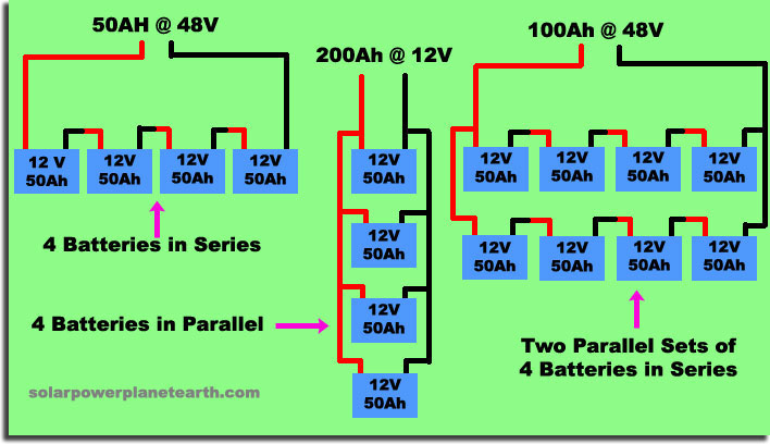

Here's an illustration I found that explains series connections, parallel connections, and series/parallel connections. It's pretty helpful...
