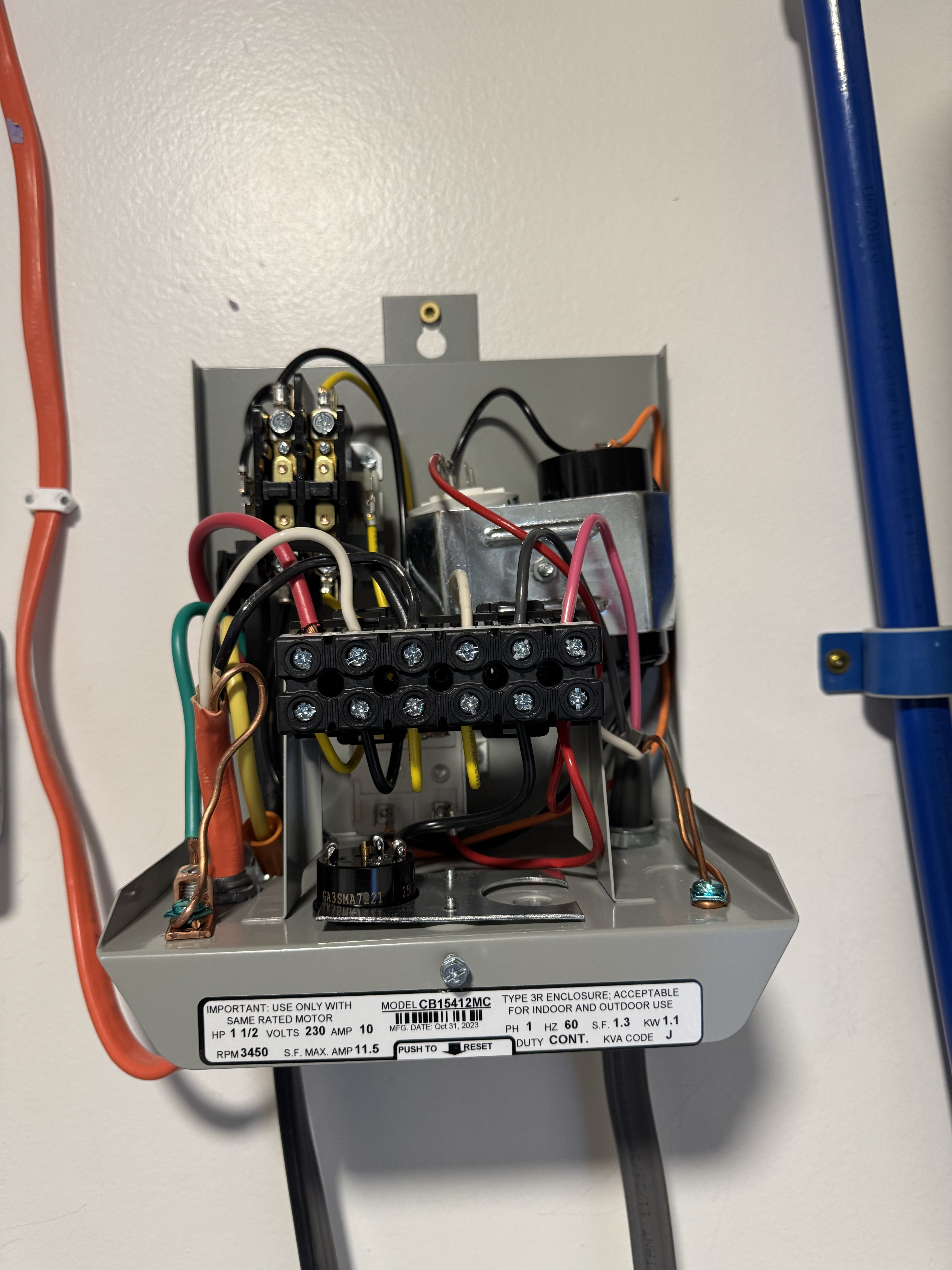

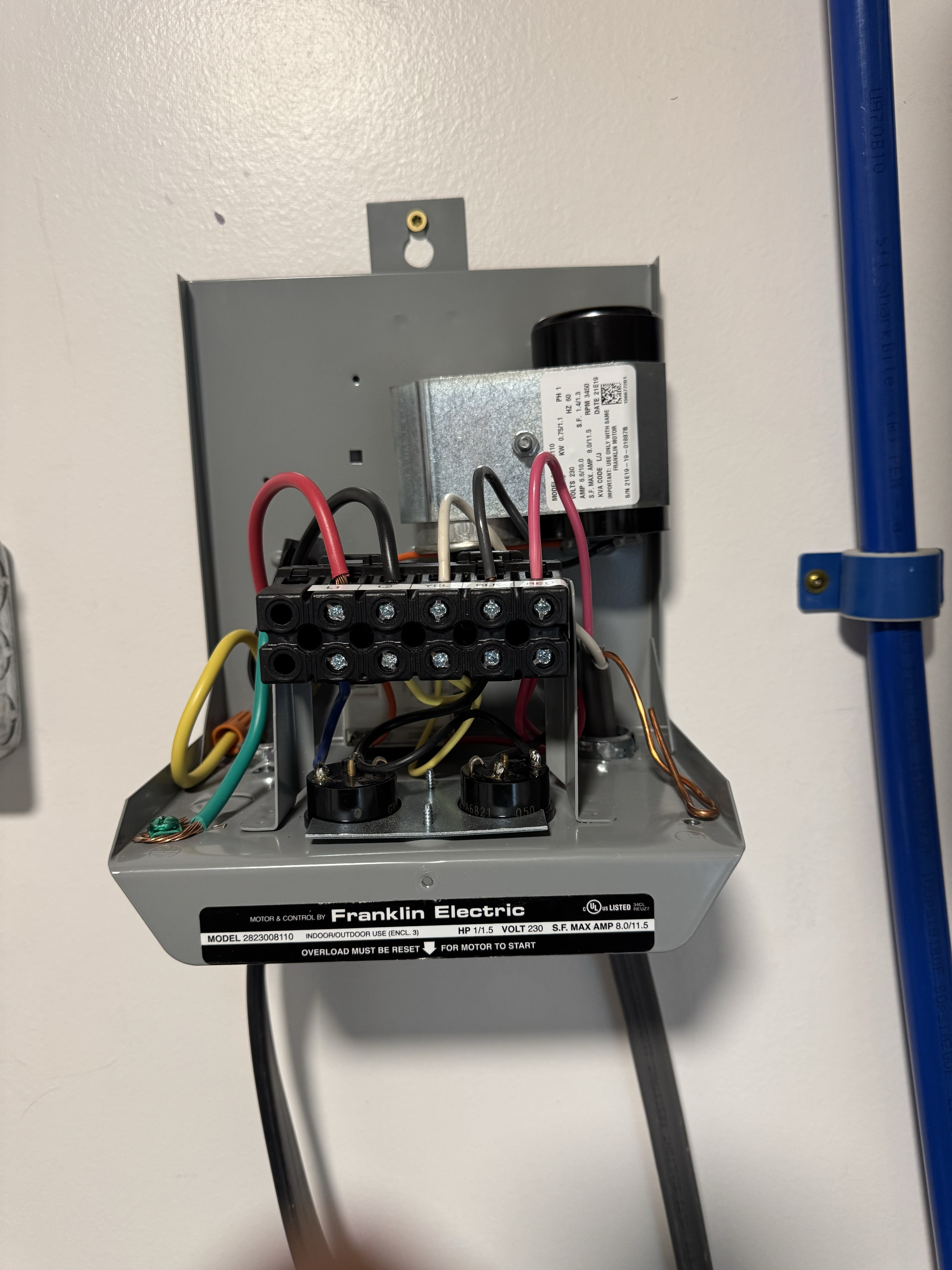

I didn’t replace any components.
I replaced the entire box. This is a brand new Goulds xylem brand control box that I bought yesterday as replacement. The control box is 1 1/2 hp, 1Ph, 60hz, 230v MC control box
My power is single phase.
It replaced a similar franklin electric control box, but this one has the magnetic control switch. Previously I had it wired with 240 v to pressure switch and then to control box. Then to pump.
This “deluxe” box is wired 240 to the control box with a switch wire and an L 2 wire to the pressure switch. The three wires for the pump come off the control box.
L1 and L2 going from breaker to control box read 246. The power coming off the control box going to the pump was reading 375. I will check each leg coming off breaker individually later today. (I’m laying in bed awake at 430).
I will also run ohm check on the legs of the pump wire.

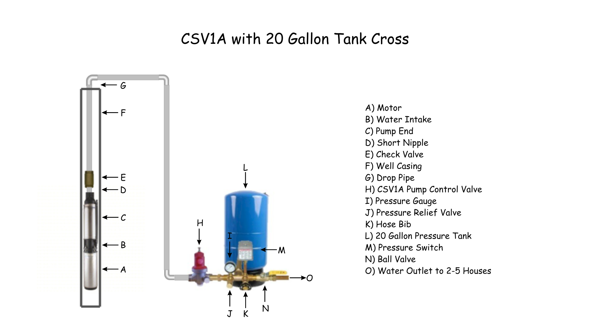

I do have a csv cycle stop valve in the line from pump to surface.

That control box and motor are "capacitor run". I.E. the auxilary winding (red wire/start winding) is energized even after the motor starts.
The magnetic switch means there is now no load at the pressure switch, it just energizes the magnetic switch. Better. I'm perplexed that you have high voltage on the red wire, but the capacitor could be upping the voltage. Not sure I've ever checked voltage there.
If you can get your hands on an amp meter, yellow should be about 11.5 amps, black about 11 amps and red about 1.3 amps.

The lightning was just a coincidence. The pump tripped the overload because the start cap was bad. The start cap and relay are not even in the circuit after the pump is started or when the pump is off. So, lightning does not take out start caps and relay. Lightning will blow a hole in the side of of the motor or blow the wires into, but not make the start cap fail. The high voltage after the control box is from the running capacitor, which is common on 1.5HP or larger.
I knew you did not have a VFD because if you had even heard thunder from afar, the VFD would have failed. There is no overload to reset on a VFD. When they get hit or just quit a new VFD controller is needed for $1200 to $5K, which is exactly why pump companies push VFD's.
VFD controls require frequent and costly replacements. Pumps without a CSV cycle themselves to death. A failed start cap, pressure switch, tank diaphragm, or check valve is a sign the pump is cycling on and off too much and will have a short life. Pumps controlled by a Cycle Stop Valve last for decades without any maintenance, which is exactly why pump companies try there best to talk you out of one. :)

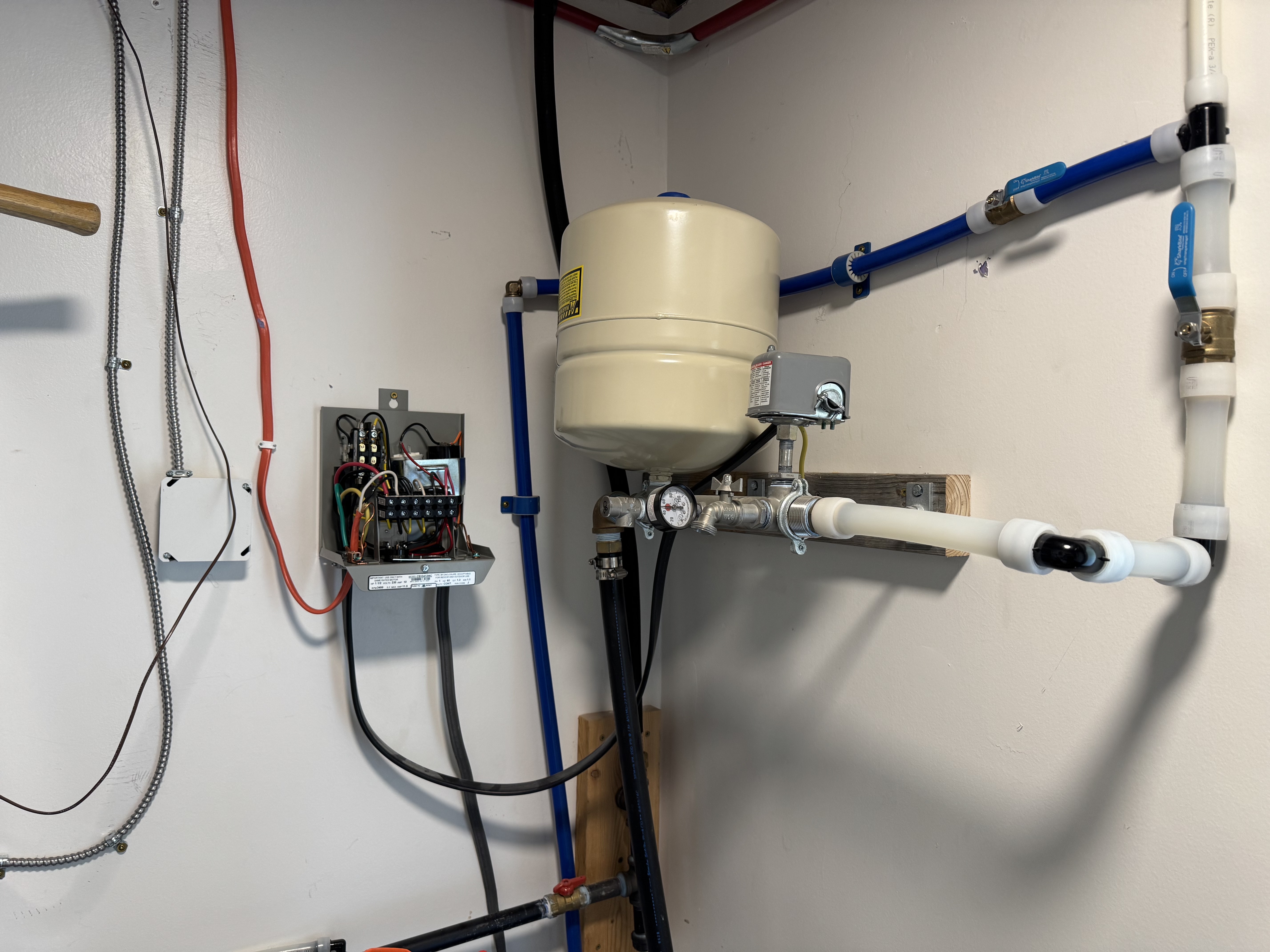

I turned off the breaker and pulled the pump wires and tested each leg for ohms. Nothing over 0. Put it back together. Incoming voltage to box, L1 is 123v and L2 is 123 v. turn the water on and when them pump starts, its 360 going out. It built to 370 and then the tank reached 70psi and turned off till it dropped down to 50. Then it repeated. When I have two faucets open at once, the pressure stabilizes at 64 psi and it just runs continuously and that was when I had a reading of 375
It’s a cyclestop csv125. I put it in when I installed the well pump in March 2022. I guess the control box is working the way it is supposed to and the capacitors is just accelerating the voltage. Had I not tested the outgoing voltage, I wouldn’t even question it. This is the setup. For my tank, and the CSV is about 3.5 feet below my pitless adapter in the well.
370V is normal on the run cap leg. You should not have needed a new start cap if the CSV and check valve are working properly. You say it repeats from 50 to 70, but is that with a tap open or closed? The CSV should keep the pump running continuously with two, or even just one faucet running. If the pump runs continuously while a shower's worth of water is being used, the CSV is working. If the pump is repeating the 50 to 70 when no taps are open the check valve on the pump has failed. A failed check valve, Cycle Stop Valve, or sometimes the pressure tank can cause the start cap to fail. Be glad to help.

David, glad you solved this - but suggest you get a replacement capacitor and keep that one as a spare in the event this occurs again.
Also, there is no question that the CSV extends pump life by keeping the pump running while drawing water. But I think the best combination is the CSV and a larger bladder tank, so you get 8-10 gallons of drawdown, then the pump turns on and runs until there is no more demand.
Case in point, a dishwasher, or clothes washer, pulls a few gallons then runs its cycle, or you turn on the sink, flush the toilet, and the pump runs in your current setup, then turns off once demand is met.
If you increased your storage capacity (larger bladder tank), this would reduce the "starts" which ultimately is the goal is to minimize the starts prolonging pump life, so adding storage capacity, along with a CSV would achieve that,
You can easily add one in series with your current tank - they are 14-18" diameter, and 3-5' tall so could fit in the corner below your current tank - if I recall your plumbing room accurately.

Which line are you seeing 375 volts on?
And, valveman is right, if your pump is cycling with a csv, there is something wrong with it.

Agreed - but David's statements are " It built to 370 and then the tank reached 70psi and turned off till it dropped down to 50.It built to 370 and then the tank reached 70psi and turned off till it dropped down to 50. Then it repeated. When I have two faucets open at once, the pressure stabilizes at 64 psi and it just runs continuously
"Then it repeated" is a problem if there is NO demand from the house - turn off the house and if it leaks down you have an issue in the well check valve.
"When I have two faucets open at once, the pressure stabilizes at 64 psi and it just runs continuously" This is normal operation for the CSV and the pump should stay running with minimal demand.
/ Lightning strike, well pump box failed #17
Ideally, you want a minimum run time of at least 1 minute for best pump life, so a pump at 10 GPM, would dictate 10 gallon "reserve" to fill before it starts again. Otherwise, every time you draw a gallon or two, the pump cycles on and off.
It only runs continuously without cycling when the demand is present e.g for irrigation, but that's not typical household use.

I think The check valve is good. It only cycles when a faucet is open. I moved in may of 23. The cycling was pretty fast. Shower on the other side of house would cycle every 9 seconds. The same thing happened when using yard hydrants outside to run a sprinkler. I wrote to support and they helped me adjust the pressure switch higher so that it cycled slower. It was a 60 psi switch and increasing to 70 slowed it down.
I am watching it right now. With kitchen faucet open and on cold, I’m running 69 psi and steady. No cycles. Bathroom sink doesn’t flow that fast so with just the bathroom sink open on cold, it cycles on for 23 seconds. Hot water will always be faster because the hot doesn’t flow as fast. There is a spin filter on the hot which restricts the flow as well as the boiler itself. I need to put a larger spin filter on the whole thing because I’m seeing some sediment in the toilet tanks and a few aerators on the faucets.
But the point is the check valve is solid. I think my pressure is just so high, that it overwhelms the csv and short cycles
