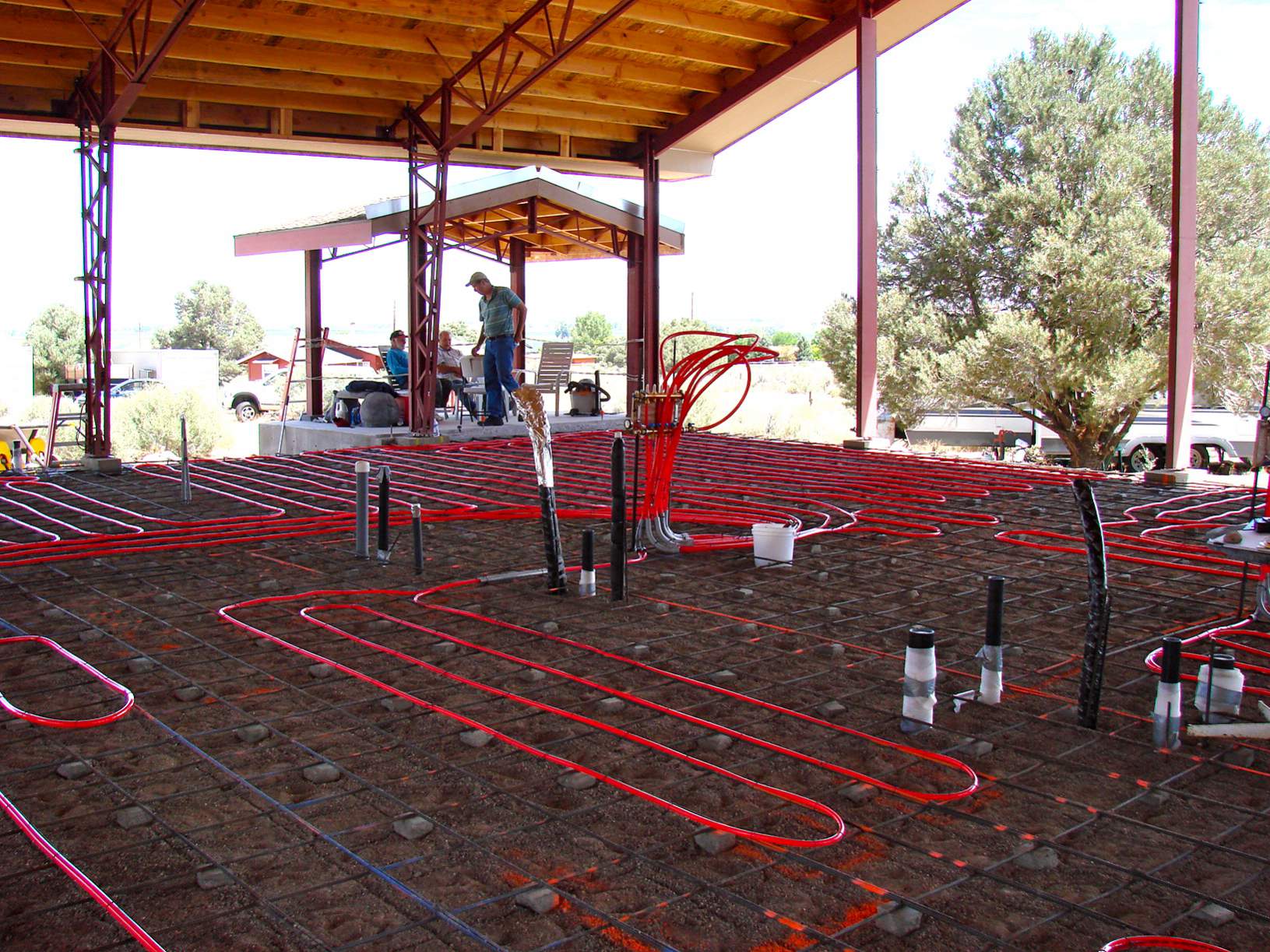

Here's a few pix of the house and the radiant layout. It's a steel frame house and the roof went on before the interior slab or any walls.

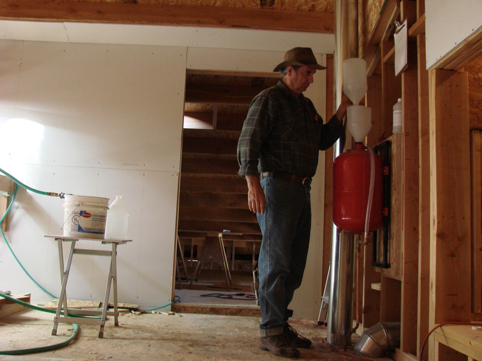

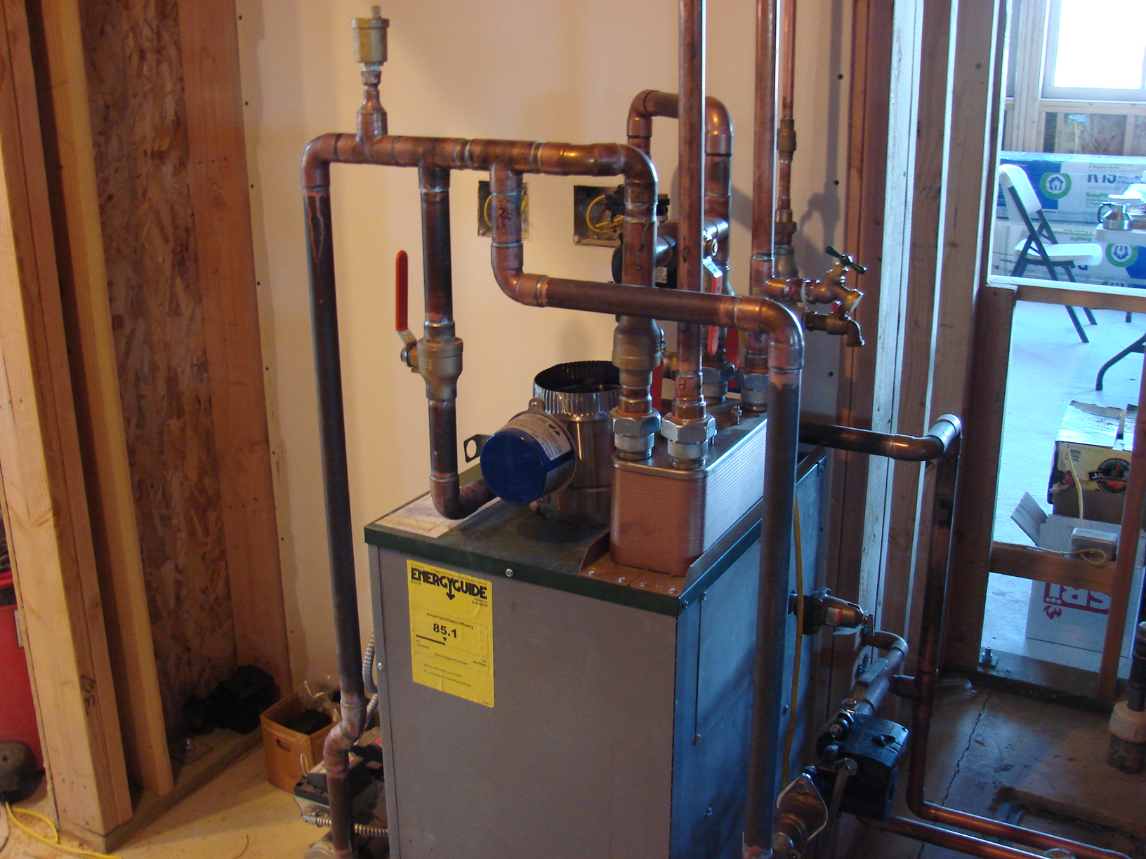

Here are three pics from today. One is me adding water to the radiant system, it's not connected to pressure water and must be filled from the top. I used a Harbor Freight sand blast tank for my expansion tank and set it up on the second floor, just unscrew the top and pour in the water. The manifold is one of three located around the house. The boiler pic shows the heat exchanger sitting on top. It exchanges energy from the solar loop to the floor loop. The solar also keeps the boiler warm so I added a vent damper to keep it from drafting out the top and wasting heat. The vent is not hooked up because we are running solar only for now.
Today I fired up the solar panels and began delivering heat to the floor. It's fun to finally get things working.

Looks great. Maybe things are different out west but you didn't have to put high density foam under the rebar?

We don't have to put insulation under the slab. I put it around the perimeter and held the heat back from the edges. I contend that insulation below the slab, in dry conditions adds no efficiency. Also, under slab insulation must be good enough to support the concrete for the life of the house.
There is no path for heat to escape down. Only conduction for a ways, which increases the affective mass. Insulation only slows this process. Lower mass slabs, with higher BTU delivery, can be programmed to have large temperature swings, but this one uses the slab for storage and is designed to be more steady. The higher the insulation value in the rest of the house, the lower the slab temp must be to achieve comfort. Insulation in the envelop really pays off.

The boiler is a 400 pound cast iron unit set in the laundry room. Every time there is a call for oil heat it must be warmed up. So I included it in the solar loop. It becomes part of the solar storage and is warm and waiting if needed. It's waste heat is what keeps the laundry room warm. This is an old fashioned boiler. But by adding solar pre-heat, a vent damper, oversizing the boiler itself while undersizing the burner, I have raised it's efficiency to well over 85% while keeping it a very simple and reliable design that only runs when the solar is not enough.
