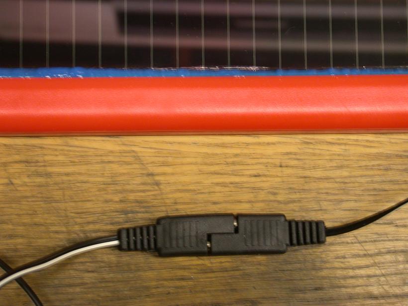

This attachment is a close up of the clip on the solar panel wires. Just pull it apart.
You might want to use aligator clips to hook to your battery and wires that plug into the solar panel cord and not get the 12v adaptor all.

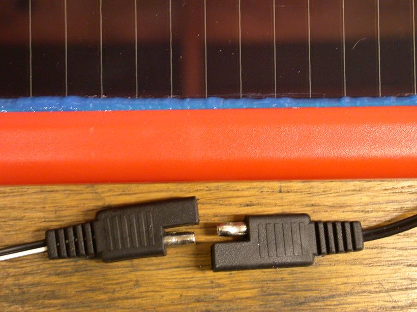

Here is a close up of the plug on the solar panel cord disconnected. It should be easy to make a cord long enough to reach your ATV and plug into this.
