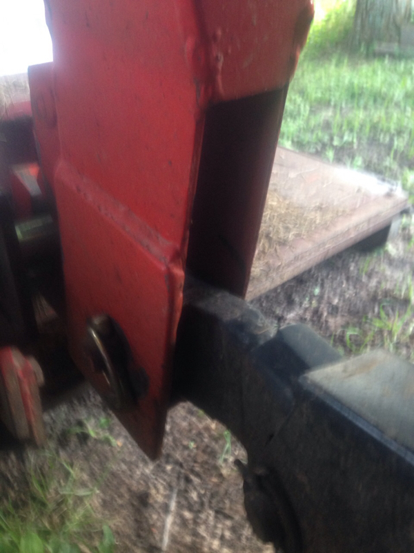

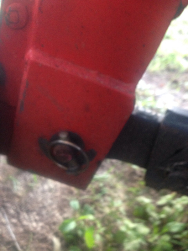

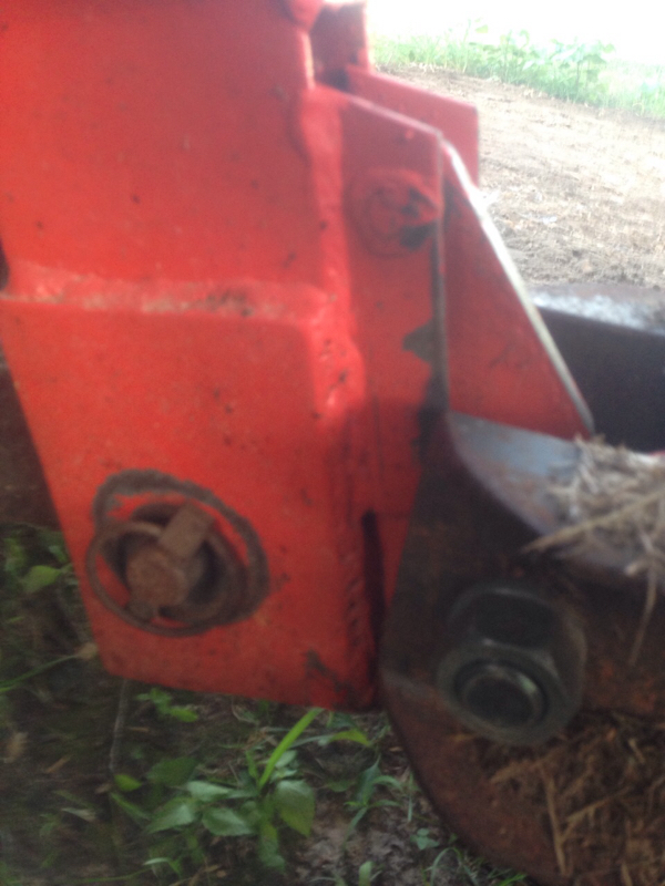

On mine I needed about a 1/8" wider to fit over the cat 2 eyes, so I cut out the inside of the quick hitch on both sides, about a 4x5 inch piece. I then took some 3/16 X 4" wide flat stock and cut it just a bit longer than the piece I cut out, drilled a new 7/8 hole in line for the lift pin. I then laid it on the outside of the quick hitch and welded it in place, this spaced it out just enough so the link eyes would fit. Then just use a cat 2 to cat 1 lift arm bushing in the eye and install the cat 1 lift pins back in.

Thank you countrybumpkin for taking the time to post, closest dealer to me is about hour 1/2 from me and will call tomorrow. Hopefully is inexpensive swap, if not I have very good welder few minutes from me. I took a bunch of pics and few videos and will upload this evening. I thought it might help perspective buyers to see the cab etc. Also have a few videos to upload as well of removing trees.

Have you contacted your dealer to see if the link ends from aNX with cat 1 will fit your arms? If they will your looking at roughly 160 dollars for the pair. You could also modify your imatch quick hitch to fit your arms. I didn't take any pics of mine when I modified it but I can get some of the finished mod if you like.
I just got New ends for the 3 pt hitch to put my imatch on the Kioti. You can keep the old ends in case you ever really need a Cat II, but I'm like you, everything I use fits the imatch. (I tried a generic 'imatch' and they don't work as well) so I kept my imatch which fits more implements much better due to the top piece being thinner than the generic ones, which prohibits it from fitting some implements, such as a power tiller.
