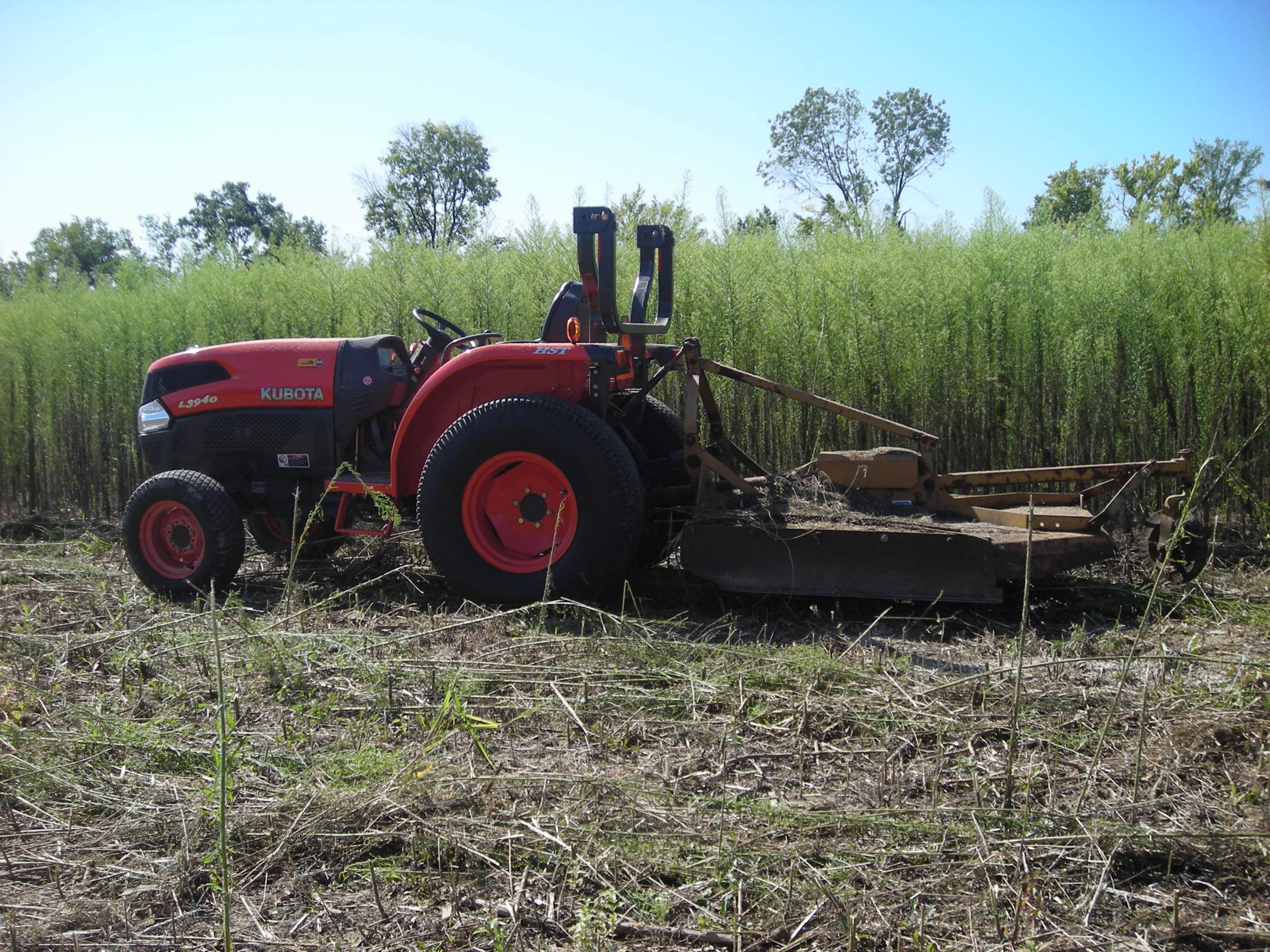

Mine would clog about every 1 hour bush hogging in this stuff. I would let it run up to 7 bars, then disconnect pto. By the time I got back to barn (little load on engine), bars would be down to 5 or 6. Clean screen, then go back at it again. Pusher fan is no good, would just clog back side where there is no screen. Pusher fan will also heat up faster because it will pick up heat off of engine and muffler. Philip.
