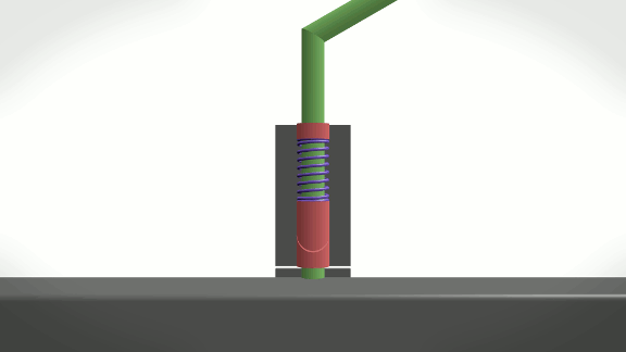

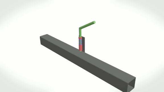

Nice work. I really like that manure fork, could you post more pictures of the trip mechanism.
I'm making some decent plans of it, keep a little patience ;)
