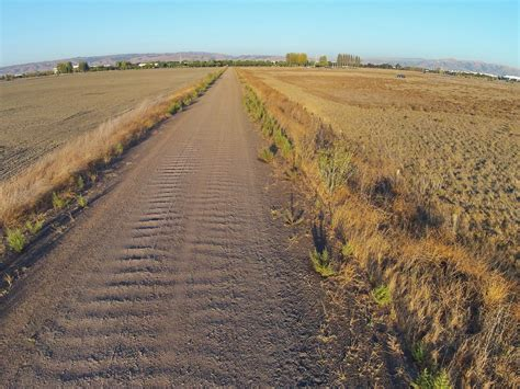

Water bars.
We called them washer boards where I grew up. They resemble the old washer board grandma used to wash her clothes.
   / Some basic box blade questions #46
The term "water bars" generally refer to narrow raised berms etc to direct storm water off a road r into a ditch or culvert....sort of the opposite of a swale...
The wash boarding shown in the pic is likely caused by vehicle suspensions...
   / Some basic box blade questions #47
View attachment 706838 We called them washer boards where I grew up. They resemble the old washer board grandma used to wash her clothes.
Yea, we’re taking about two different things here. Wash boards roads don’t allow water run off, water bars are cut specially on a gravel road to disperse water to the sides.
   / Some basic box blade questions #48
Thanks! That is why I included the picture. Sometimes things are just regional slang, other times, like this one, I learn new things!!!
