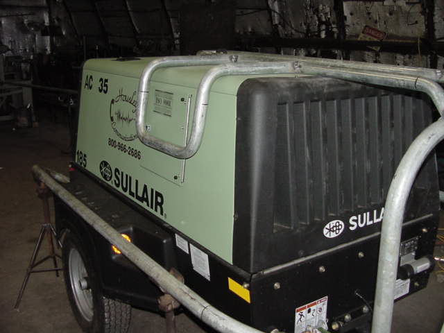

On occasion I get to take on a project that's challenging enough to be fun. It's a fact of life that when the challenge escalates to a certain point it's no longer work.
I guess it's maybe kinda sorta like that silly giggle you get when you're down as far as you can get and life gives you a boot in the butt. /forums/images/graemlins/grin.gif
I agreed to do a cage for a compressor. The compressor is a brand new Sullair 185. It's tricker'n just about anything. This puppy kicks. It's quiet and kicks butt.
On construction sites compressors don't get much respect. One doesn't get proprietary about a compressor like one can get about a tractor. And since no one really gets protective they catch quite a bit of abuse.
They're also part of that elite mechanical group that's impossible to back up with anything bigger than a compact car. So they get jacknifed often. A lot of times a backhoe will have it's boom put over the compressor to keep it from getting stolen or even just borrowed on the job site.
One of the sad things about equipment is when they get a couple of hickeys they get even less respect. Where workers might be a little more careful with a new or really clean machine they won't with one that's obviously been abused.
It's not in the manufacturers interest to build a lot of extra protection into the equipment. There's the fact that the price increase initially will put them out of the bidding. And face it, parts are a good business.
So I need to build a cage for a the compressor that will protect it from being damaged while being backed up. That means all four corners and the rear. I also need to have some protection for the top for when that rookie with the hoe gets too enthusiastic securing it in place.

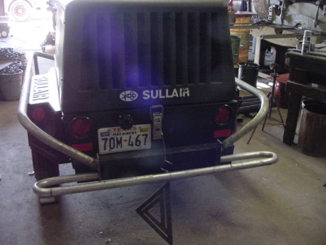

I didn't mention that the unit lifts up from the rear and I wanted to have the cage part of the security for the control panel?
I should have. /forums/images/graemlins/grin.gif

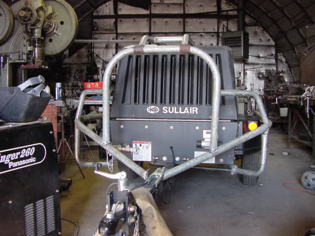

Here's the front view with almost all of it in place. I say almost because the more one thinks about a project the more involved it can get.

It'll be finished tomorrow.
I'll post some pictures of the done deed then.

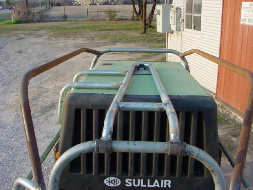

I built this at Fannin Fabrication. It was some fun working with Clyde and R.L. Clyde's older'n dirt and has forgotten more than the rest of will ever know. R.L. is just plain dangerous. He doesn't say much if anything at all. But he's one of the sharpest tacks in the box and always seems to be able to figure out what the crux of the problem really is.
This project is a good example of building something and learning not only what you want but what you don't want in the next version.
It's a little overbuilt, character flaw, but we've got it figured out where we can get the same results with less pipe and fewer bends and welds.
Working with bent pipe is fun because it's challenging. Anything you do to make one end fit better has an effect on the other end plus it messes with the middle too. I like it because being lucky is just as important as being good.

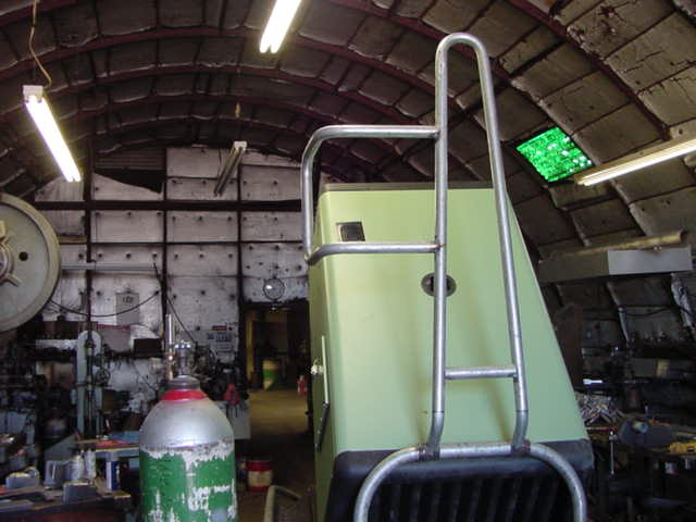

North end of the south bound.
   / Some boys just want to have fun
The manufacturer designed this as a lifting eye. I decided it needed to multitask to justify it's existance. So it's now a padlock receptacle too. /forums/images/graemlins/grin.gif
