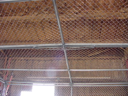

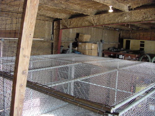

#12
I thought I'd show you the top view first. And for a good reason. I'm having a little trouble with double vision. /forums/images/graemlins/crazy.gif
This thing is sixteen by sixteen by eight. The framework is inch and a half galvanized (1 7/8") schedule forty pipe. The fabric is nine gauge chainlink.
We, company had two laborers and a supervisor come in today to help me install it. We had the three sides up and were adjusting the two covering panels. I had them attached to each other but not to the sides.
As we were squaring the the roof with the sides someone put a little too much into it. I happened to be the dummy inside with a two by four when the top panels came down.
There was a split second I'm sure when I held the roof panel unit up. It wasn't a long split second. The next thing I knew was the bad words were everywhere and I was getting up off the floor with the framework on top of me. It was not a pretty site.
The laborers were frozen in their tracks. The supervisor was trying to figure out how to help me without climbing on top of me.
I got out, sipped some coffee, figured out what I'd done wrong, and then we got it back up and bolted in place.
I hurt all over more'n anywhere else. This double vision thing is inconvenient besides being worrisome.
Anyway........
You'd figure a sixteen foot by eight foot overhead panel would sag.
This one doesn't. /forums/images/graemlins/grin.gif

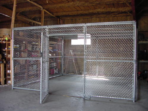

#13
Here it is with the gate open.

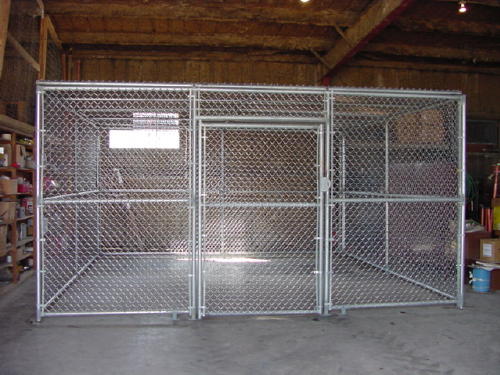

#14
The gate closed.
This was one of those fun projects I seem to always find.
Today's my father's seventy eighth birthday.
This week as I built this thing, six panels, I felt close to him even though he's in Arizona doing some fun project, genetic thing I guess.
When I was a young man working at the phone company, going to school burning up VA education money, and trying to start a family he worked for a fence company as their gate man. He worked five and a half days a week.
So invariably on Saturday about noon I'd show up with a project I'd cut out and had ready to weld up. It was on one of those Saturdays when he utterd those famous words fathers do to their sons. "Boy I think it's time you learned to weld."
But I'd show up there and he'd be covering a gate with fabric or cutting one out. I didn't realize it at the moments but I was taking notes.
So as I built these panels and the hands got busy the mind got to walk back through time and visit with my father as we built stuff.
It was a good week.
Some people get to have all the fun. /forums/images/graemlins/grin.gif
