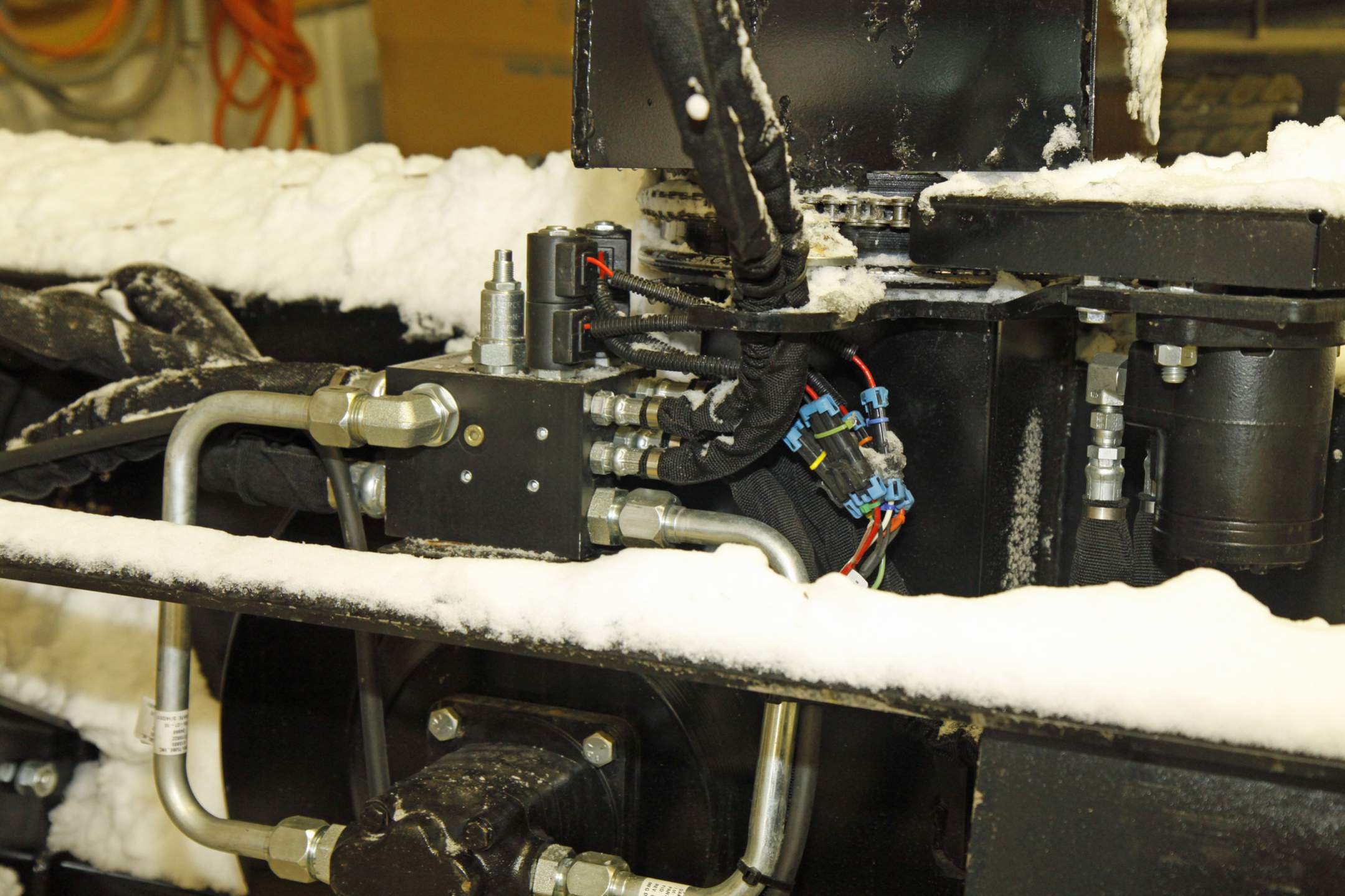

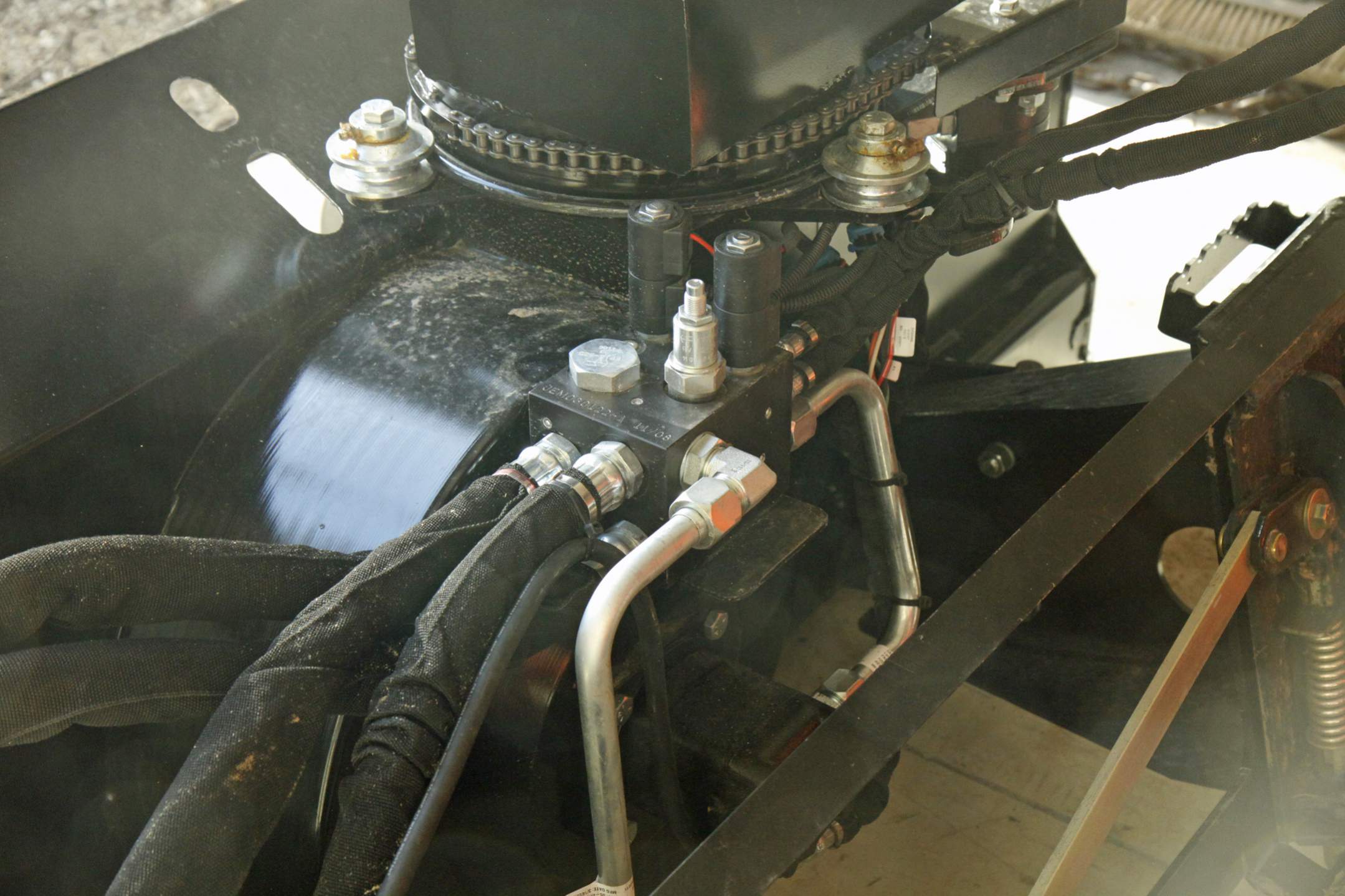

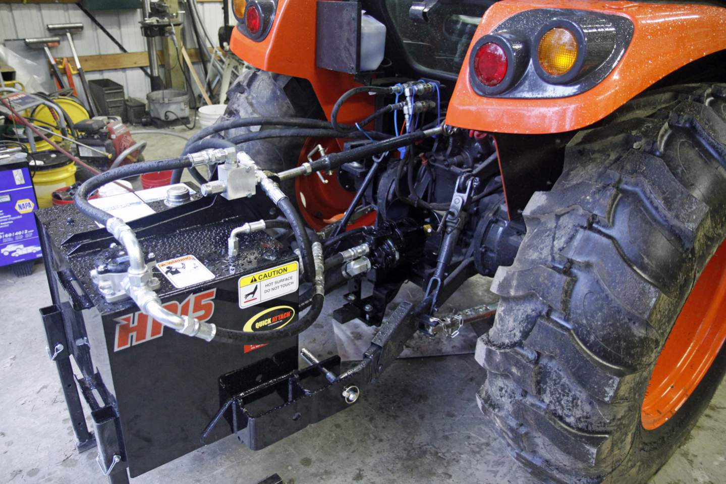

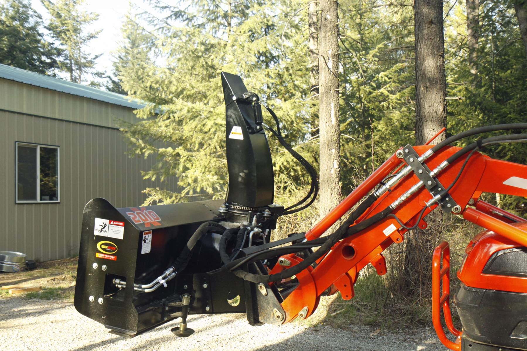

Nice set up in that cushy cab. How do those blowers work hydraulically? A independant hydraulic pump that mounts on the PTO, or (continuous flow) hose connections to the tractor? Are chute rotate and spout "cap" adjustment hydraulic too? How are they connected/valved?
it has a set of 1" hoses that go to a rear mounted hydraulic reservoir (25 gallon) and a 3000 PSI , 15 GPM pto powered pump.
All i do is flip the rocker switch that engages my pto, and im blowing snow.
The chute rotation and spout are controlled by a set of switches that hook onto the bucket joystick. They are an electric over hydraulic control system that came with the blower. By pressing one button, the electric solenoid opens and allows hydraulic fluid to move the cylinder.
here are a few pics

NO SHEAR PINS....NONE

Glad you put that picture of the FEL joystick attachment. Now I understand "The chute rotation and spout are controlled by a set of switches that hook onto the bucket joystick. They are an electric over hydraulic control system that came with the blower." Sweet setup, the hydro unit probably provides a bit o'ballast.

I'd have to have a four inch square tube bumper protecting that reservoir tank or I'd back into something and hole it for sure. Very nice set up. What do they list for if we might ask?.
