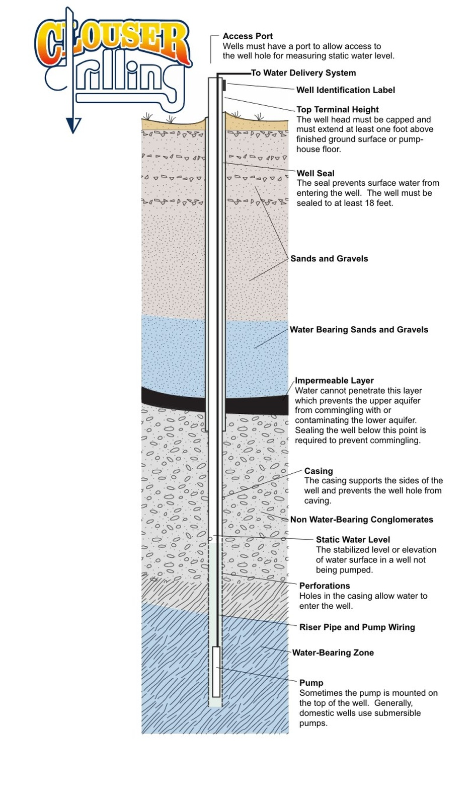

Went back out to the property yesterday and measured my neighbors ( vacant property ) abandoned well. The well casing ( steel ) is just covered by a pot.
62 feet down with a heavy object tied to a string and I am in water which appears to be the water table depth for my area. I understand it rises and falls, last week it was 67 feet but they just recently had quite a bit of rain.
The well is 135 feet deep which means there is a 73 foot water column in that casing.
I do not understand how the water gets in the casing, they are using metal pipe and Im sure that it is not perforated at the bottom few feet so how does it get in the casing? Im guessing that its like placing a straw in a glass of water.....that the water level will rise within the straw thru the bottom of the straw to become even with surrounding water level outside of straw but this casing is not buried in a lake, its buried in water bearing sand and am I to assume that this sand is so saturated with water that it will replenish itself very quickly?
I did not know this and have been wondering for a long time. ( assuming my assumptions are correct )

There's perforation somewhere in the pipe. There has to be or water won't enter it. Maybe this diagram will help.

If the well is in sand or gravel, the well driller installs the screen (sometimes stainless steel) with a mesh of size to keep sand or gravel found there out. If water isn't found above bedrock (or is not fit for consumption) a driller will keep boring until enough is found, or the price gets too high to make it viable. Casing runs to the bedrock to keep any non potable water out. There are enough fissures in most bedrock that useful water (at least where I've worked) can be found in most cases. No screen is normally needed in a well that reaches bedrock, and no holes in the casing.

When and how does he install screen. Scenario: Sandy soil, no rock to be found, reaches a depth where driller feels adequate supply of water, drops casing into hole......is there a screen in that initial steel casing at the very bottom of casing?
I have never seen a steel casing with perforations in the side, I have seen this only in the plastic pipe sometimes used
The screen is usually the same diameter as the casing and has a threaded coupling it attaches with. Some are pretty long, but if I remember correctly, 4 feet is typical. They make screens with different size openings to suit.
