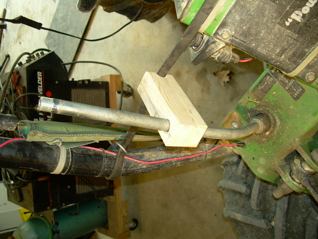

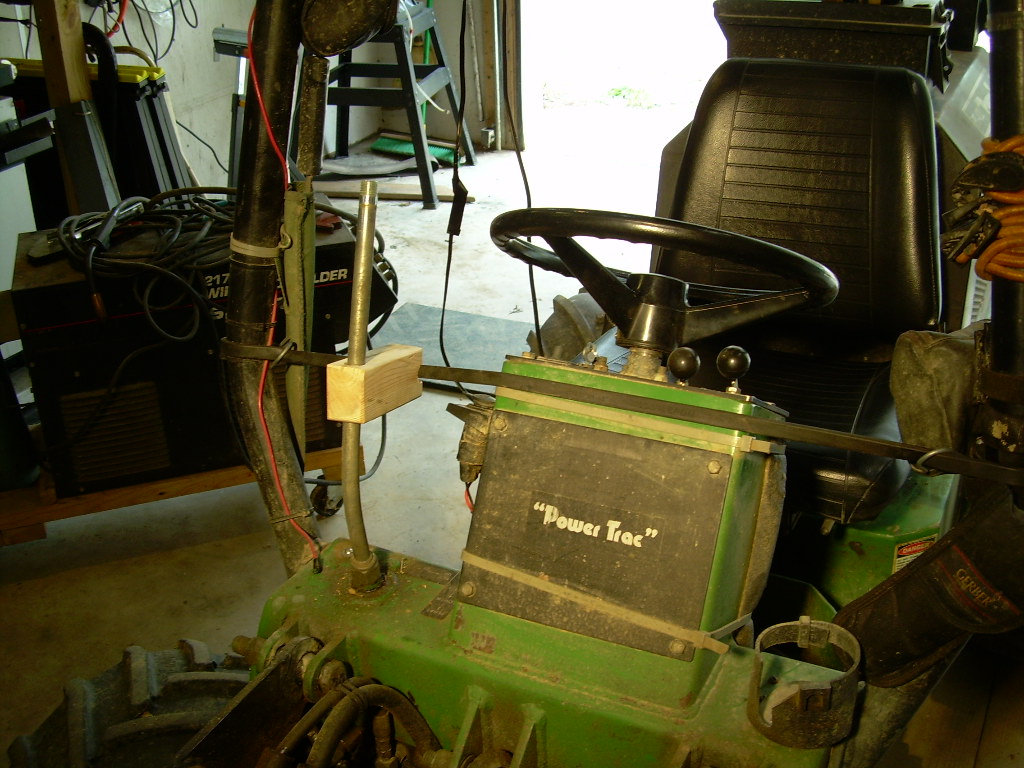

Have you taken the valve apart to see if there is any crud in the detent? If you don't want to do that, a bungee pulling the stick forward would probably help.
No, I haven't opened up the valve. It will click into float, but just from bouncing over rough ground the weight of the long, curved joystick seems to pull it back out of float. It's not a problem with loader work, for example, because you're only in float for a short period of time. But, when mowing you're in float as the normal mode of operation... and it just doesn't seem to want to stay there all by itself.
I need to do something, because I ended up having to hold it into float just to make sure it stayed there. That's a PITA when you're working on slopes where you'd really rather be holding onto the ROPS with that right hand...

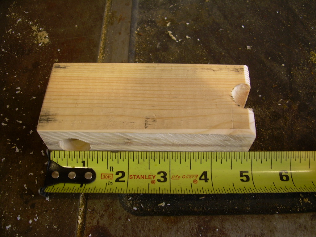

Did you see my solution for this, a bungee strap (rubber truck one) and a homemade block of wood? I am very pleased with how well this works. It's easy to use and easy to disable. See attachments.
I probably did, but had forgotten about it... :p
Thanks! :D :D
Cheap, simple solutions are my favorites... ;) :)
