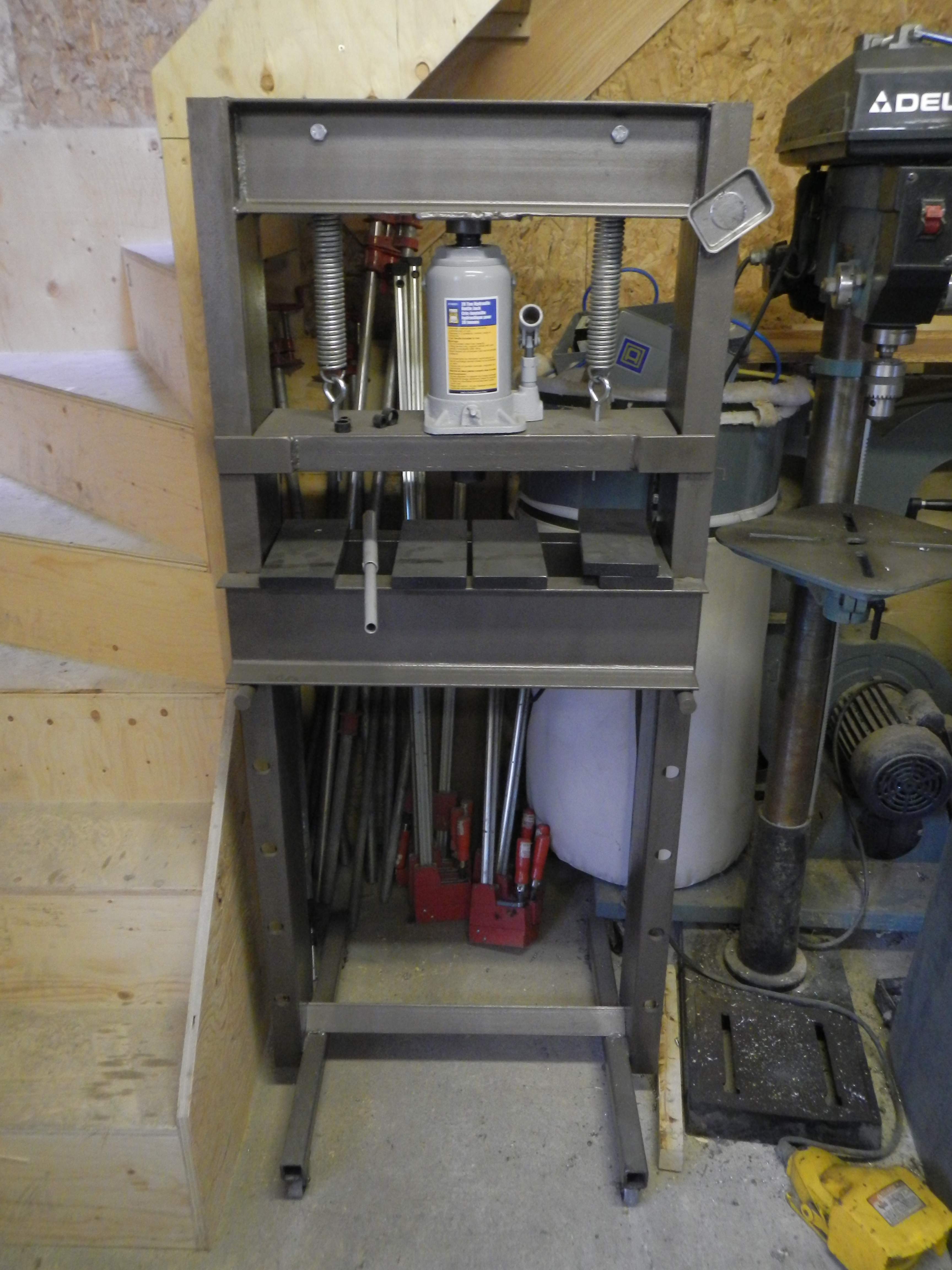

A 20T press I built. It was made out of scrap 6" x 1/4" steel channel.

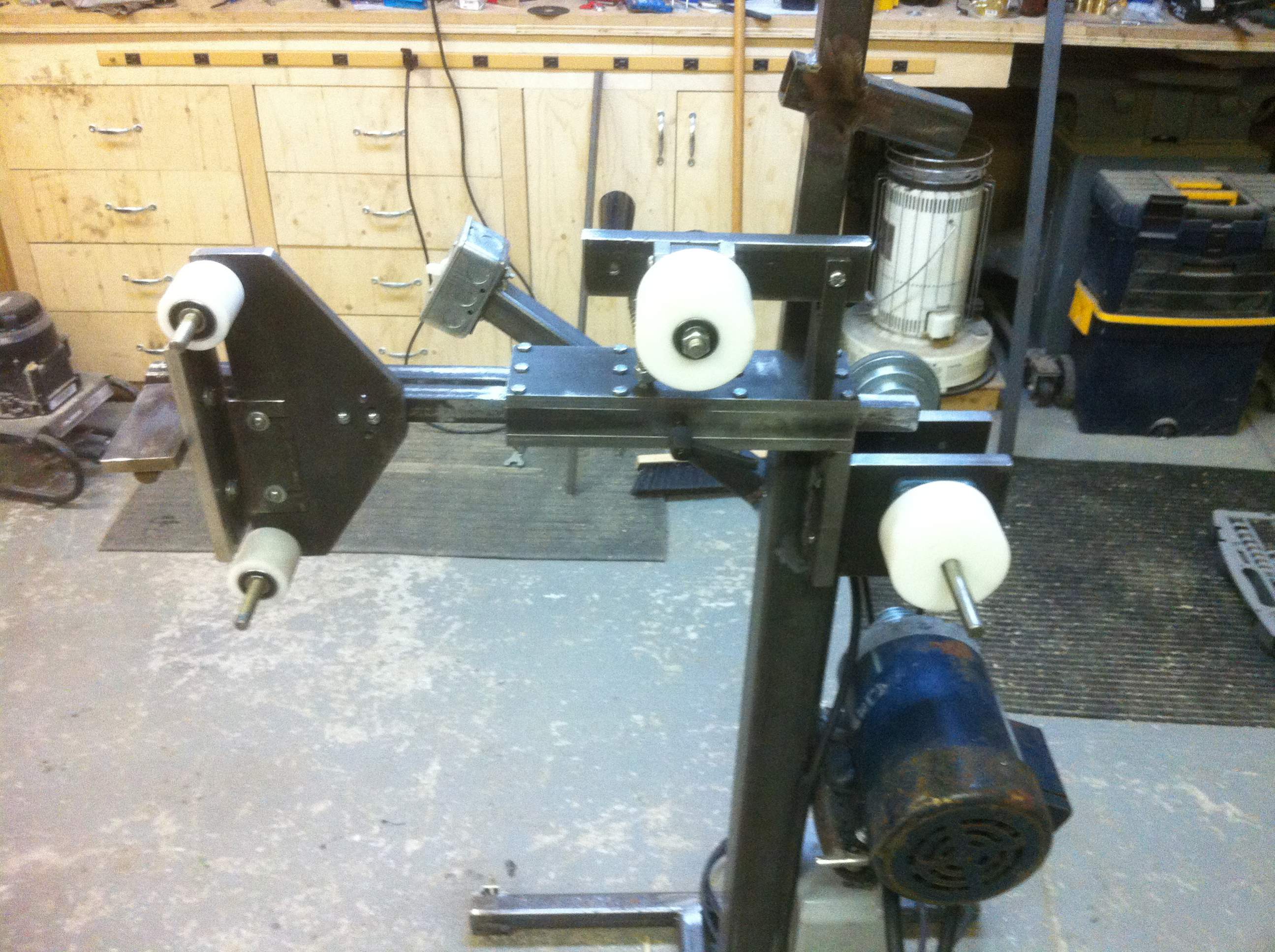

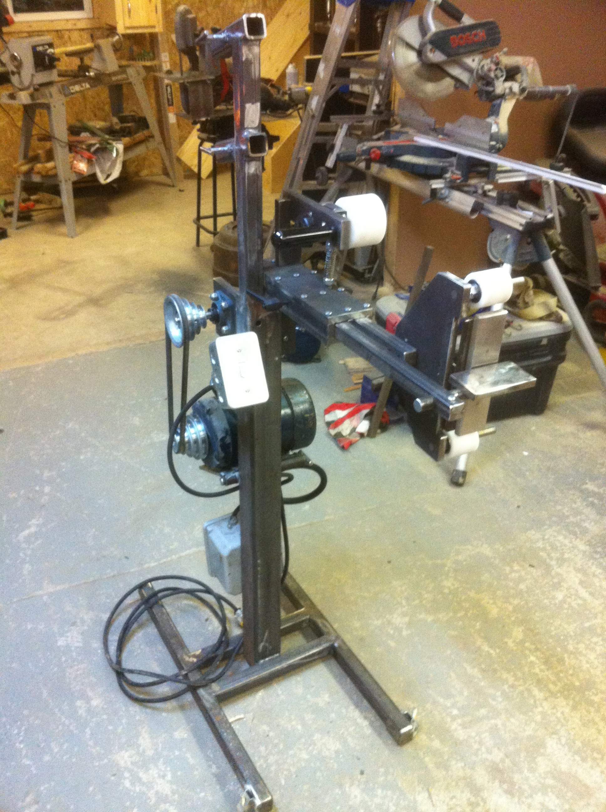

2" x 72" belt sander. Sander has a 2Hp motor and is on a stand with wheels. Very handy for cleaning up parts.

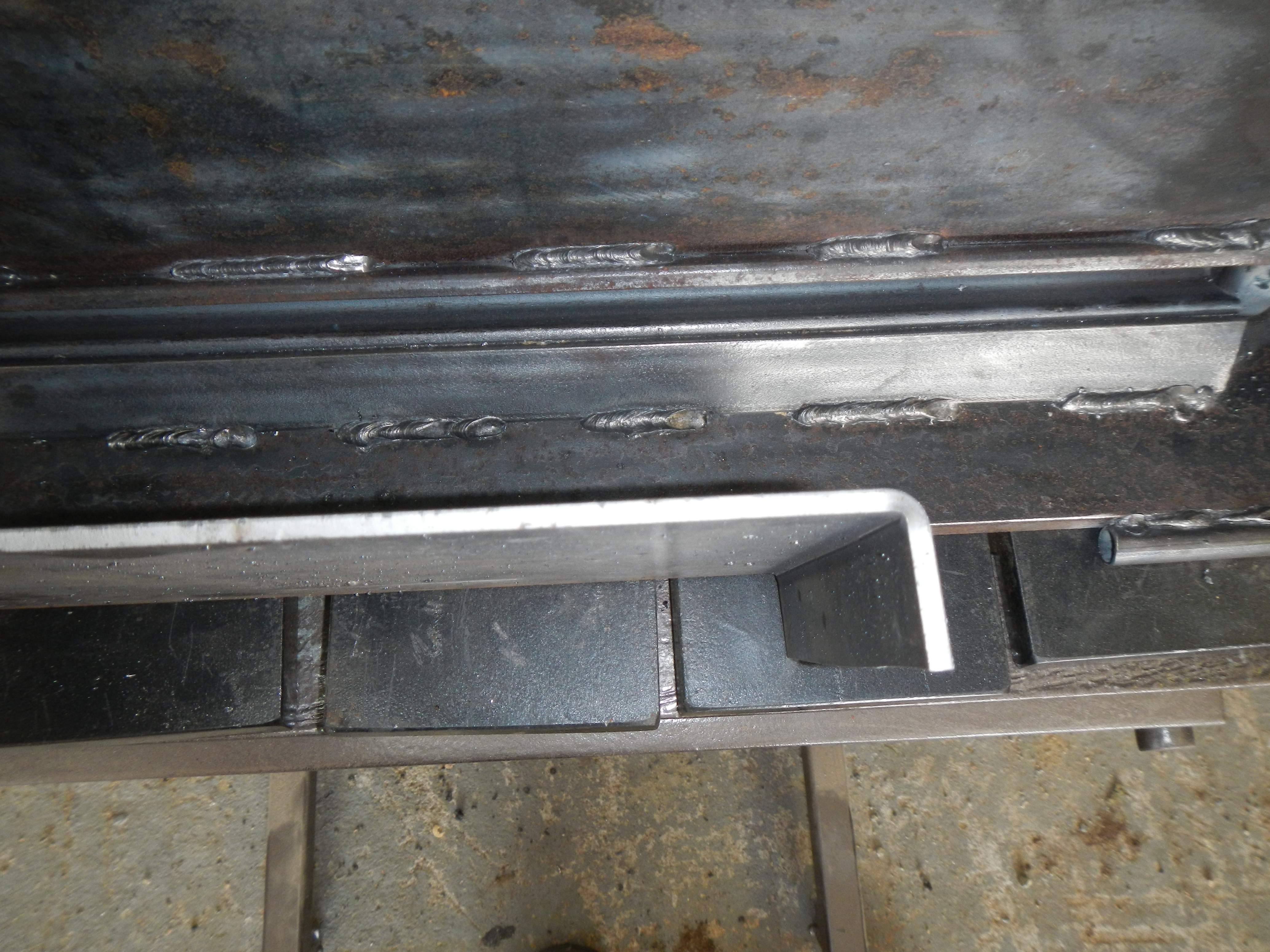

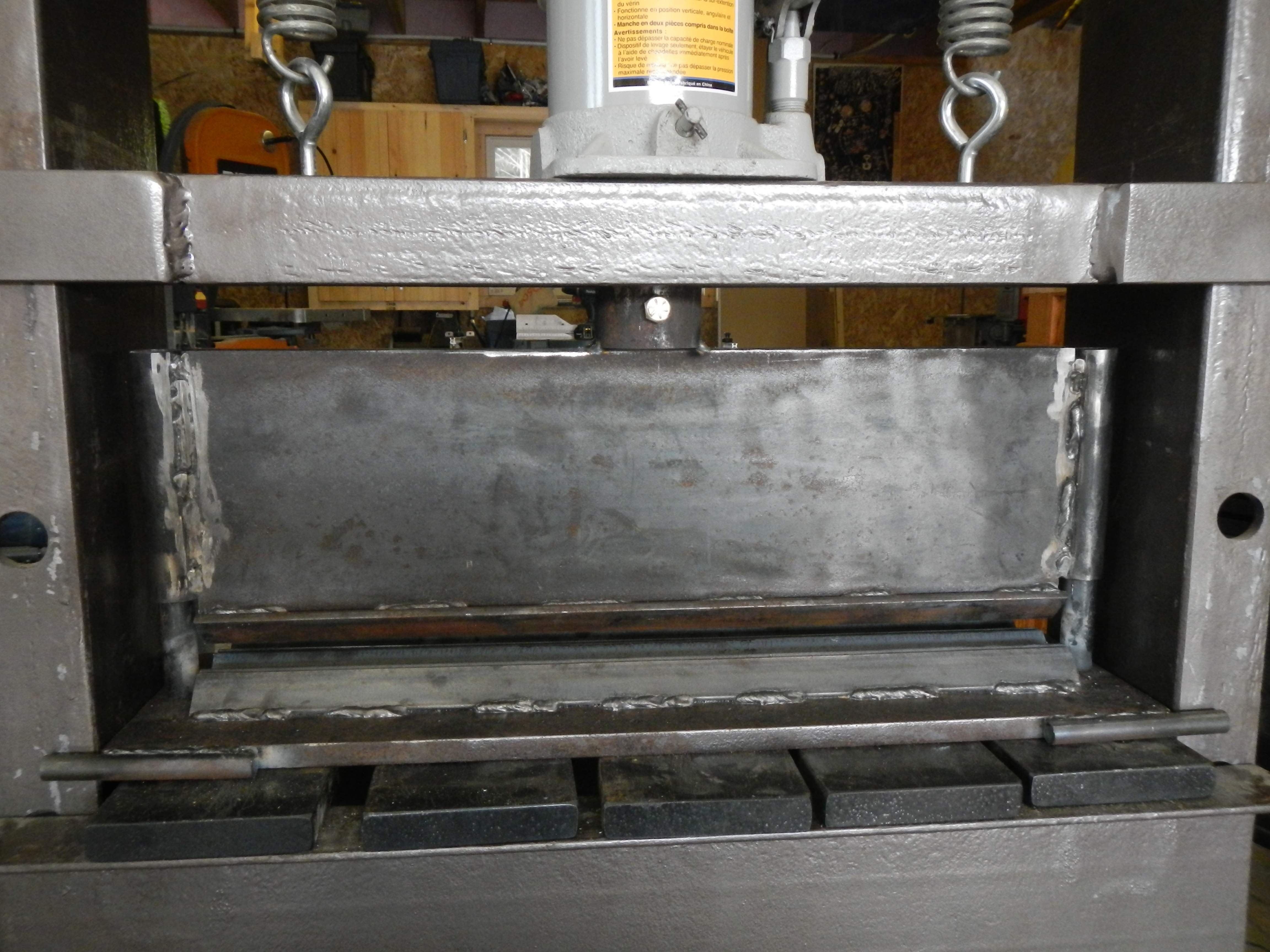

I needed to do some bends in some plate that I had and built this brake out of some scrap. Been meaning to build a better one but this one just works and doesn't show any signs of giving up just yet. It is made out of 1/2" x 6" plate and some heavy 1" angle.

I will have to dig the finished pictures out and post them. These were all I had on my iPad. Here is a video of the building and first use of the belt grinder.

Here are the rest of the build pictures for the Belt Grinder.

And the finish pictures of the press and some stainless steel stepper covers I made for the CNC mill.

By the number of 1" belts you have for the sander either you hit a huge garage sale or the lottery. Ellis builds one but I could not see enough usage to buy their expensive model. I always wanted to build a press but they sell them so cheap it is almost just the cost of the steel and jack. Besides 1" holes are hard for me to drill. I admire metal " artists " when it comes to building machines. Good work !

The belts were an eBay buy. I got ten each of two different grits. The press was scrap stuff I had laying around so I only cost me a few dollars for the jack.
