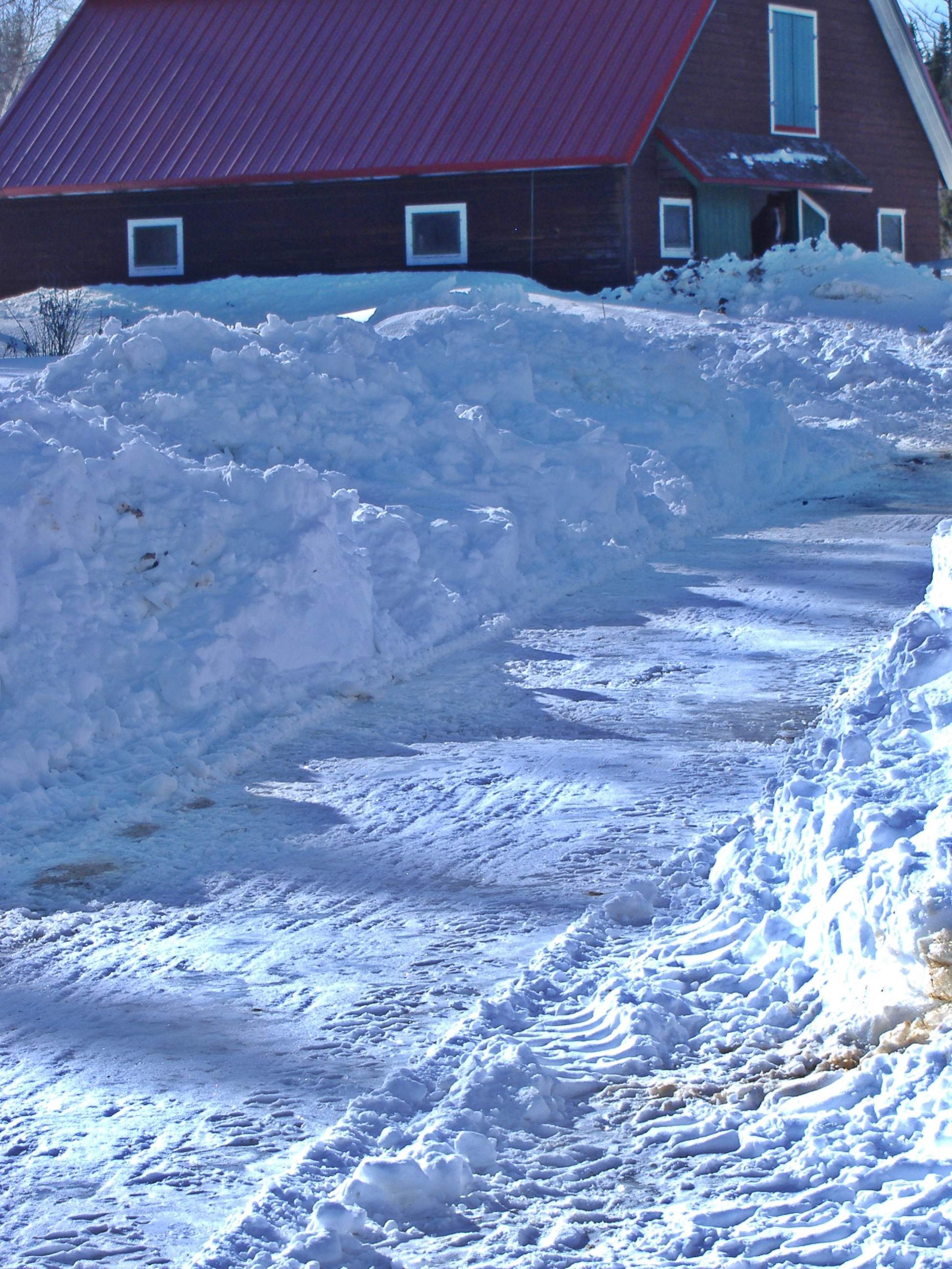

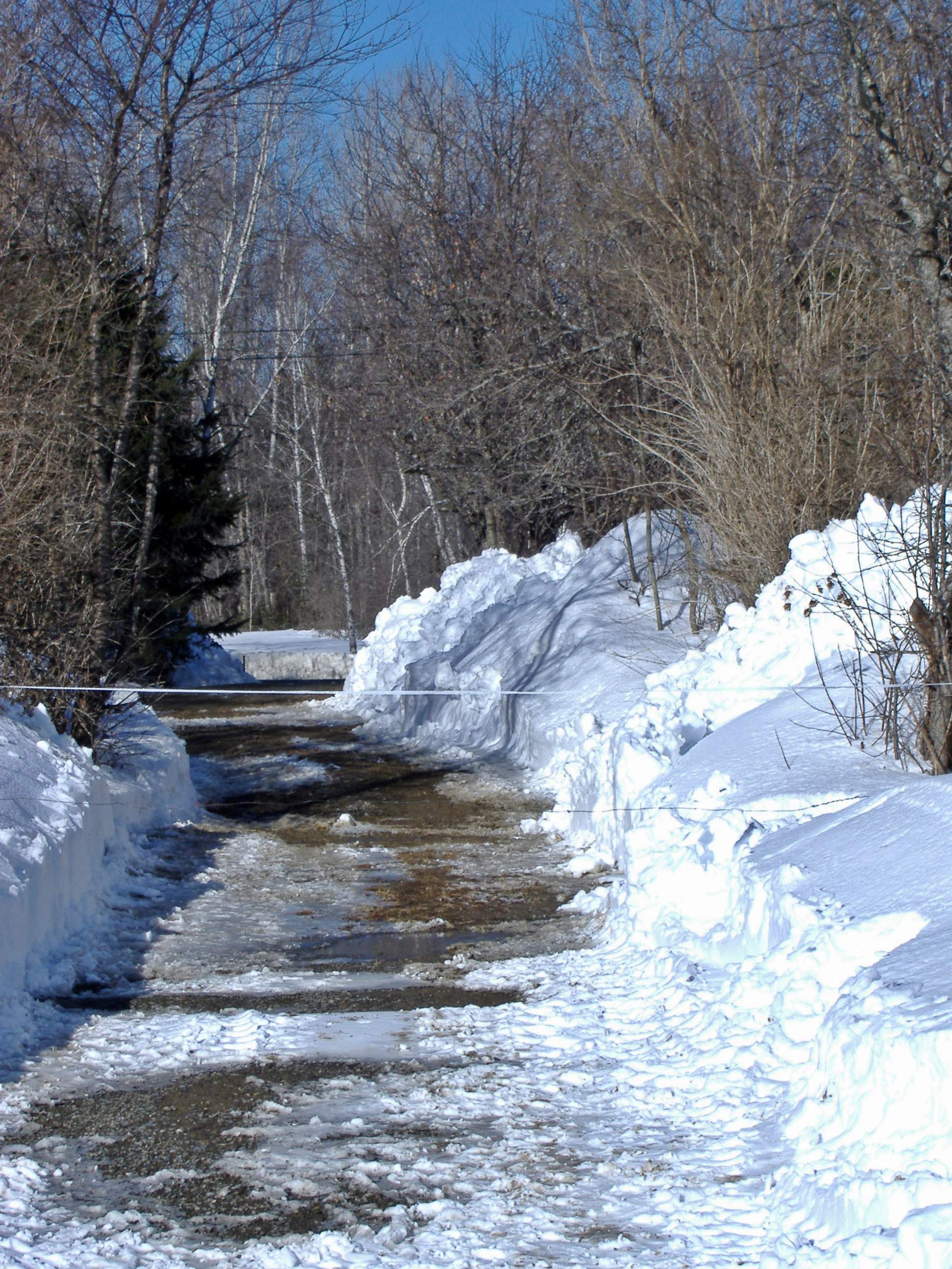

The past few years all I used was a 5' bucket. You push as far as your tractor allows and plan turnouts to shove the snow to the side into banks. You push it in deep as over the winter you have some high banks. - From a couple of winters ago -

Does your tractor do the limbo under that wire in the second picture?
Keep the horses in - they love to go see what's new in the world! One tape wire, 1 steel wire.

BTW @tcreeley that was useful information about just using the 5' bucket. I don't have a long road, in fact just a "circle" about 3 car widths wide and 7 or 8 "long" plus running down between the barns. I've been clearing it with the blower on the garden tractor but am getting 3 "Edge Tamers" for the real tractor's bucket to use at least in areas where the garden tractor just doesn't get good traction (like any sort of side slope or backing up any amount of slope). I'll see what combination of things works best.
