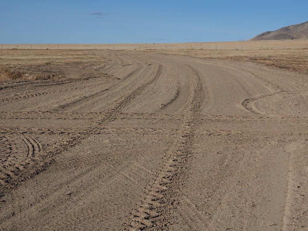

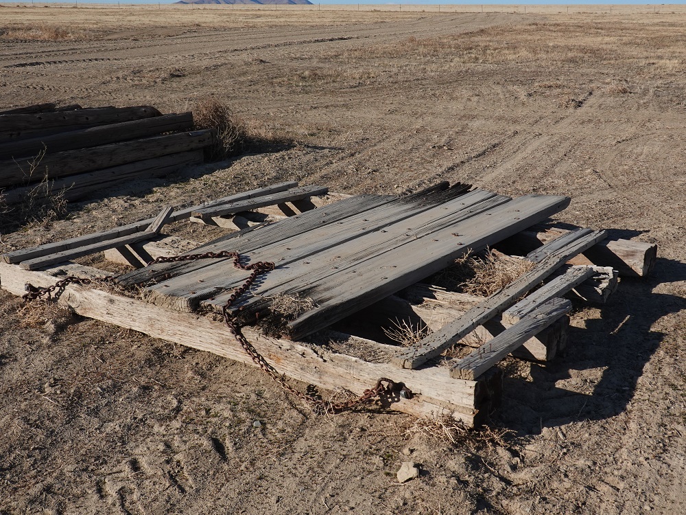

I made a cheap and easy land leveler that works very well...4 railroad ties fastened together that I drag with the tractor:
This is what the ground looks like after a few passes:
