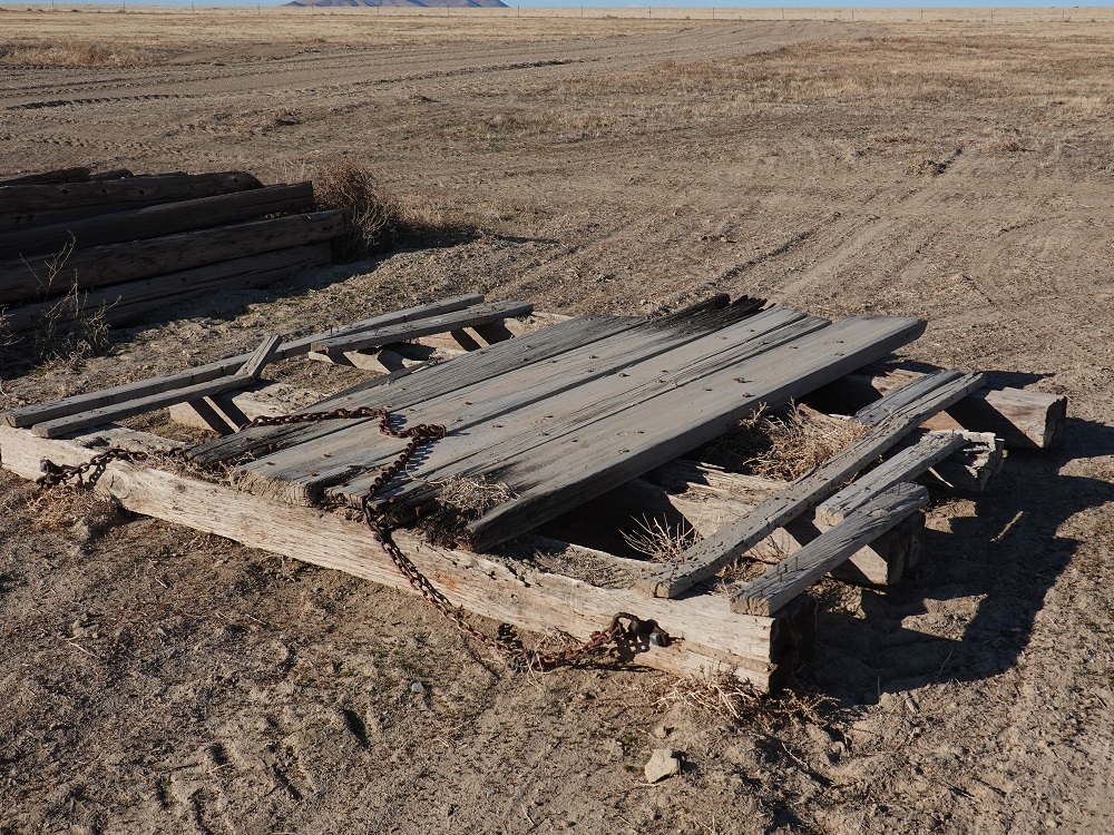

I made a cheap and easy land leveler that works very well...4 railroad ties fastened together that I drag with the tractor:

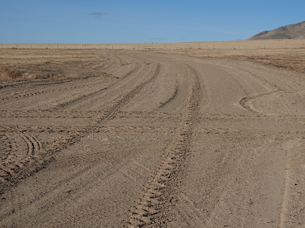

This is what the ground looks like after a few passes:
That does a very good job. Probably one the easiest to make I have seen.
Just for interest short chains could be used to hook the ties together. That would allow the Ties to be at different angles. A sheet of plywood on top to hold weight if needed.

We made a 'drag' using 3 RR ties but 4 longevity we bolted 1/4 X 3 flat steel as cutting edges.
Also varied the angles of the ties so that material could travel from side to side to fill the dips all while slicing the tops of the humps.
