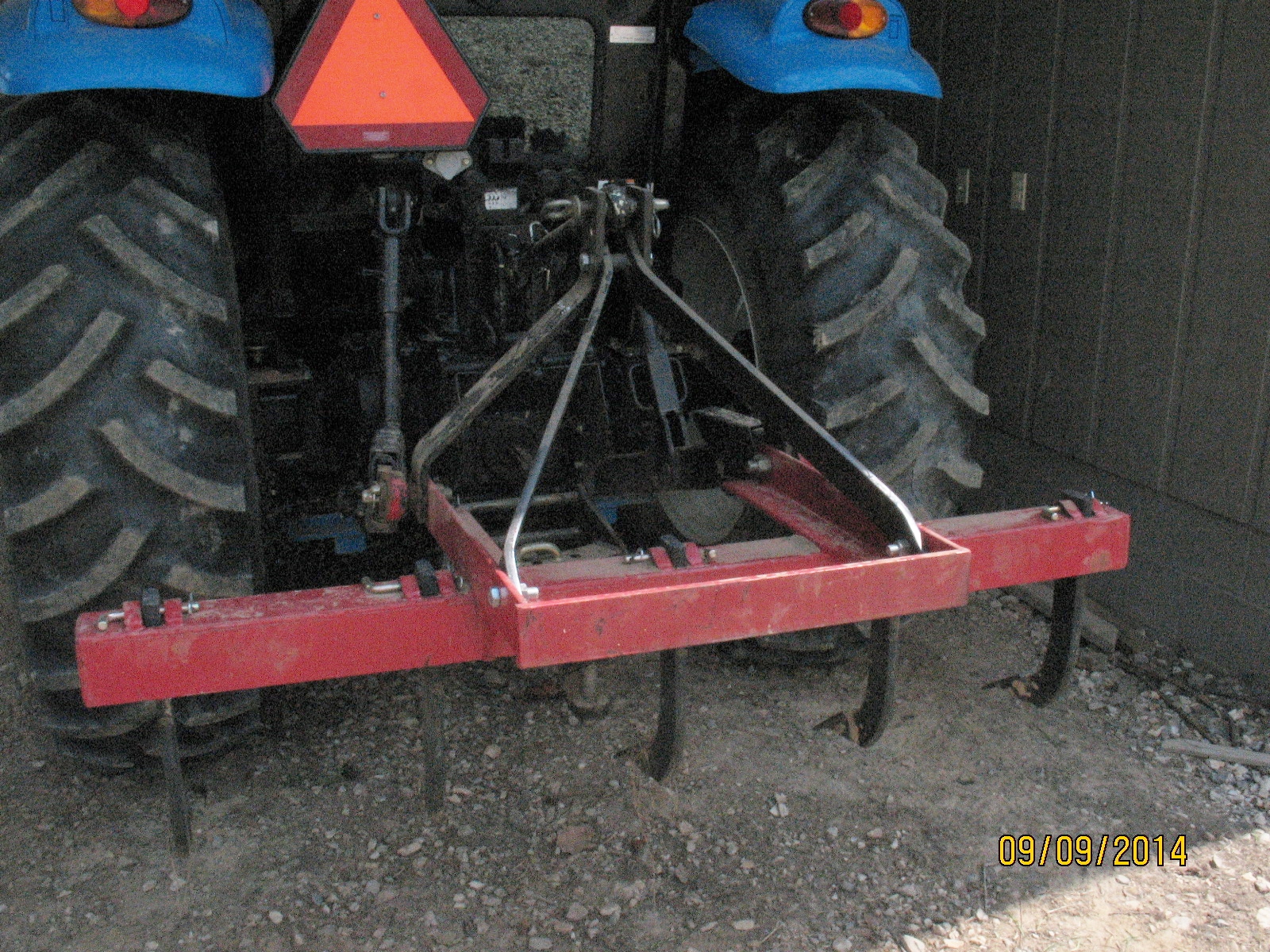

I would just use a box blade scarifiers set to depth wanted. Tilt it forward by shortening the top link so the blade isn't touching. Or you could use this (Photo below) IMG_1643.JPG

I would just use a box blade scarifiers set to depth wanted. Tilt it forward by shortening the top link so the blade isn't touching. Or you could use this (Photo below)View attachment 645936
My suggestion is assuming the OP had nothing that would do the job. The subsoiler attachment shown cost me $350 new but that was 5 years ago, it may be a bit higher now but definitely cheaper than any other item listed. It will do the job regardless of how tough the soil is.
