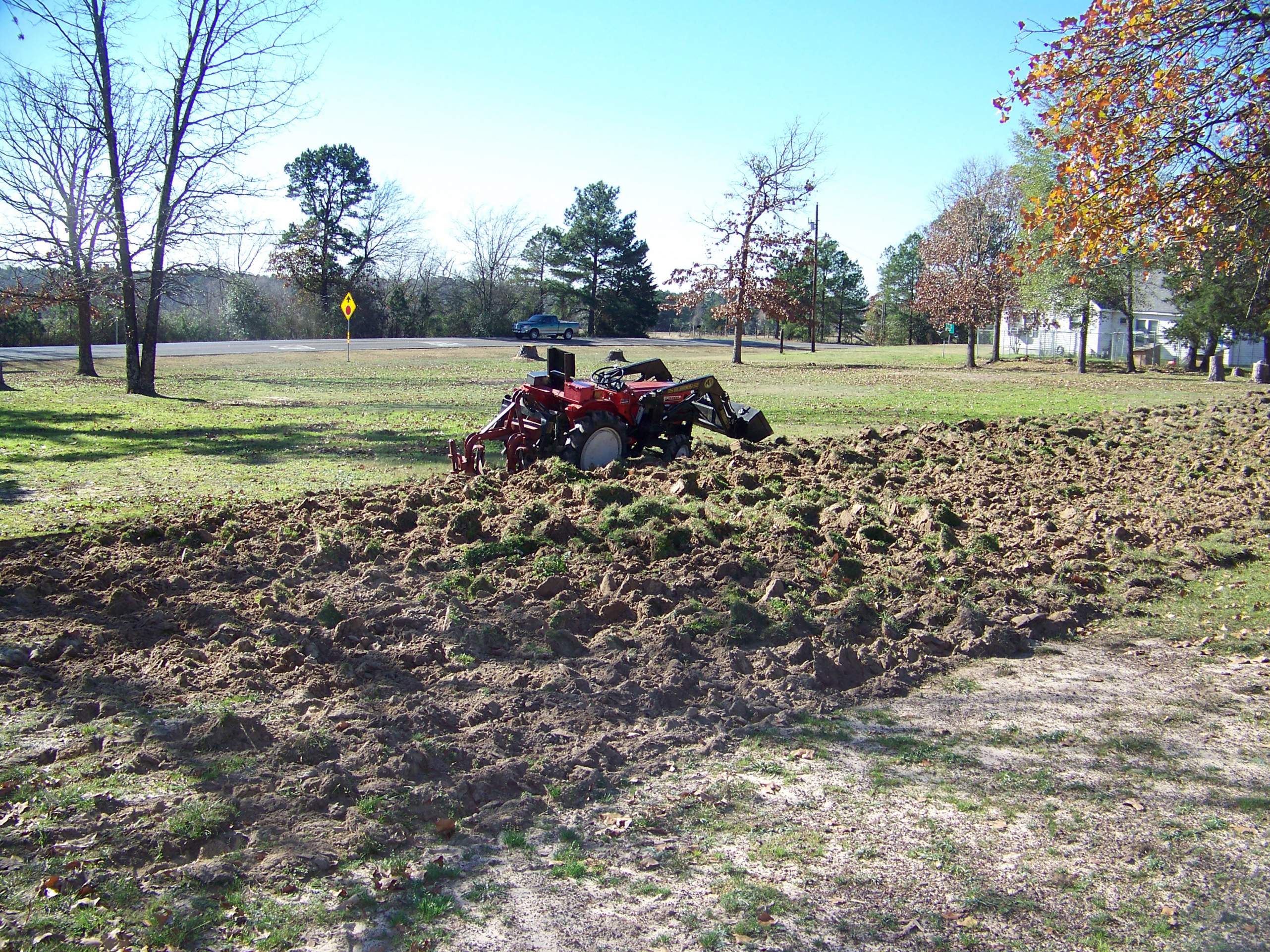

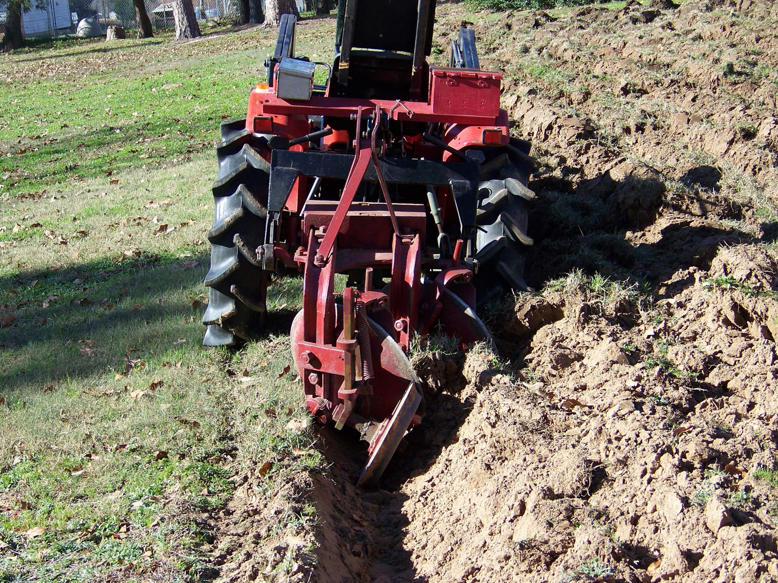

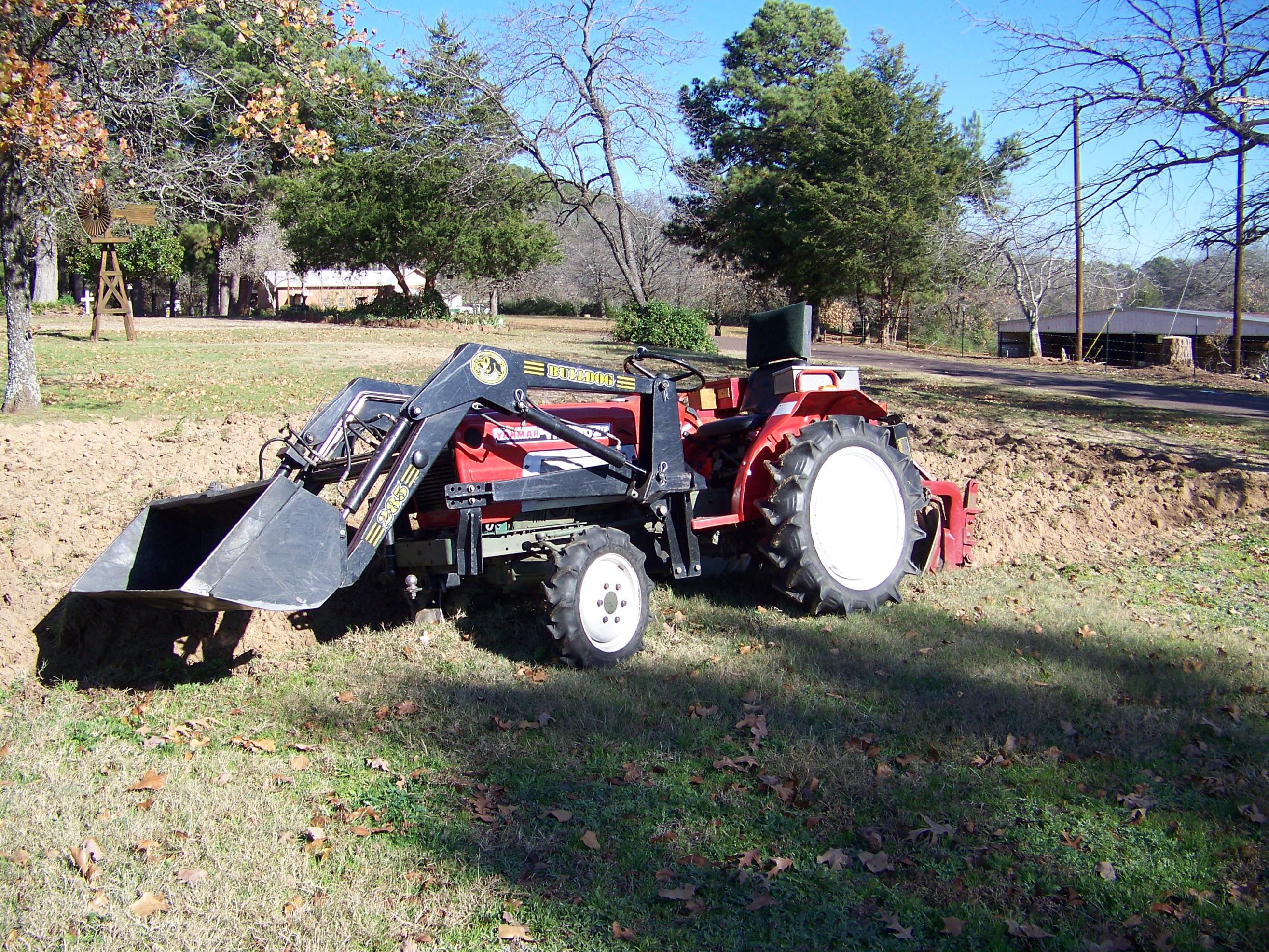

Here is something I do with my 2002D. Getting ready for spring planting.
   / Something You realized can do with your tractor... #28
That disc plow sure works well, Winston. What do you do to follow up?

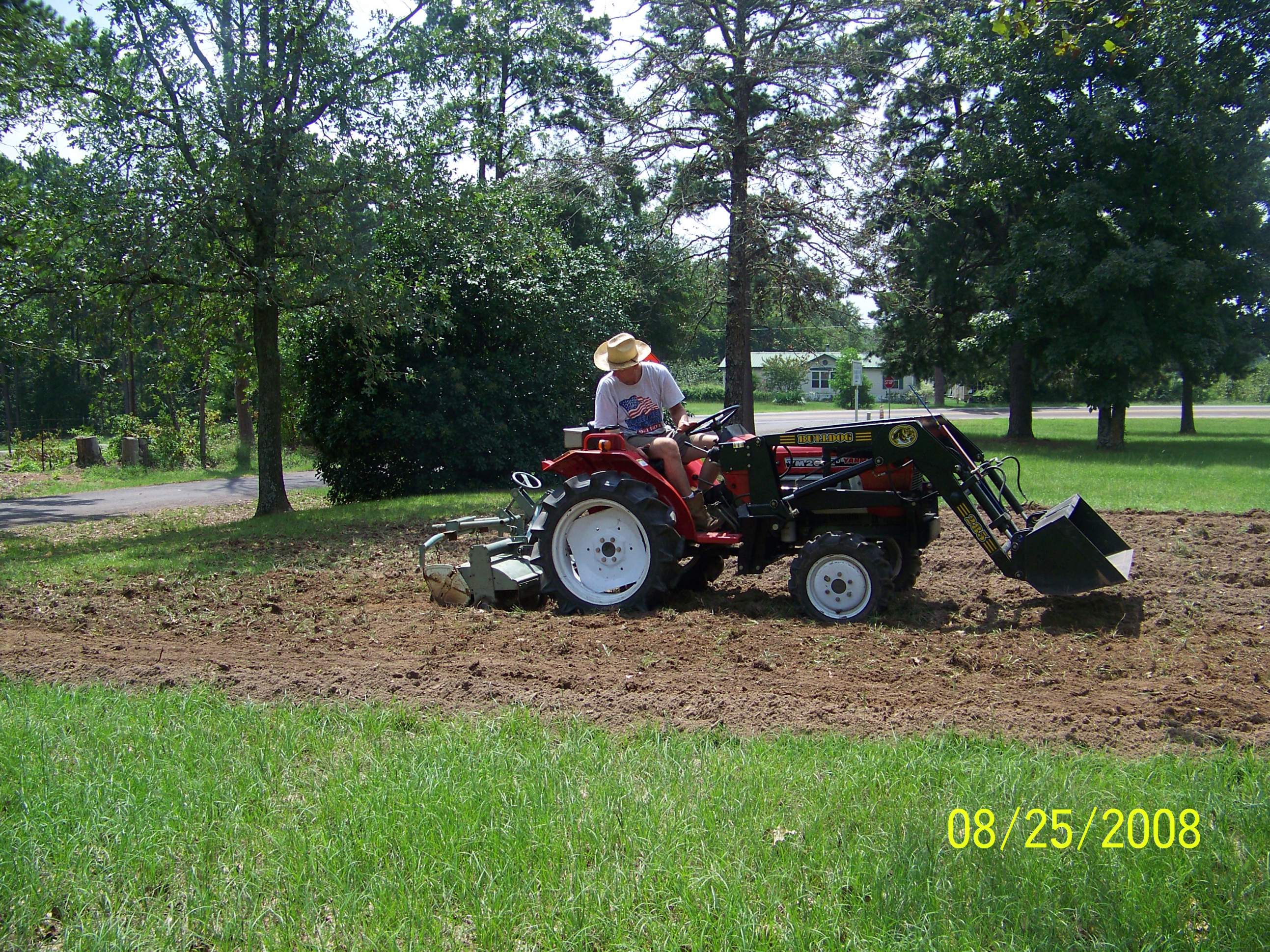

Sometimes I go over it with a tandem disc to sort of break up clods and smooth out. I will go over it with my Yanmar RS1300N tiller right before planting time. Here is an old picture where I was breaking up new ground with the tiller. It works much better for me to turn it over before using the tiller.
