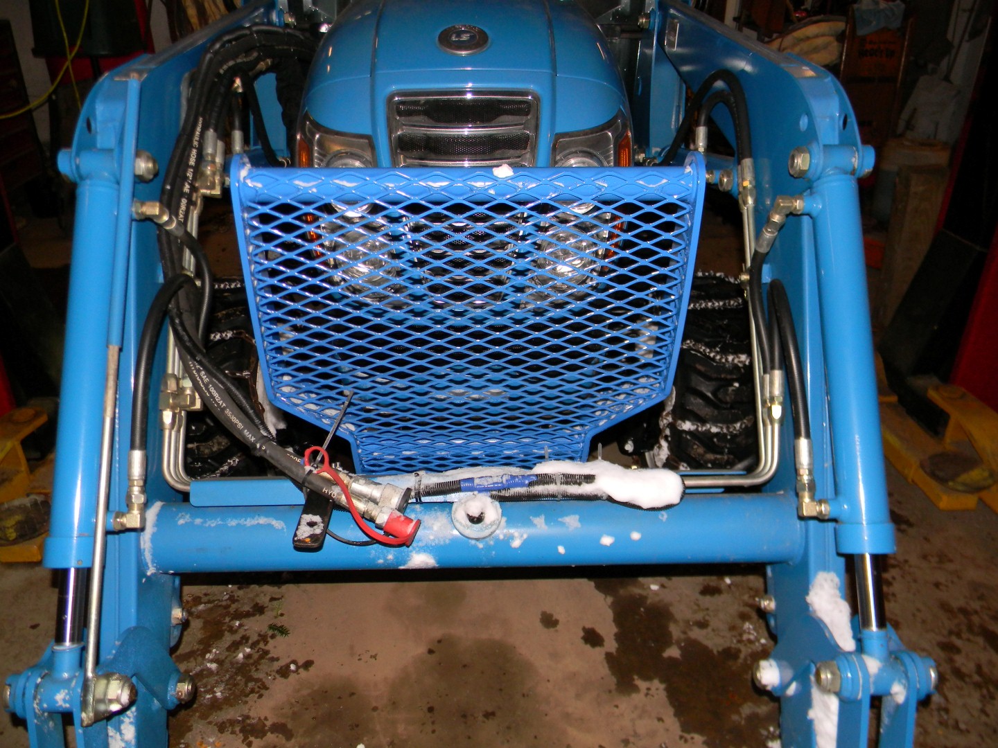

That's why I installed expanded metal on my guard last January 2015. I don't want anything getting through that guard either.
Sorry to hear about your headlight lens damage.
Good job on installing yours.
I like the way you recessed the expanded metal on yours. I laid mine on top, tacked it, finish welded it, and then cut the excess. I was on a time crunch, yours looks much cleaner.
Yeah, it was tough and took a while clamping and bending the edges to fit inside but I wanted a cleaner look to mine. Nothing wrong with yours though. As long as it serves the purpose.

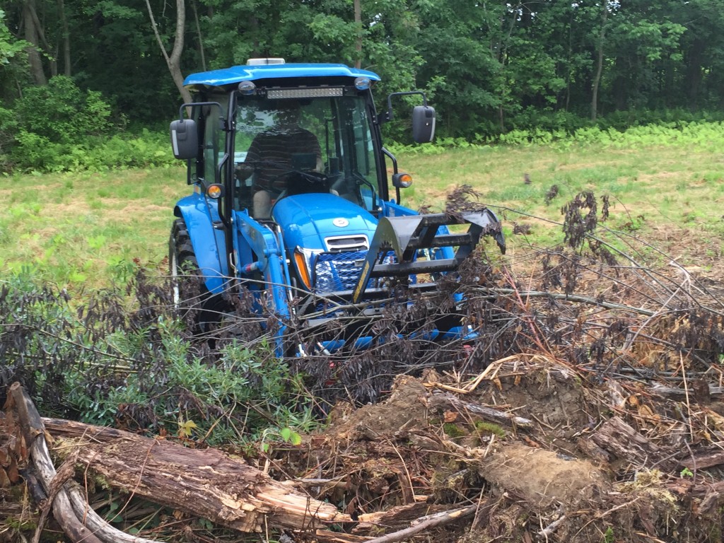

I don't usually use the headlights due to the bucket or other front attachment is always in the way of the lights. The do shine through the expanded metal if the bucket is low enough. I mainly use the front cab lights and front and rear LED light bars I installed.

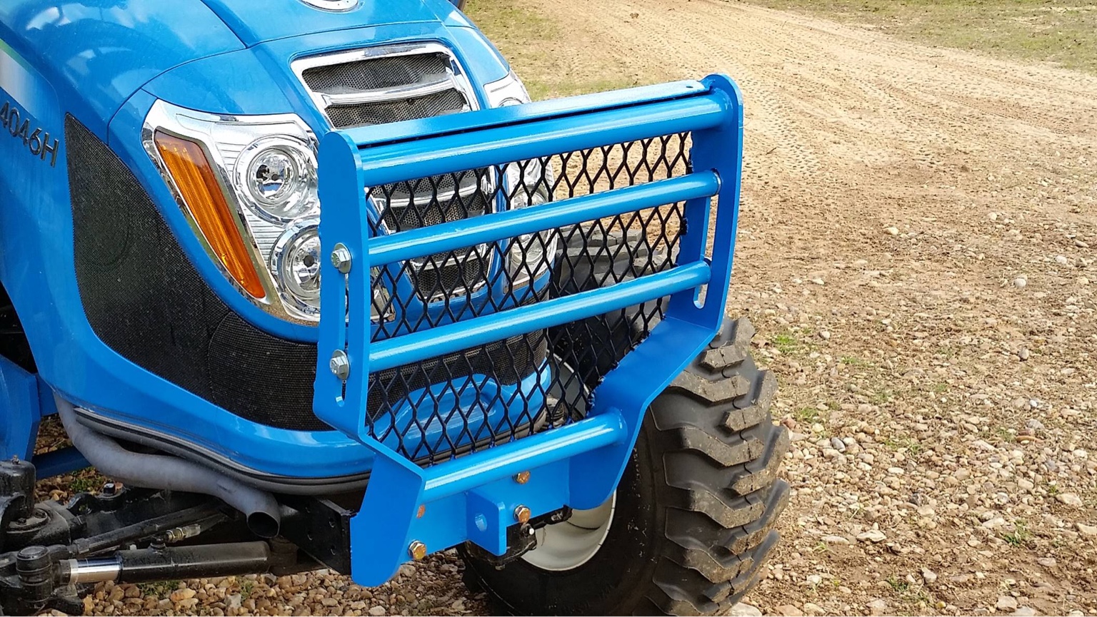

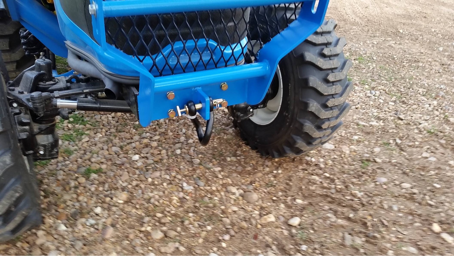

Yep, the stock LS grill guards provide little protection. I modified mine in a similar fashion.
I also added a pad eye to use when chaining down to trailer. I use a similar clevis, on drawbar to tie down rear end. No damage to paint when trailering and only need single chains and ratchet type load binders on front and rear instead of four.
Good idea on the tie downs. Some states require tie downs on each corner. I've been thinking of how to set mine up for trailering and I like your set up. I'll have to check with my highway patrol friends and see if it's OK.
