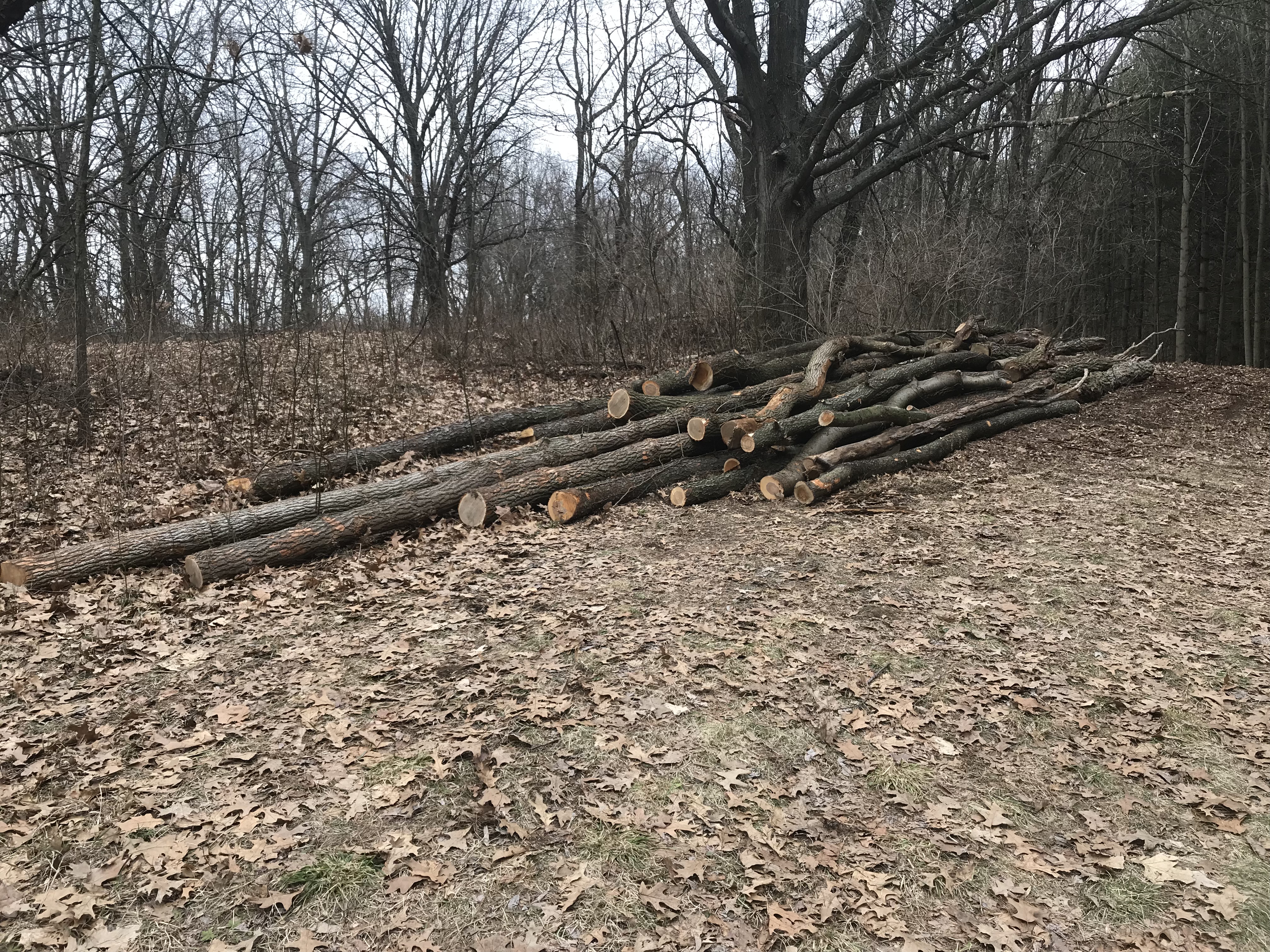

Not too bad for a lawnmower....
Sassafras and cherry in the front, locust in the back.

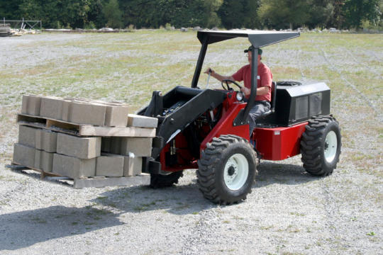

The little 425 might not, but its big brother the PT-1460 will work and pull circles around that Deere. It weighs ~5000lbs.
T24 Class
My father has a 3520 eHydro and I'll tell you it isn't about to lift 2400lbs 8' in the air, and the sorry excuse for 4x4 on the deere is only good for dragging the front end up over things to get stuck on. Its a great machine, I have hundreds of hours on it, but, like you said, it sucks in the woods. The front end swing is so long, I've had to take the bucket off and drop the weight box to get out of some places.
On an articulated tractor, the bucket/implement, front wheels, and back wheels all follow the same path. Sure, you can get them in bad spots too (like a tree between the wheels), but they are much more maneuverable. The Power-Trac specifically is built like a tank. Its built out of 1" steel plate! It also has a 60hp air-cooled deutz engine so no more punching out radiators. Theres a couple sizes in between too, if that one is too big.

MOSS - don't intend to change the subject but......... the picture in your post #4. Is that the "typical" undergrowth you have on your property - in your area?? I don't have 1/3 of what you can see in that picture - if you scraped everything on my 80 acres into one spot. My property would appear to be bush hogged to you, because there is little to nothing between my big 'ol Ponderosa pines. I continue to be amazed at the heavy undergrowth on a lot of pictures posted here on TBN.
Right now - if I were to post a picture of my tallest and heaviest "undergrowth" - it would be two patches of wild mustard growing out in the middle of one of my open areas. Each is about 15 to 20 feet in diameter and about 4 to 5 feet tall.
