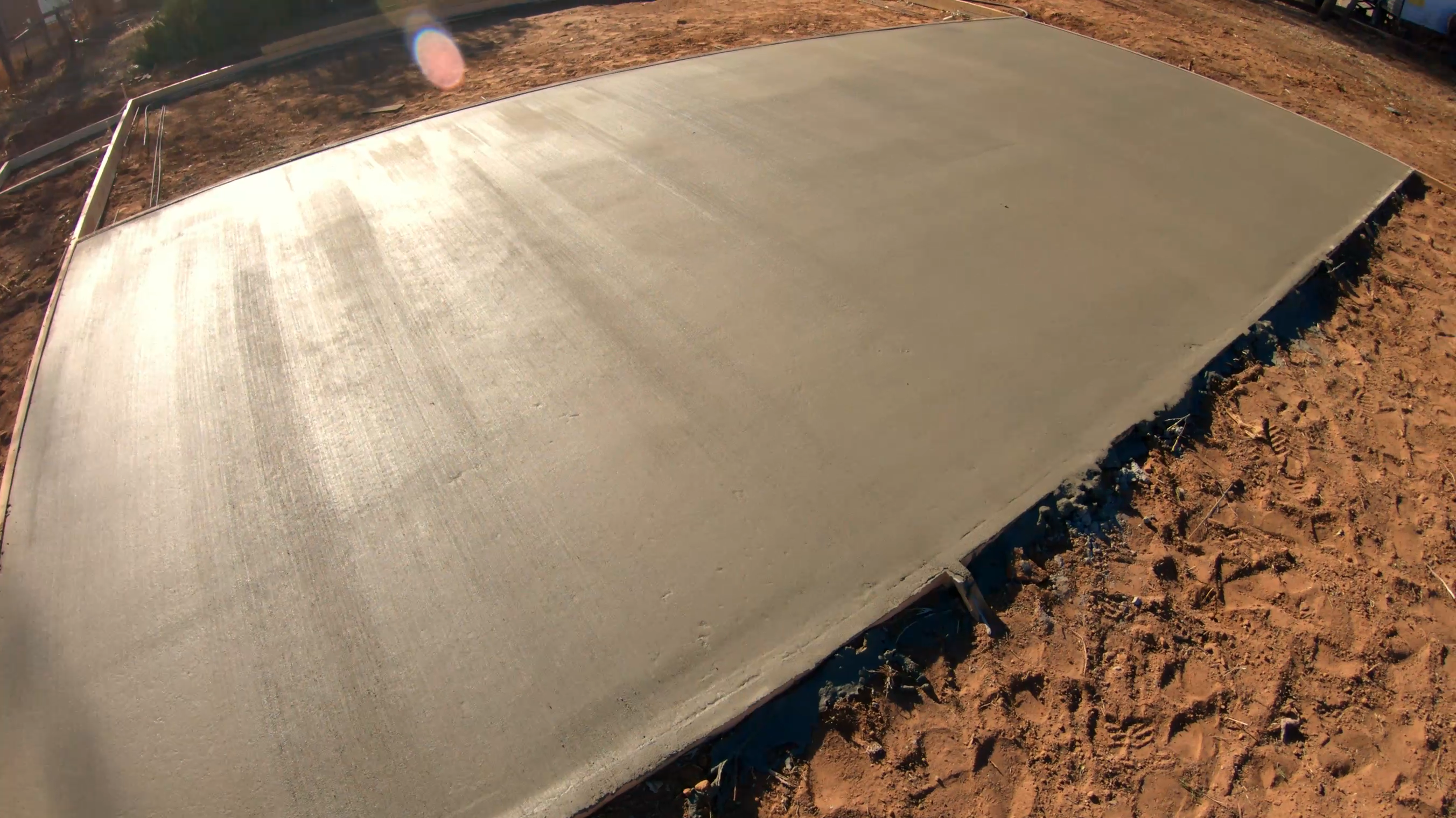

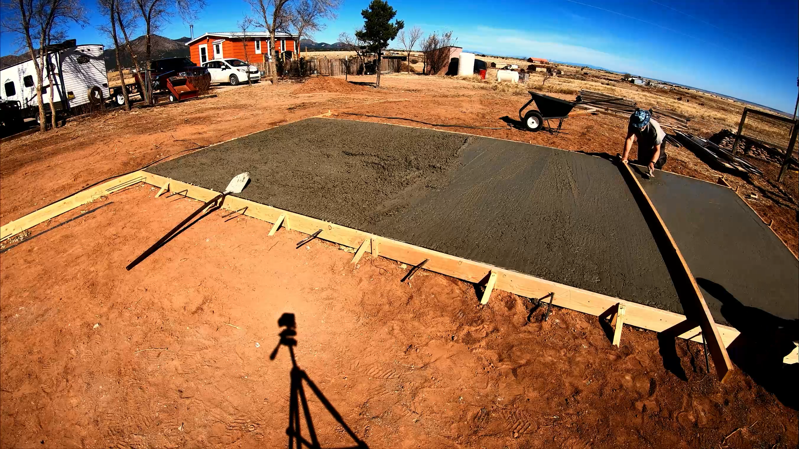

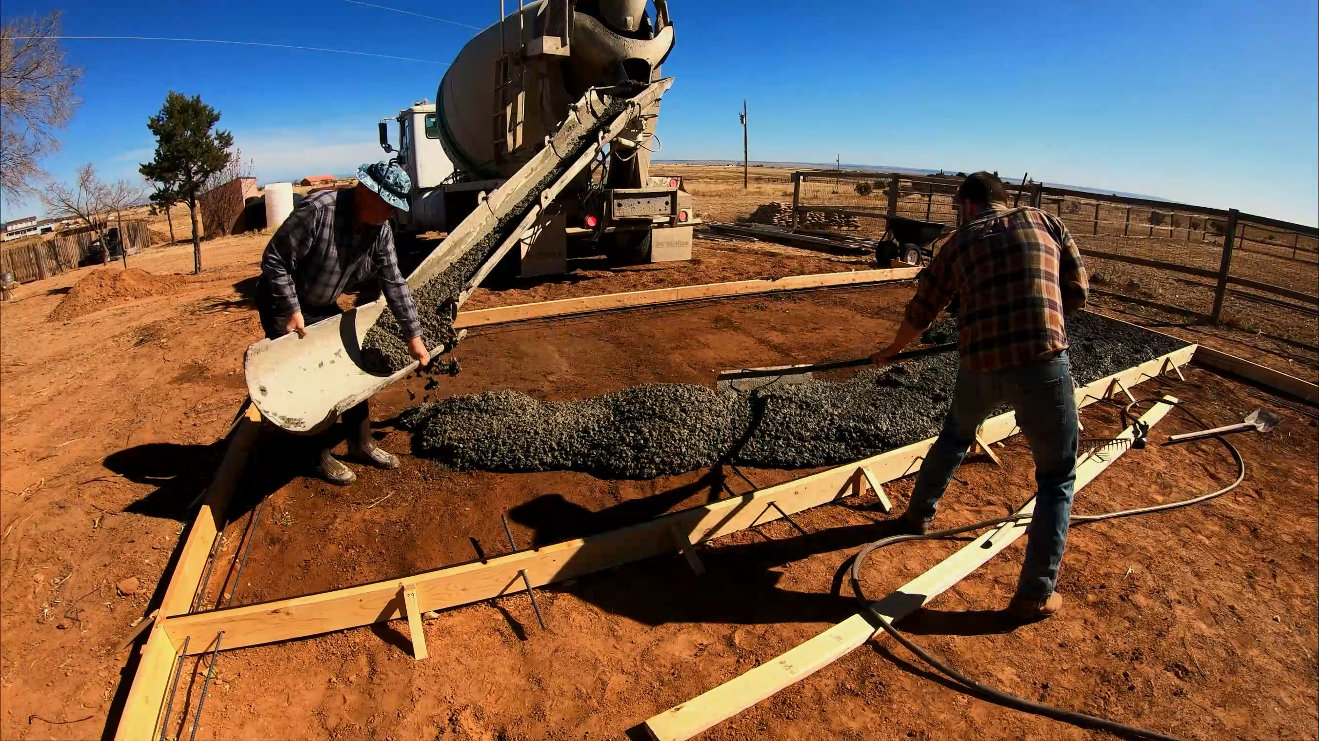

The slab is 8” thick, 6000 lb mix. There is rebar around the perimeter and going between the two halves. Just a bit more cost effective.
