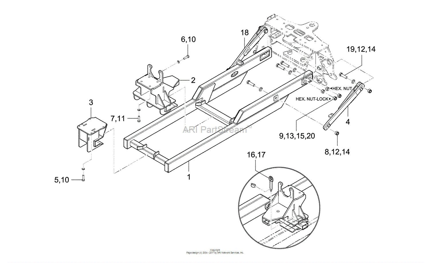

Attached, brand new everything. Received in July. The bracketry was installed by the techs per the corporate engineers guide. My incident occurred with 40hrs on the clock. I only had 32hrs of actual operation on the machine when it occurred. The tech was even on a service call with my tractor (for the regen issue I mentioned earlier) 1hr prior to the event. After the full investigation Kioti deemed it was an improperly welded bracket and improper length bolts that caused the occurrence. After further review they said that the L bracket was welded at a wider angle than the two mounting surfaces it was to bolt to.

Trying to get a clear picture of this. What was the incident? If the bolts were to short then what held the backhoe on?

This exploded diagram is of the bh2485 mounting frame.
Part #2 and #3 are the brackets that get bolted to the tractor to hold #1 the framerail for the backhoe. Part #2 is the bracket we are talking about. This bracket is bolted to the rear cast iron differential housing center section via 8 bolts; 4 #6 bolts, and 4 #7 bolts. #7 bolts to the bottom of the axle center section using bosses drilled into the cast iron. #6 bolts go into the front side of the differential using the bosses for the PTO guard.
First, the #2 bracket is "L"shaped where it bolts to the two mounting planes. That "L" is wider than the 90 degree mounting surfaces of the two mounting planes. You can see it better in the circled portion of the diagram.
Second, the bolts in the kit, both #6 and #7, are too short. First: from what I understand, the warranty guy said Kioti failed to take into consideration the thickness of the bracket plate when sizing the length of the #7 bolts underneath. Second: #6 bolts are not long enough because they failed to consider the combined thickness of the mounting bracket and the PTO shield since the #6 bolts hold both items. Added to this problem is the L bracket being wider than the mounting surface placing pressure on the bolts making the small M12 bolts try to suck up the gap between the bracket and mounting surface.
In my situation, the #6 bolts popped their threads leaving all the pulling force of the backhoe completely on the 4 #7 bolts and that single plane. I didn't feel the backhoe shift or rock while in use. Ultimately I created enough force to pull 2 of the #7 bolts out of their bosses and shattered the entire area of the cast iron housing around the remaining bolts. Destroyed the rear end housing and bent the backhoe frame rail.
