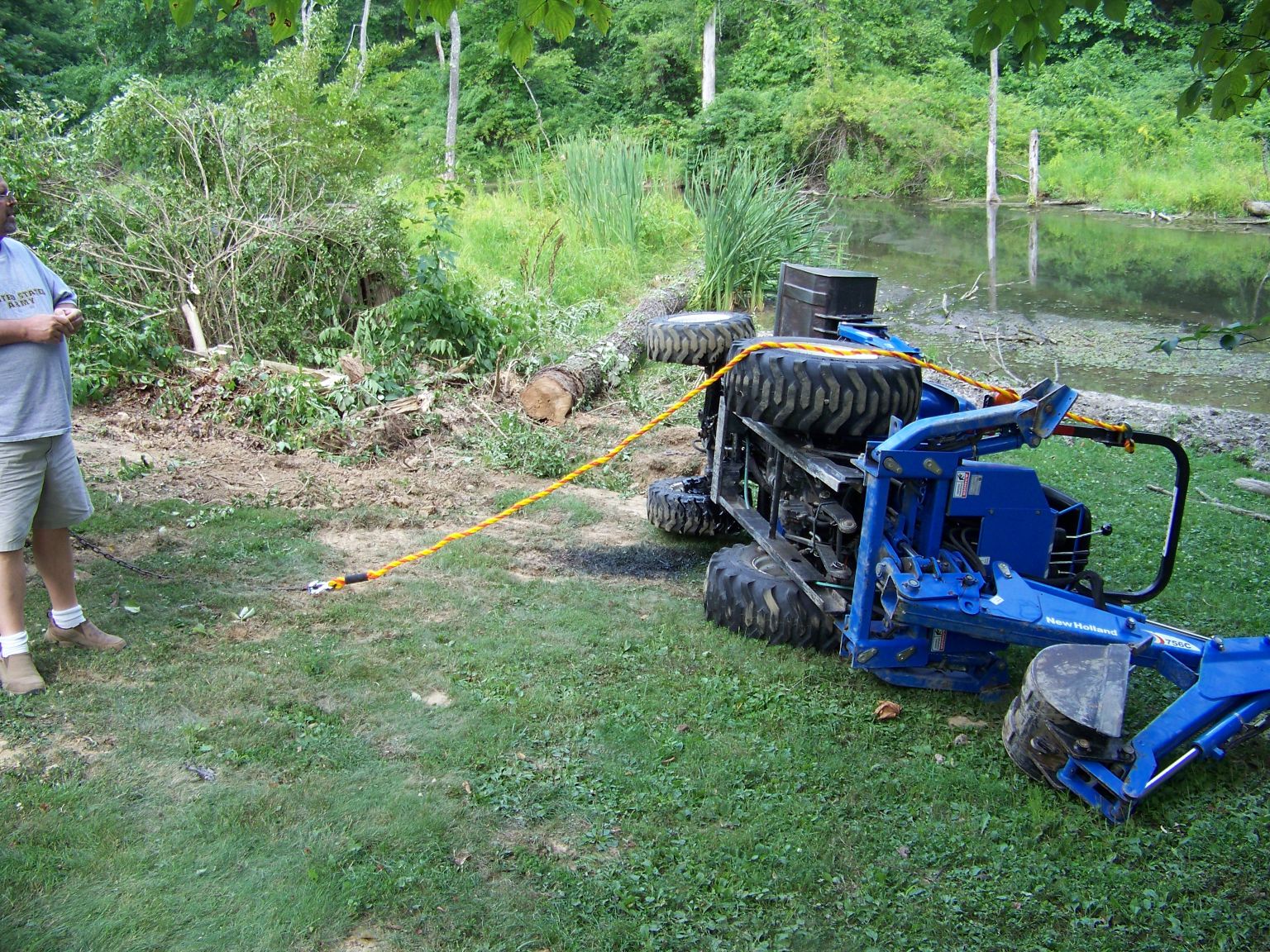

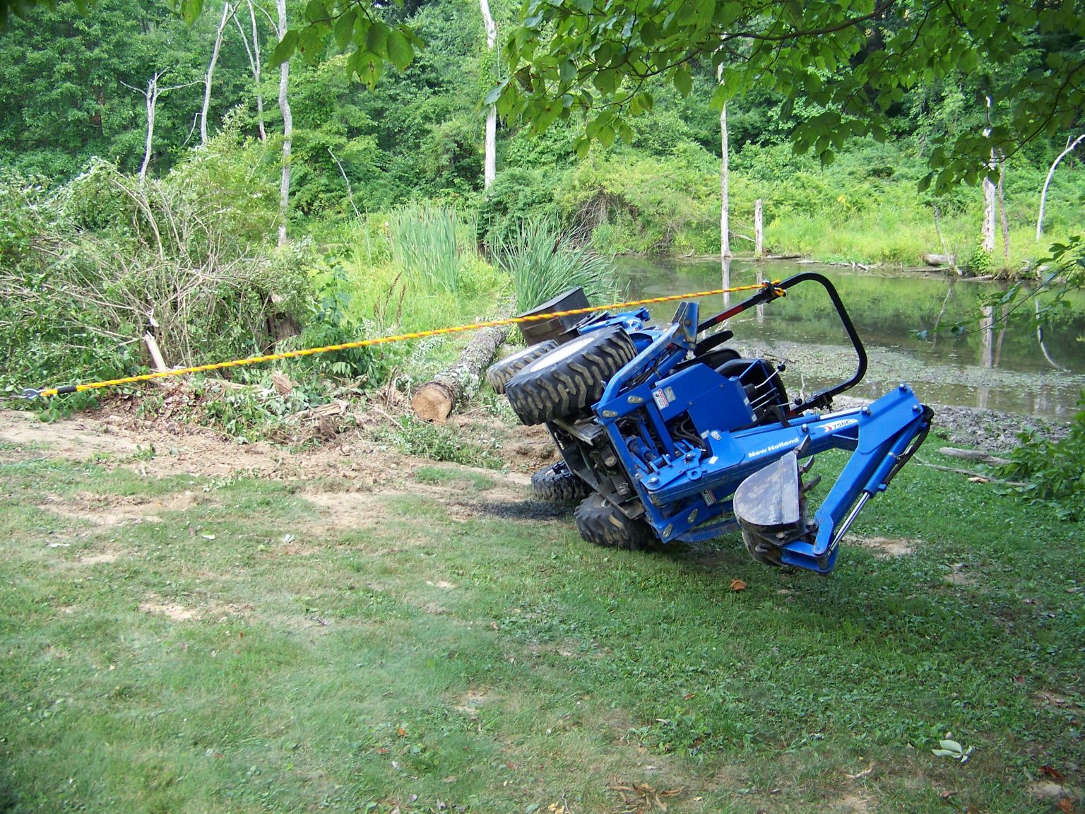

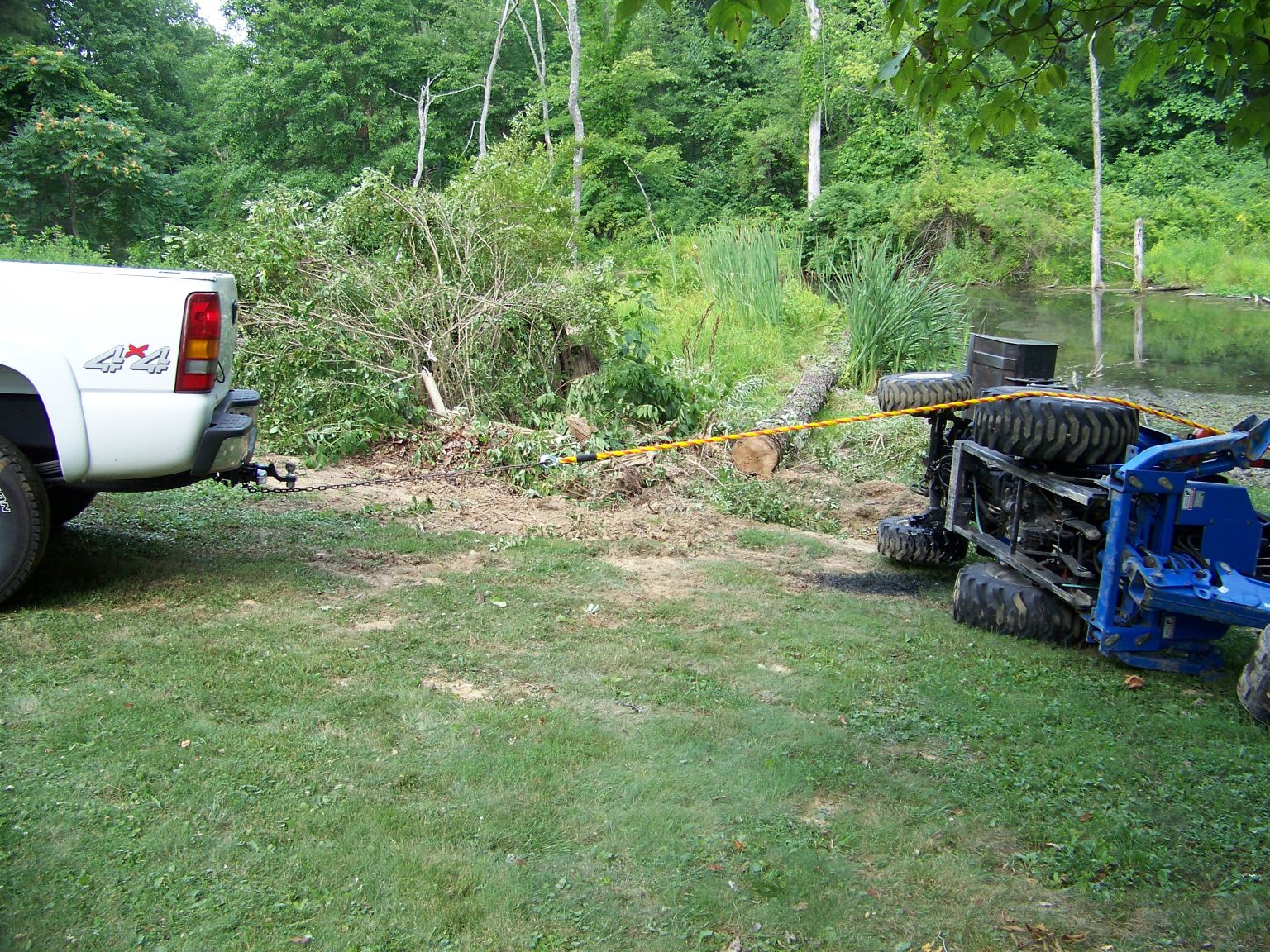

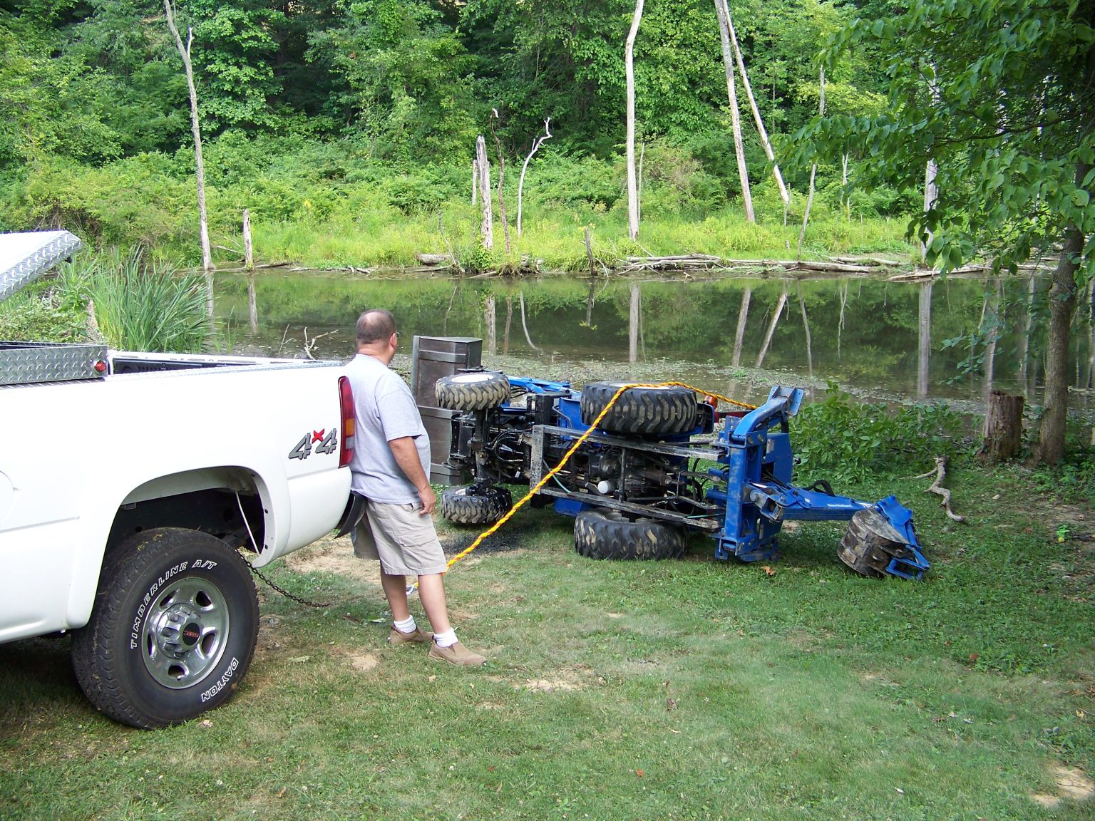

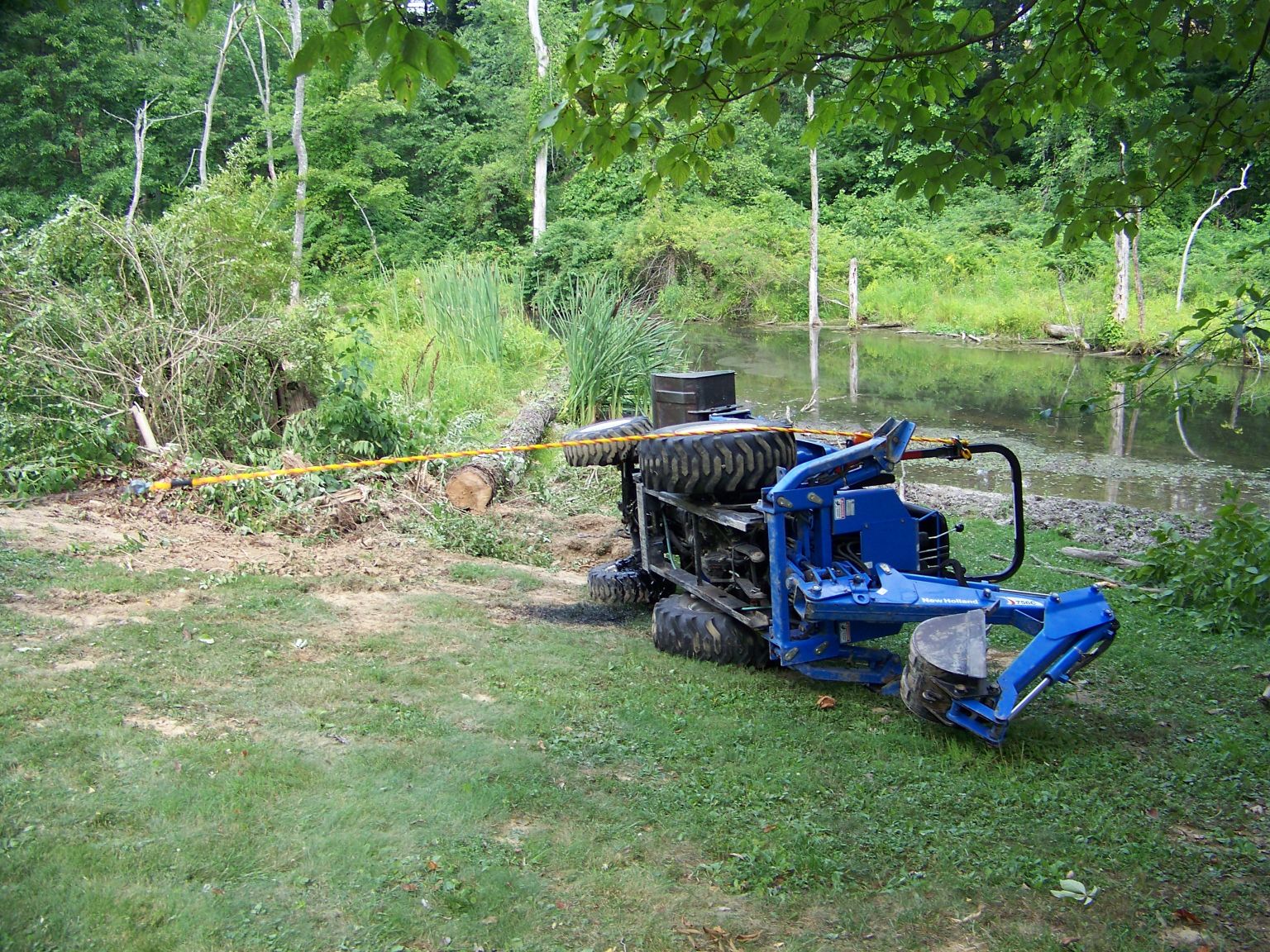

i dont think i would recommend pulling from the rops there will be alot of stress on the rops until the tractor reaches the balance point. i'm up in the air about the use of a strap like that, could a heavier chain than the one being used already been used. glad you are ok hope i never have to figure out where i'll need to pull from to tip my tractor over.

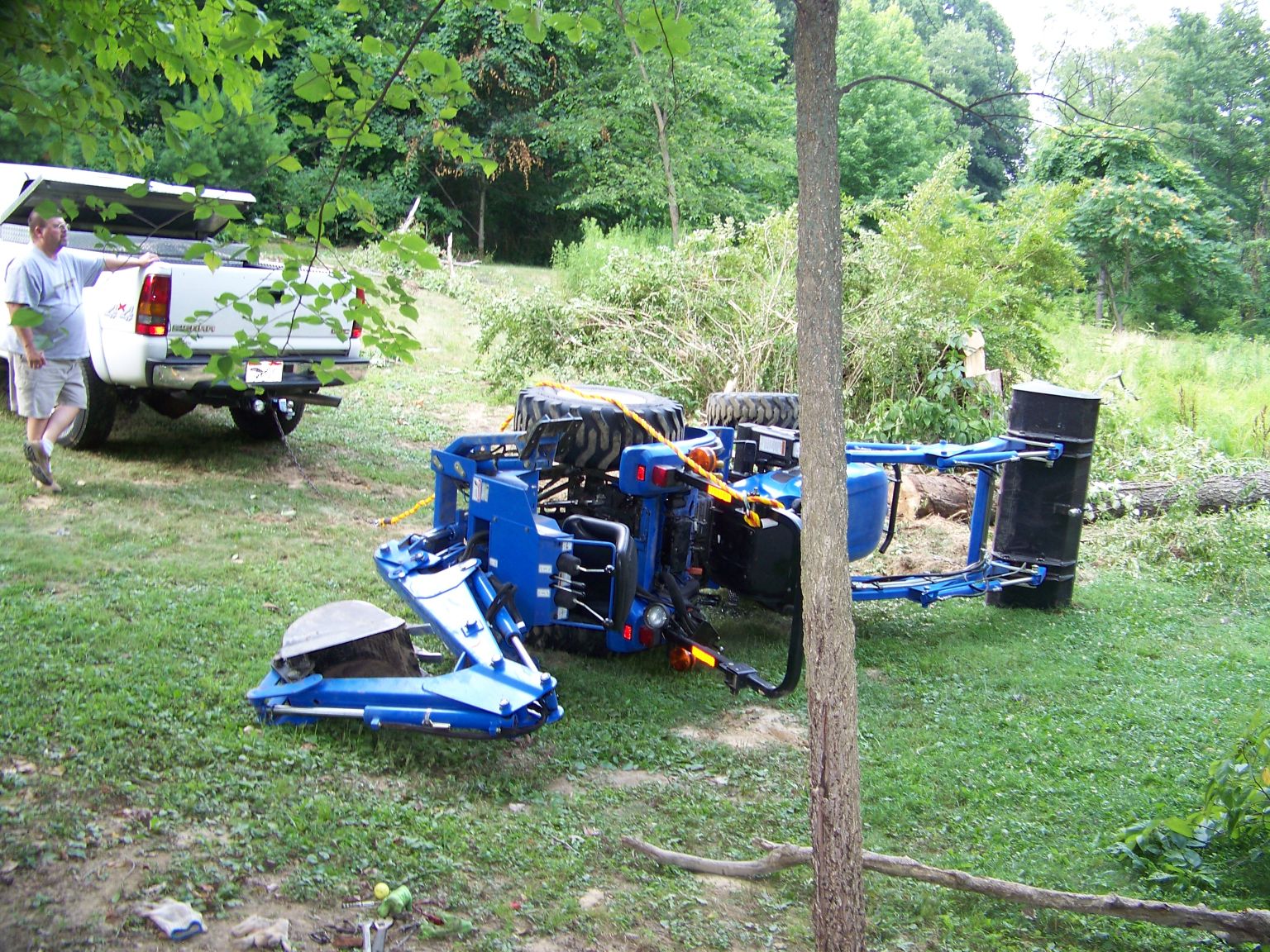

Ken45101: ....if you go back to the top of page 2 and read my description of the roll-over,...(which was my "guess", but Mega-Me confirmed it as accurate),..it should ease your mind a little,..hopefully.
This roll-over had nothing to do with the tractor's stability. As you will see, it was a "raised" bucket chained to the load it was pulling, when the tractor got onto a slight "angle" from the pull.
The angle of the load on the raised bucket,....caused the "lurching" load to "pull" the tractor "over"!
There are many lessons to be learned from this incident,....but in this case, the fault of the roll had nothing to do with the "stabilty" or "non-stability" of the particular tractor in question.
Remember to pull from your tow-bar and pull in a direct line from the load, and not an angle. Hope this eases your mind a little.

Yes, he's right! I will not do that again. I was trying to pull the end of the fallen log out of the water so THEN I could turn around and pull it the right way with either the truck or the tractor. Once I got the log loose I decided to keep pulling for whatever reason?
